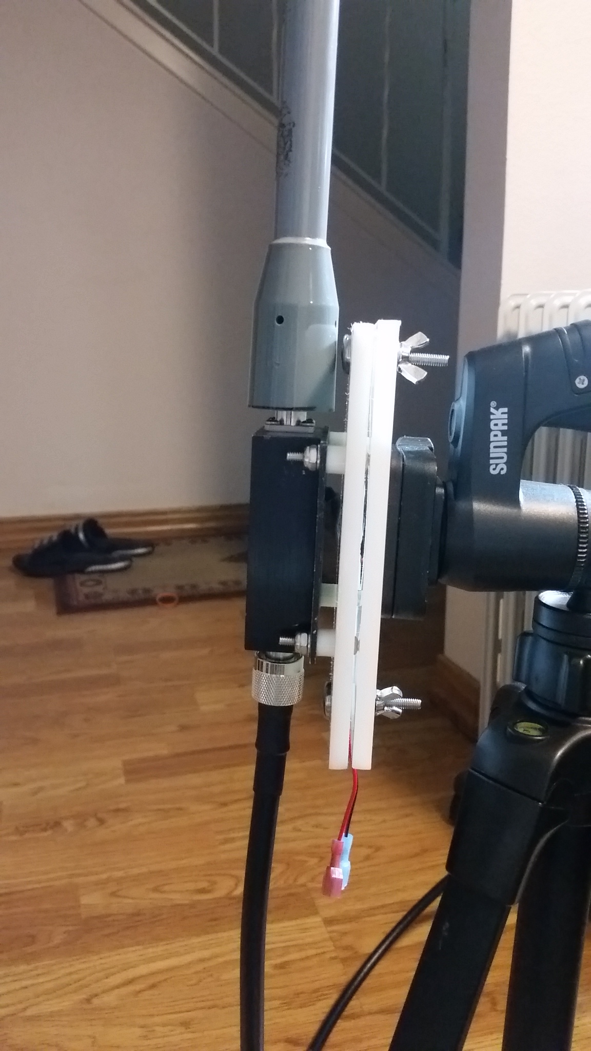

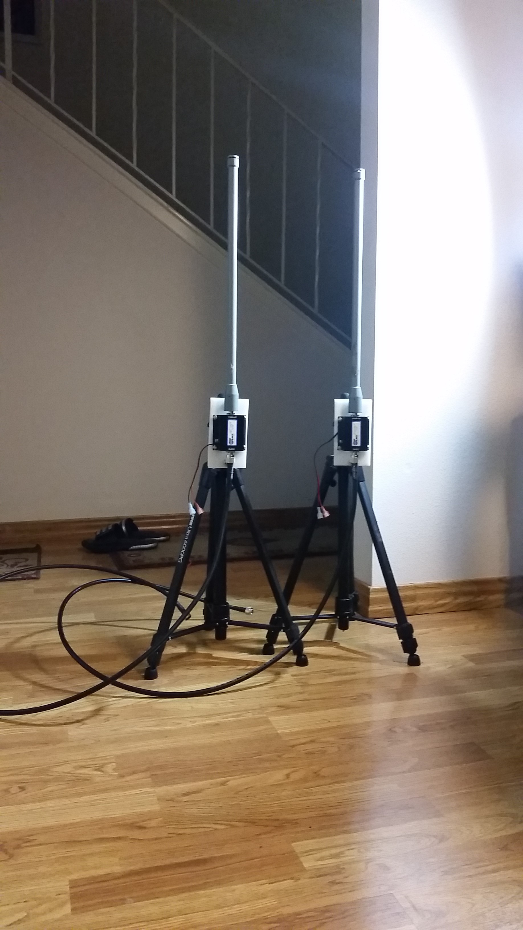

Update: Ran RF-Linx last night from car. Had engine off at first but it was cold. Started engine. Drone was out 9,000 ft @ 250ft. Was losing video feed due to "Stupid trees" and buildings. But the kicker is when drone was returning (Waypoint mission for test) I shut engine off to see if it was interfering. The video feed signal went full bars instantly. I'm going to see if that happens again. I was using 110v. inverter into cig lighter for amp power through a 12 v 4 A supply. I will just run amps through cig lighter directly and run car engine on/ff to see if the car's electronics are in fact causing the interference. I was fairly impressed with the amps performance using L-Coms 5ft. off ground mounted on tripods. I'm not going for extreme distance, I need solid video feed. I dipped the drone out at 550ft. to negative altitude. (Below ground level) and it was behind several metal truck trailers and several large trees... 90-95% video signal, 100% control signal. That impressed me. Sure is was not far out, but being under depth below me (Ground level blocking) and metal between me and it 100% was a good sign. I have the screen video, but need to decide how to show it to prove this.
Reactions: JohnnyB
Wow yah man I would say that's a good sign indeed! Sounds like a good future with that setup your running. I'm happy to hear you found "Hopfully" your interference Issue, it makes sense with the vehicle and all its electronics that it could affect the signal. And I'm glad you mentioned it because when I start testing from my vehicle ( which I havnt yet) I will try both with vehicle running and with vehicle off.. And tell you my results.
So what antenna were you using for this test? And what size boosters? J/q sounds like you got it all pretty much figured out. Would like to hear from you next time you try it if having your vehicle on, then off, gives you the same results or not as it did this time. That is def impressive tho none the less!
I was using L-Coms on tripods, RF-Linx 1 watt amps directly into antenna.20170117_195027.jpg 20170117_195902.jpg
