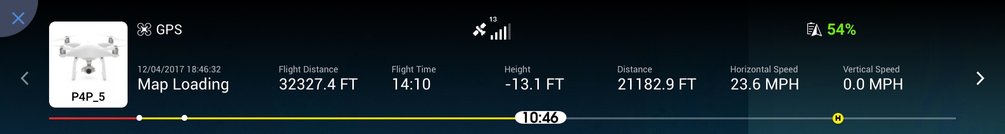

Then, hopefully, I have some credibility, when I say that the P4P, when set up properly, using Auto 5.8Ghz, does not need any range extender, unless you first add a battery mod, as the 4+ mile stock range already exceeds the battery capacity. The P4 absolutely needs a DBS-02 with boosters on 2.4Ghz. Flown over the exact same route, the P4P in Auto 5.8Ghz, with a $15 windsurfer, performs perfectly in its stock configuration. 4 miles away last night. :cool:

I strongly suspect this is a training issue. Not everyone is a veteran with our experience. ;) I never considered using Auto 5.8 GHz, and was getting terrible range using 2.4 GHz with the 32 Channel Hack set on manual on Channels 30-33, which are what I have used successfully out to 6 miles with my P4 with the boosted DBS-02 antenna over the last year in the same area. My stock P4P results on 2.4Ghz were consistent with my terrible stock P4 results, so I gave up, and waited for a new P4P range extender. Then, some random new guy on the forum claimed he was getting over 4 miles stock on the P4P. I challenged his "outrageous" claims, and eventually got him to share his settings to see if I could replicate his range using those same settings. Low and behold, he was right, and made a believer out of me. I initially thought it might be a fluke on a few aircraft. However, the same setup works on all six different P4P aircraft I have owned! First try Auto 5.8Ghz with a $15 windsurfer. If that doesn't work, then consider a range booster, but a range booster will likely only replicate the Auto 5.8Ghz range on the 2.4Ghz band, and supposedly the 32 Channel hack has been disabled on newer firmware, but still works on mine. All my results are based upon clear LOS. If you can't get good Auto 5.8Ghz results, with a windsurfer, with the P4P, you likely have LOS issues that even a range extender won't help with. Get up higher, and out from behind any LOS obstructions for the best range. YMMV. :cool:
