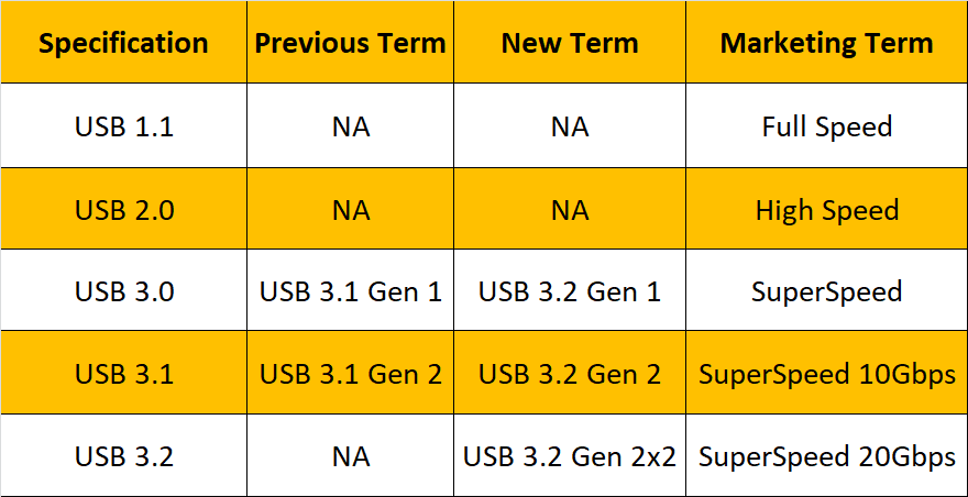

Try purchasing a short USB 3.2 Gen 2 (SuperSpeed) cable.

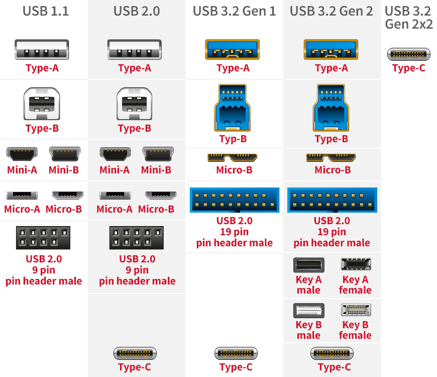

Just looked up the USB 3.2 Gen 2 cable. That’s a USBc cable. Are there cables with that speed that are standard USB-A to Apple Lightning plugs? Not sure there are…
