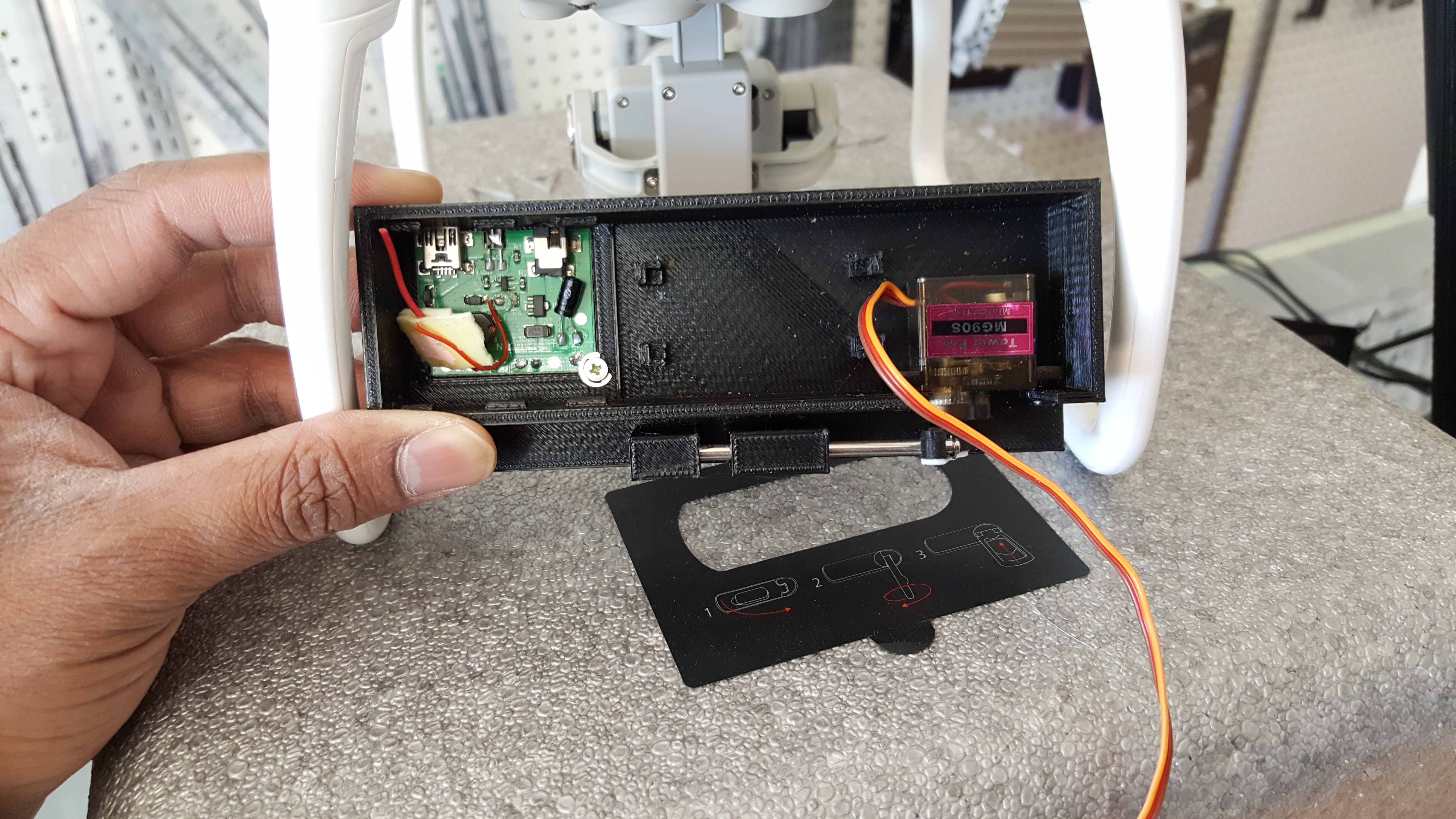

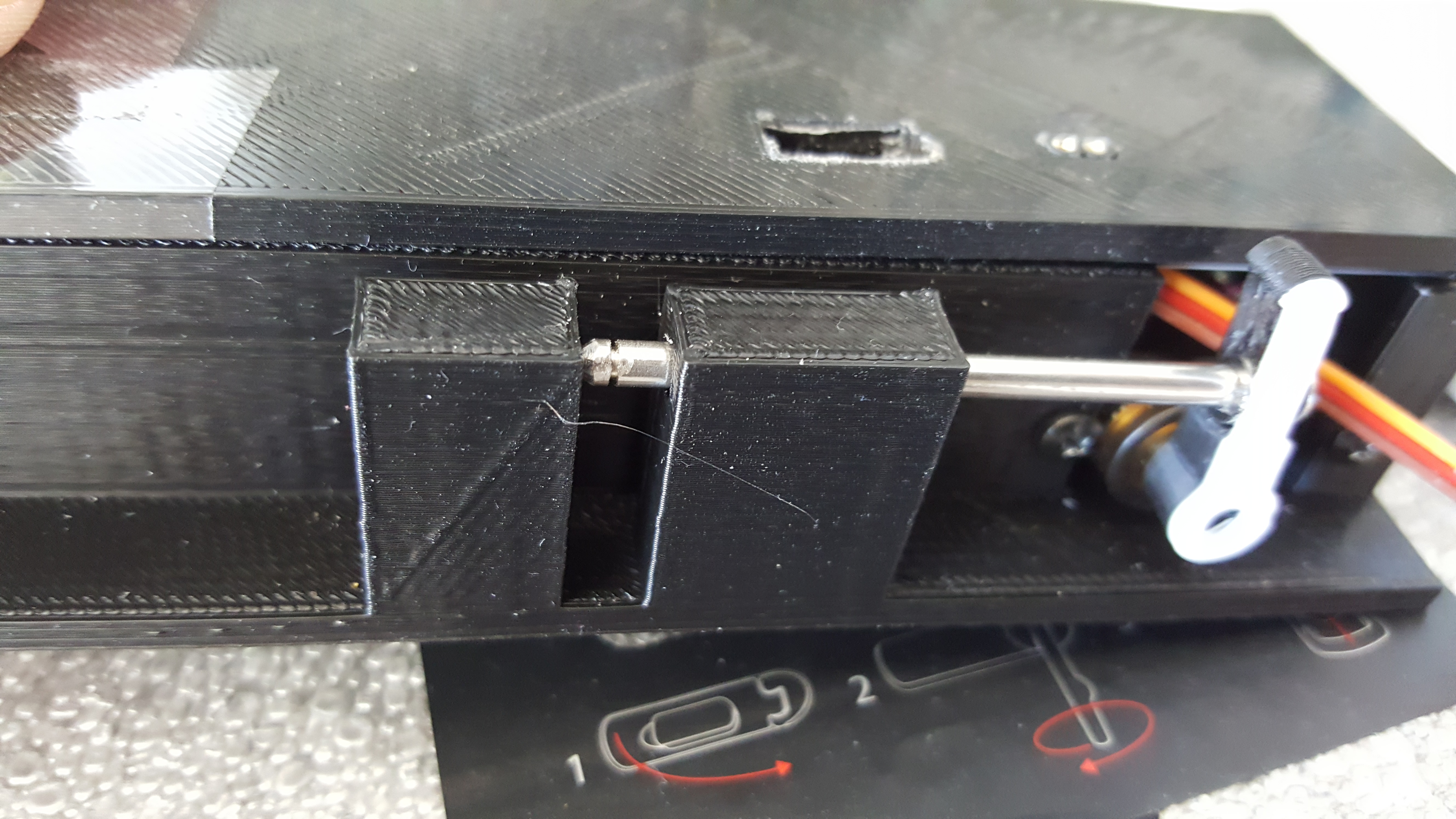

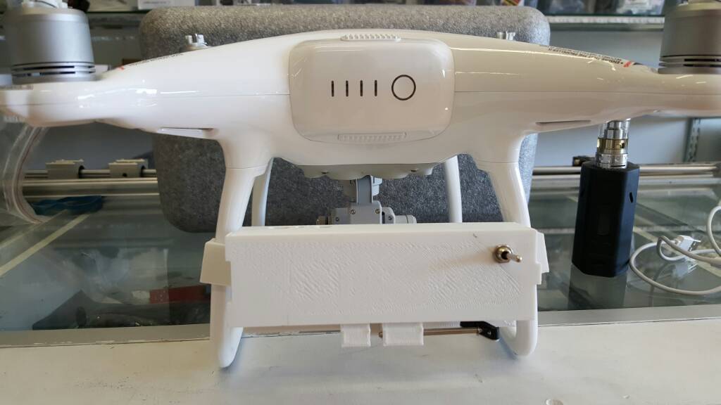

Below is what I Designed, In the video what I'm holding is the sensor, When I uncover the sensor and release you can see how it move the servo, Technically you will need to stick this sensor on the Front LED and it will work how I demonstrate in the video, Mean when you turn the LED on Payload will be armed
View attachment 55165 View attachment 55166View attachment 55170
I Designed the Bracket and in process designing the holder
I had to redesign the entire box since i change from Micro servo to Mini servo, Since the Micro servo get jammed if you load anything more than 100grams, However the Box length is 140mm since the component inside
I programmed a Circuit Board to do the job
I used 3.7V battery and programmed another circuit board to supply sufficient power to the servo and regulate it
Component I used, Servo, 2 Circuit Board & 3.7V 1200Mah Battery
Much cheaper this way but the only thing cost me much is to 3d print the box since I don't own a 3d printer and the shop where I'm printing kinda cutting my throat
I'm actually making one for fishing, I had many ideas like using cloth pegs etc but I'm kinda like something nice, Once complete I can make one if anyone wants it, It takes 10 minutes to program the circuit board, 15 minutes to assemble and 6 hours of 3d printing, Keep an eye on my WIP thread
