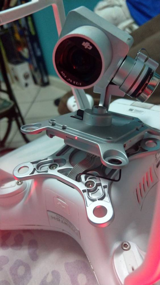

This is basically a new camera...before it was doing the dance and when I connected to the phone I wasn't seeing anything on the screen...I replaced the cable now it's not working at allDid it have accident ?how come rubbers not there,?does it have sd card in,got any picture,,check all plugs are in nice,,ha is that you asleep,can you conect to the app ok,,what happens on start up,,does your camera do the dance,when it mounted properly
Yes as 2 above say was it a genuine part,some ribbons to cheap and just won't work,it won't become a new camera by changing ribbon cable,there more to it ,or did you change whole cam,did you get a ribbon cable set or just a flat ribbon cable,depending on what happen it could be the gimble main board,you say no picture , did that just disapear or get worse over time or silly crash damage (had to ask) was other ribbon cable damaged in any way ,I would put it back and see if gimble dances again,if it does order a proper ribbon set,yes pretty delicate these ,if of picture loss for no reason always start with a reinstall of the app,then you know to look elsewhere if that not make it rightThis is basically a new camera...before it was doing the dance and when I connected to the phone I wasn't seeing anything on the screen...I replaced the cable now it's not working at all
