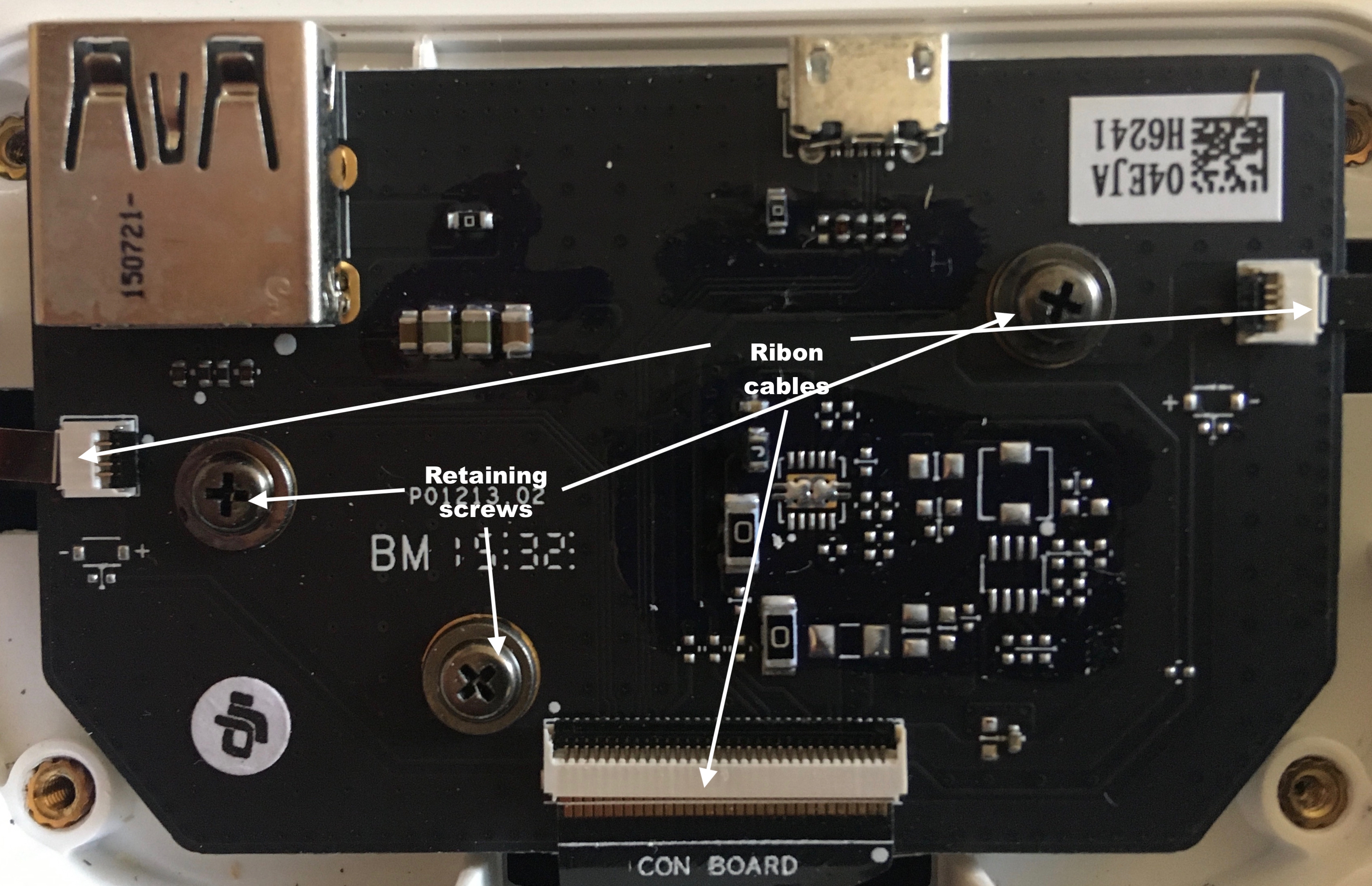

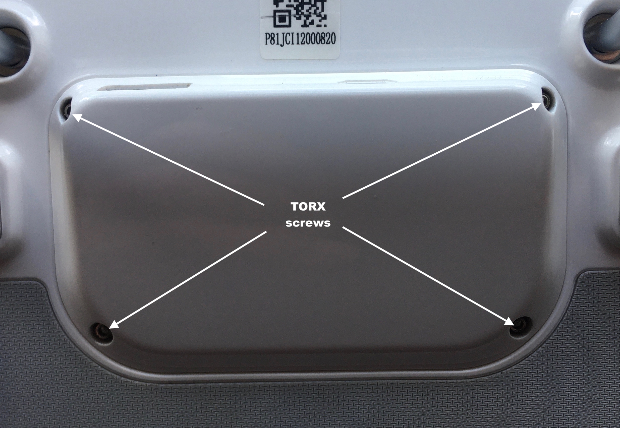

Then I would suggest the USB port has possibly got a (fairly common) loose connection, dry joint.
Quite easy to check, remove the four small T6 Torx screws and check the four soldered connectors coming off the USB port. Re solder just to be sure.
Once you have the cover off, carefully disconnect the three ribbon cables, one large one and two small ones, then undo the Philips retaining screws and the PCB will come off. Check the soldering of the USB onto the PCB for any signs of cracking - re solder anyway just in case!
Thank you, I'll take it into work today and get it apart and see how it looks. I noticed there are both standard and micro usb ports on the back here, do both ports do the same thing? I.e., if one failed could you use a different cable and use the other?

I swapped the small usb control boards from the backside of the remotes to see if that was the issue, it was not, it did not change anything.
Any clues as to what I might try to get this remote working? Can it be hooked to a computer to see what is going on with it?
