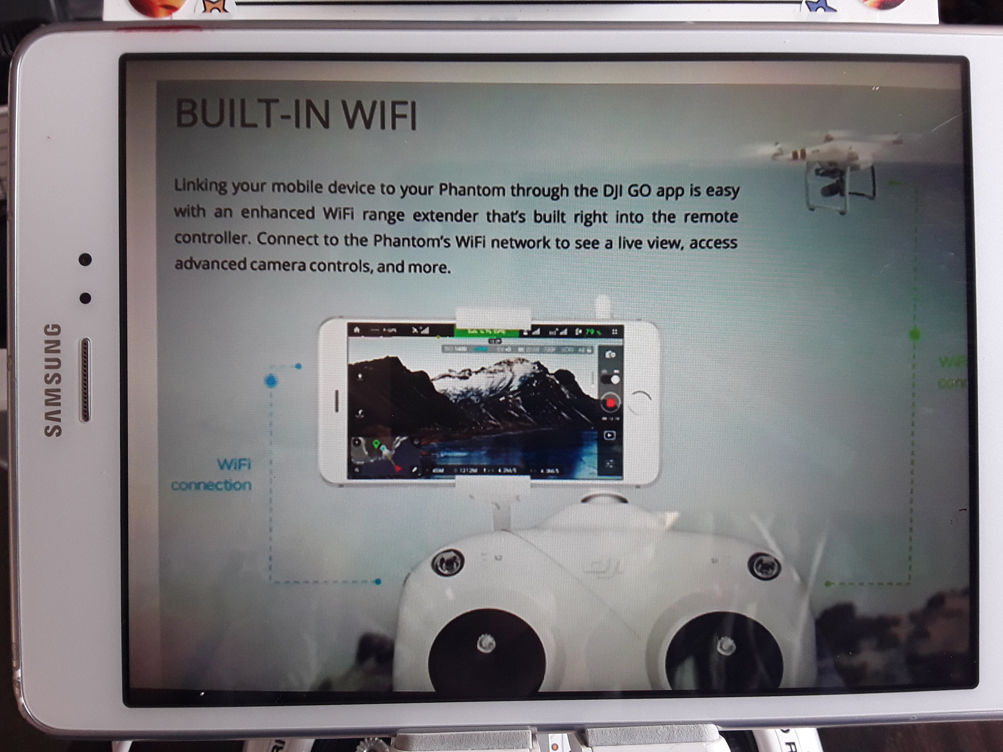

Phatom has wifi extender built into remote which talks to drone and app,,sure that right,,thats how you can be nowhere and fly with screen view,,,,,(creates its own wifi) ???

sorry what I am looking at here? The wifi extender? You can get wifi extender for home wifi too but you sure don't internet at your friends house down the block
This was just a pic showing how drone wifi work,
