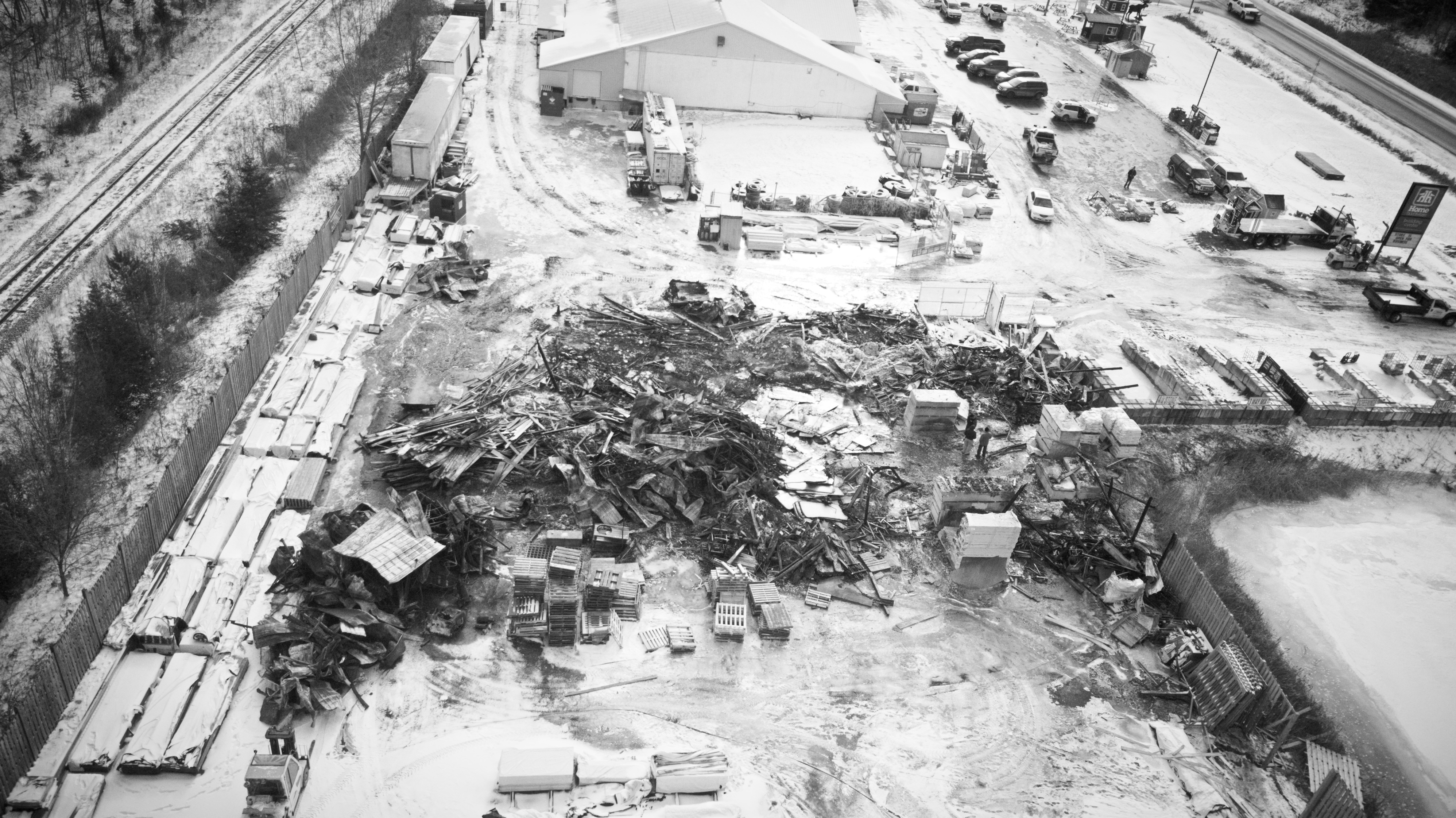

Temp- -24 celcuis with wind chill -34 degrees, cold didn't stop this 140' x 60' building, burning to the ground, bright sun/snow. Ireally need to invest in some filters!
I had some focus issues, attribute this to numb fingers.
I had some focus issues, attribute this to numb fingers.View attachment 93646
Royster, not to hijack the thread, but I bought the DJI filters(ND4, 8 and 16), what a difference they make when flying in bright conditions. Well worth the $'s.
