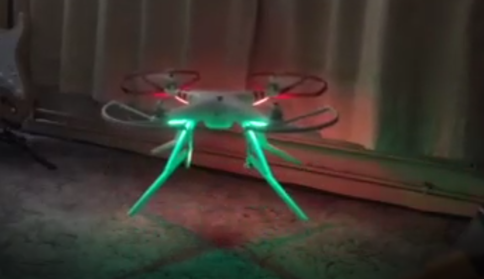

First off, when i received the drone i didn't even know if it worked so here's a pic from a video (i can't post a MP4 video) of me testing the motors and such for the first time ever, note the home made undercarriage. (I know it's not advisable to fly a drone indoors, this was only to see if the thing worked.) I also want to show you that it did work.

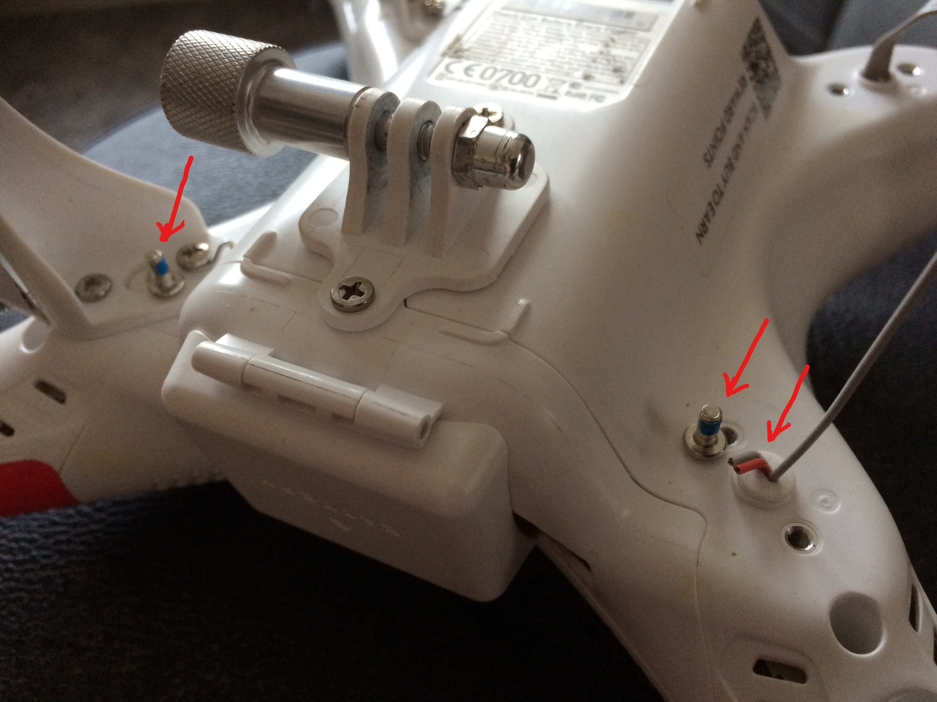

Next pic is of two bolts sticking out the underneath of the drone that fitted the made up camera frame which i've thrown away now. Also notice the wires on the right that's sticking out

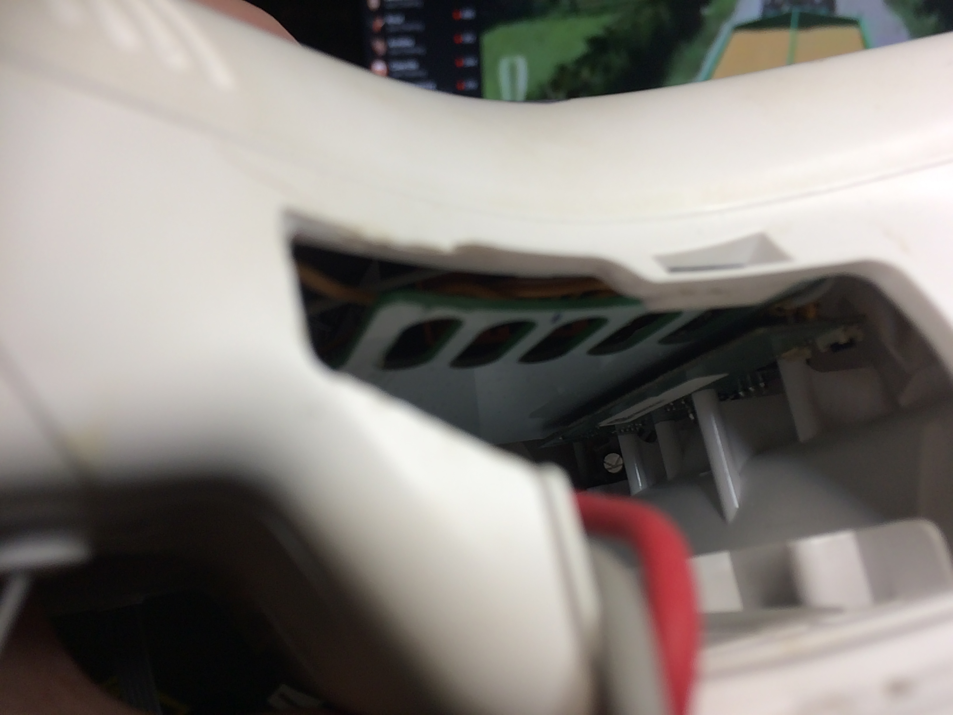

Next pic shows a modification to the battery conpartment

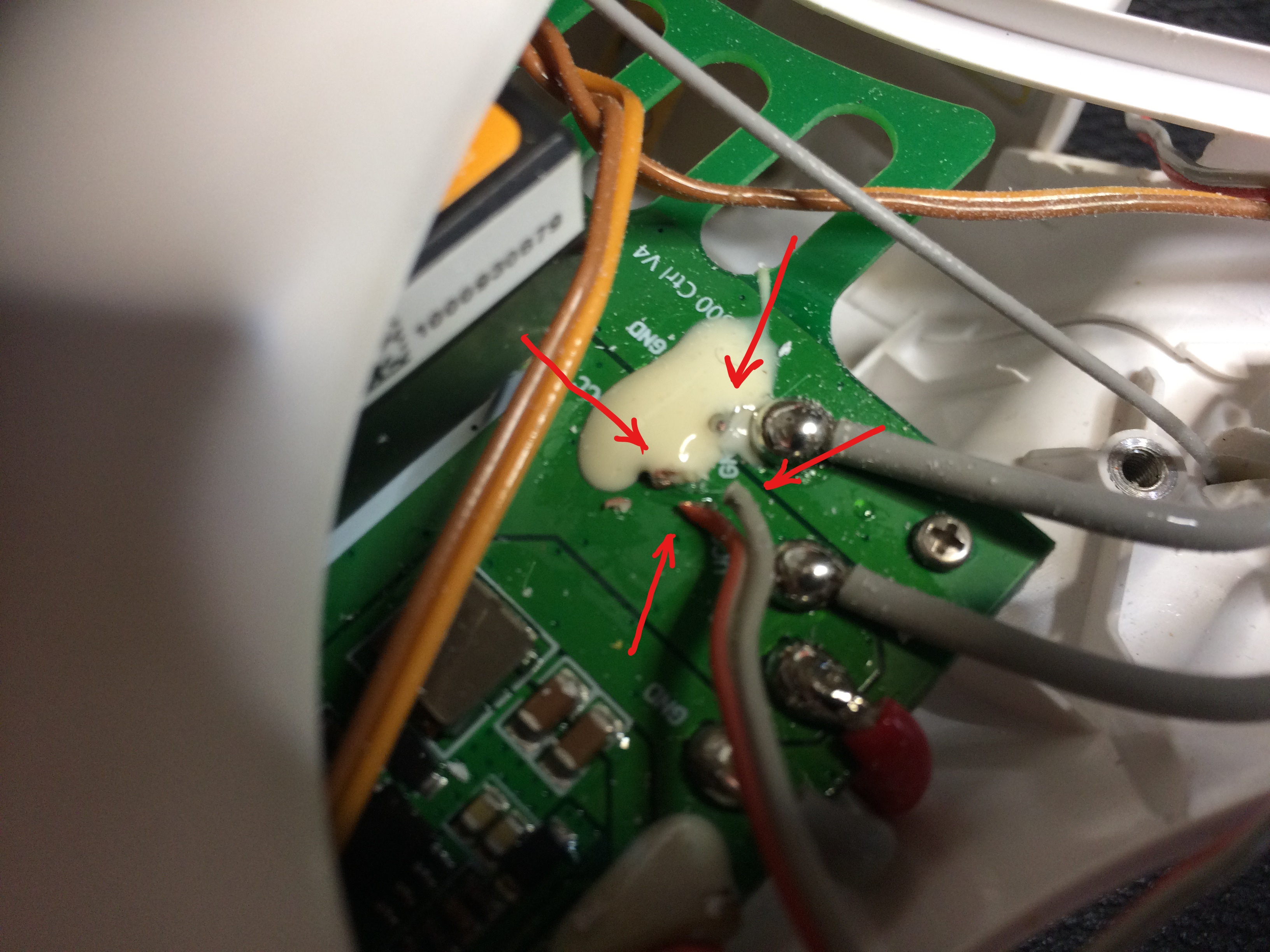

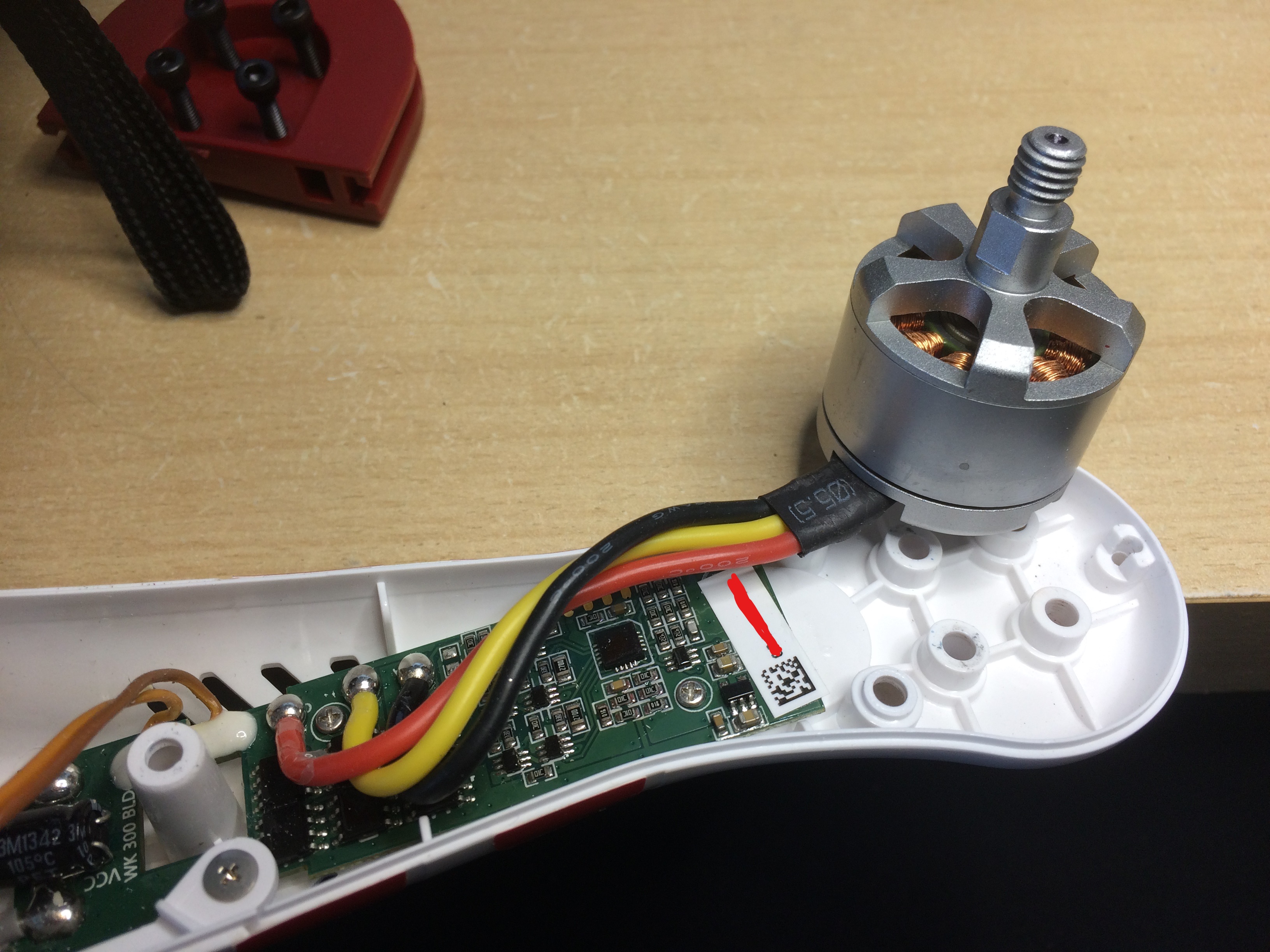

The next pic shows the wires i mentioned that i thought was added by my uncle so i cut the wires off, i've now realised it's an original auxiliary wire so would this make a difference to the compass or any other operations to the drone. Also what is the white stuff surrounding the area of the cut off wires and does it have a melting point??

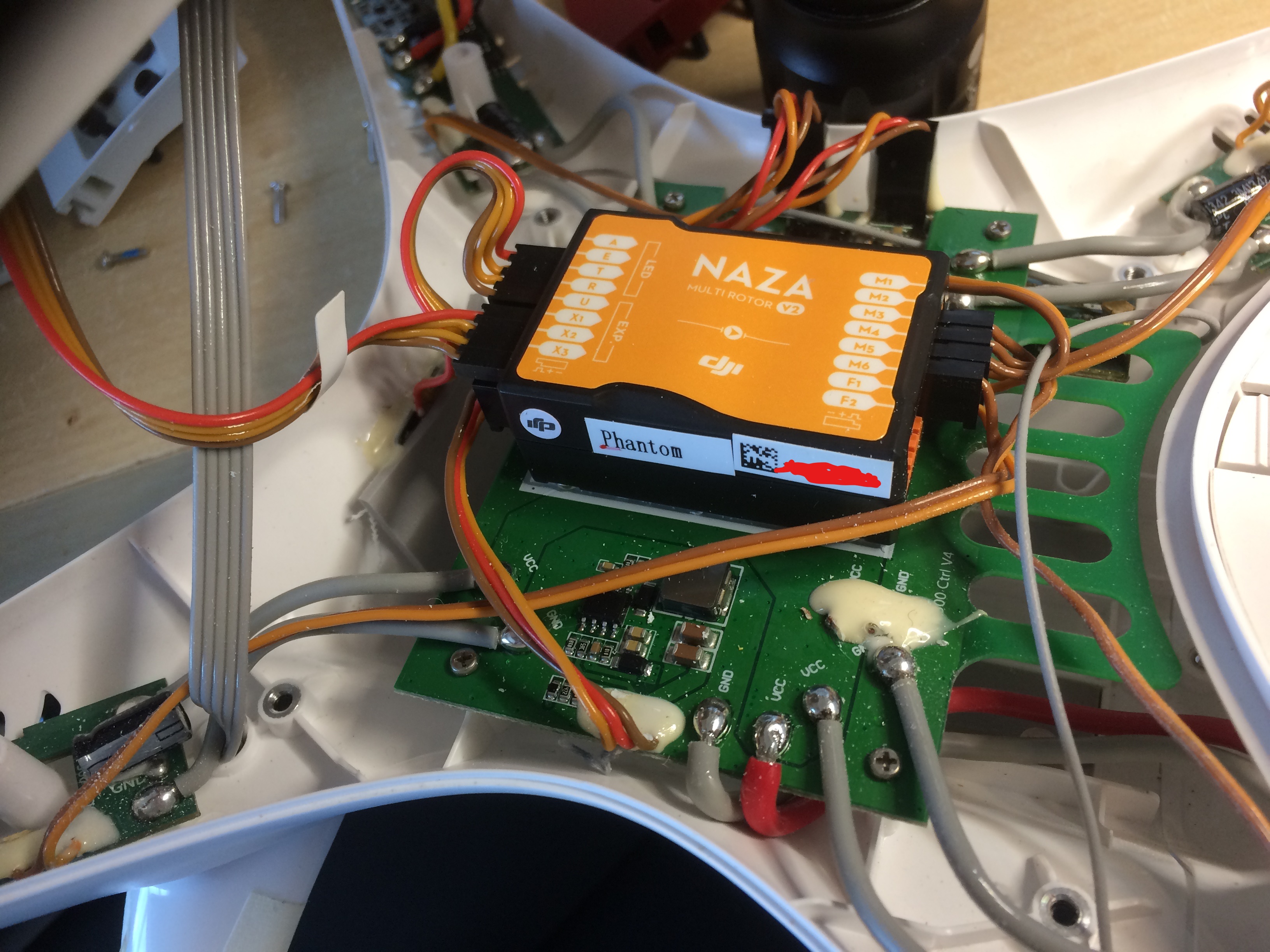

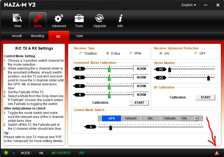

Next pic i'm wondering if the Naza has been upgraded from the original plus can you tell from the pic if i have to use the Naza M2 D-Bus setting for the controller, it's the only setting that i can get any controller movement from in the Naza M2 software?

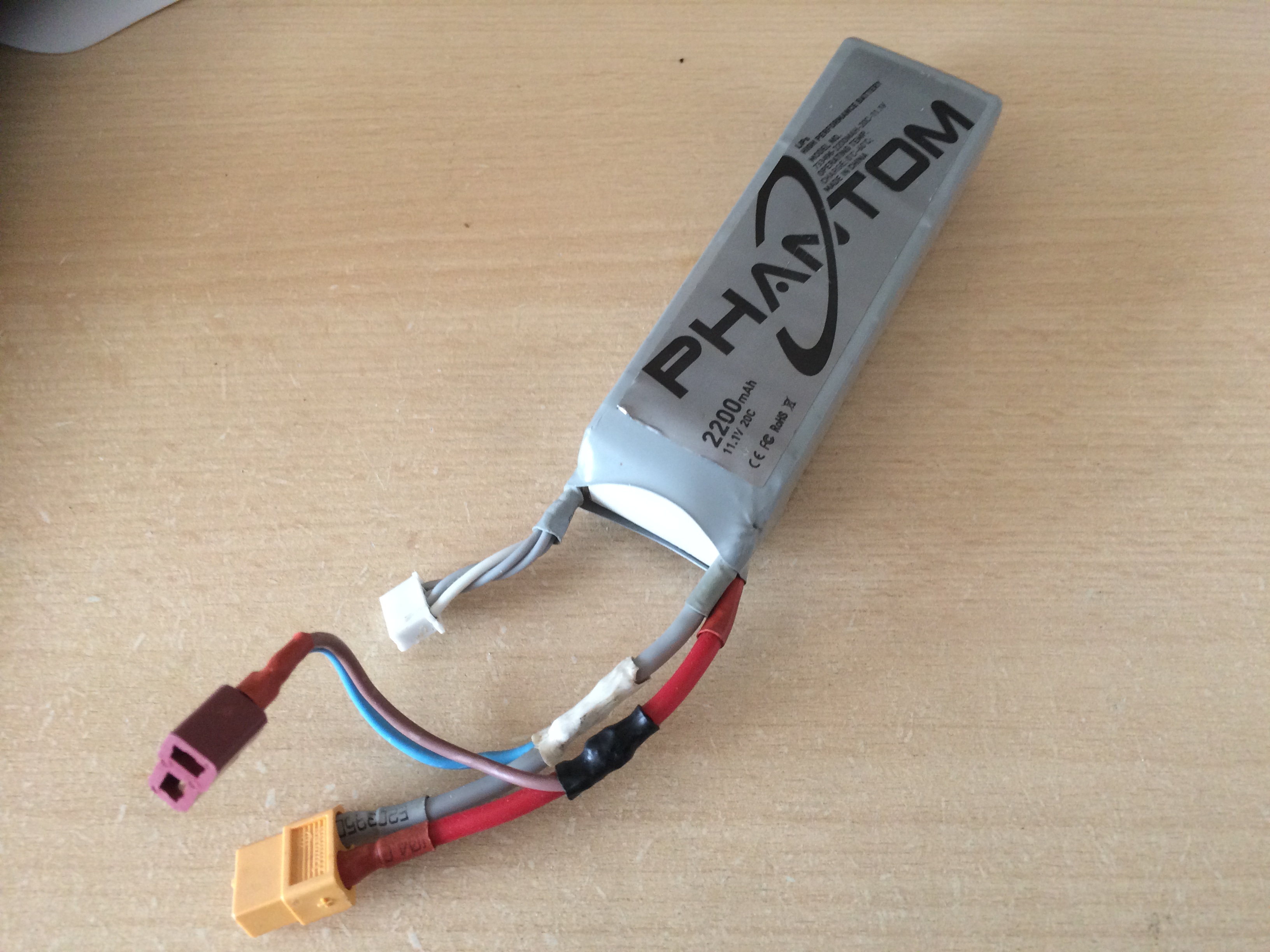

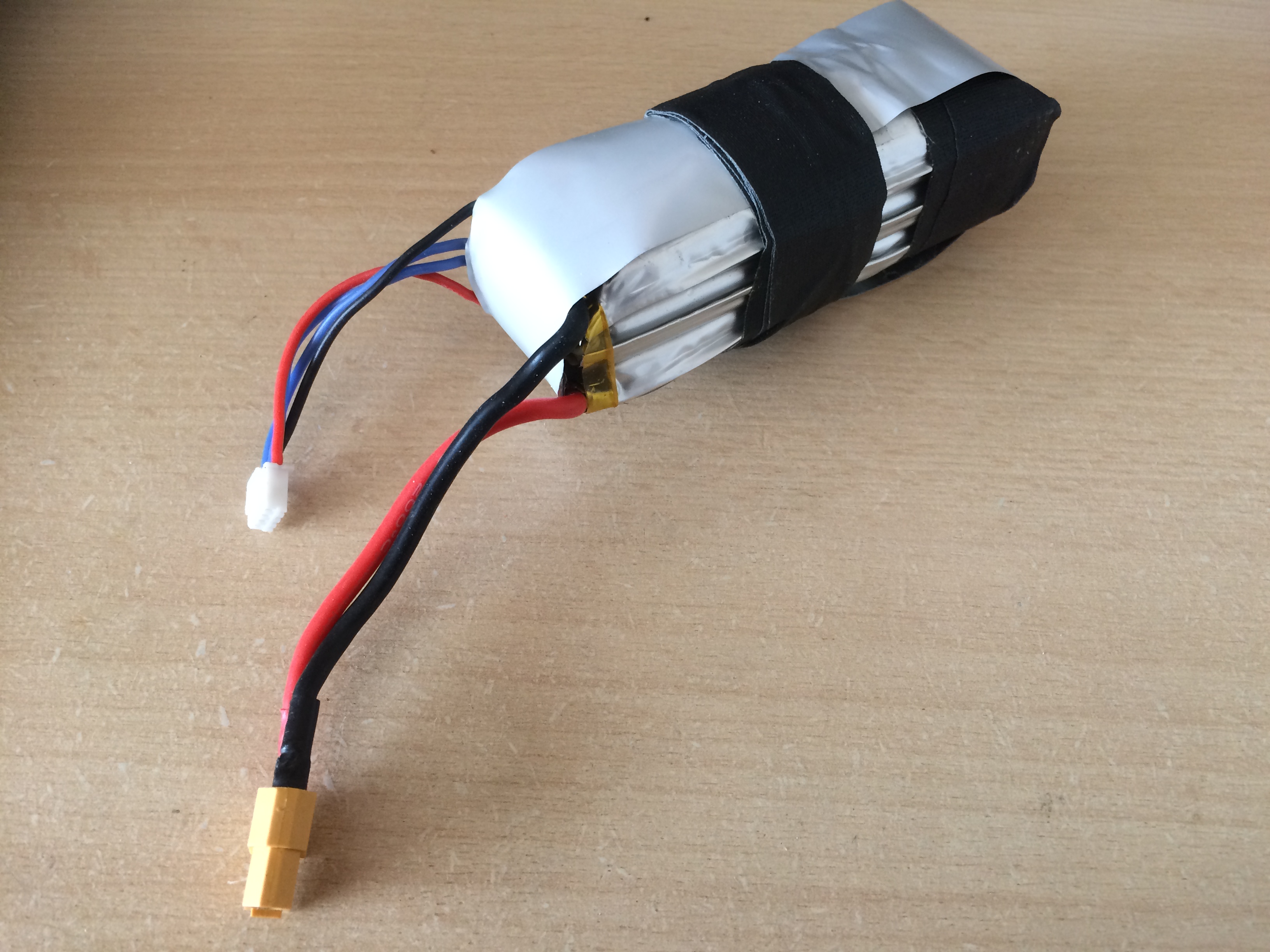

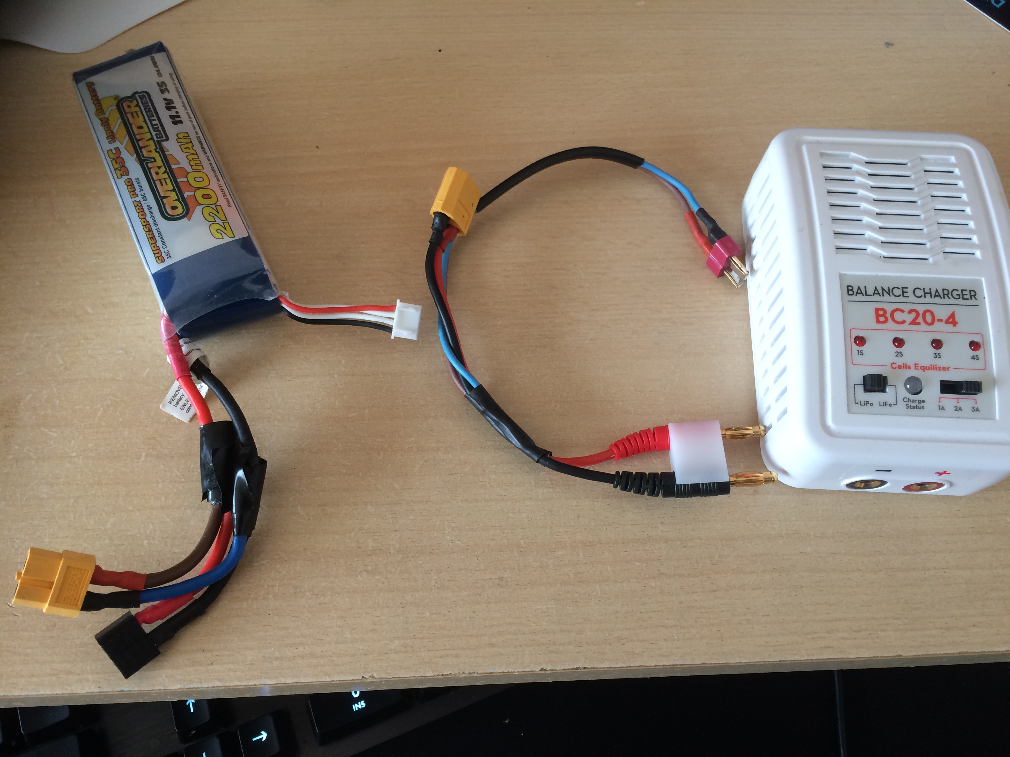

Next few pic, what has my uncle done to these batteries, they seem to charge ok and the voltages are correct for each battery?
Final pic, what does the flashing bottom right red yellow triangle mean?

The white stuff is hot glue and yes it will melt. Don't know anything about that drone but it looks pretty cool. Hope you get it in the air, good luck.
Thank you Capt KO, i think i might get away without the wires i cut off. I've managed to force the compass to callibrate and all seems good now, i followed this video
to the letter apart from the PPM setting, i only seem to get any controller movement with the D-Bus setting. Someone Private messaged me and cleared up some other questions i had so all i need now is for my country's lockdown to ease then i can give my drone its first flight with me.
Reactions: Capt KO
Just found this thread seeing how u made out it looks like the wires next to the leg were for a gimble and the white glue wont melt it's from the factory I use to own a fc40 when they came out its 5.8ghz not 2.4 because of the camera that came with it. Hope flying went well with it.
