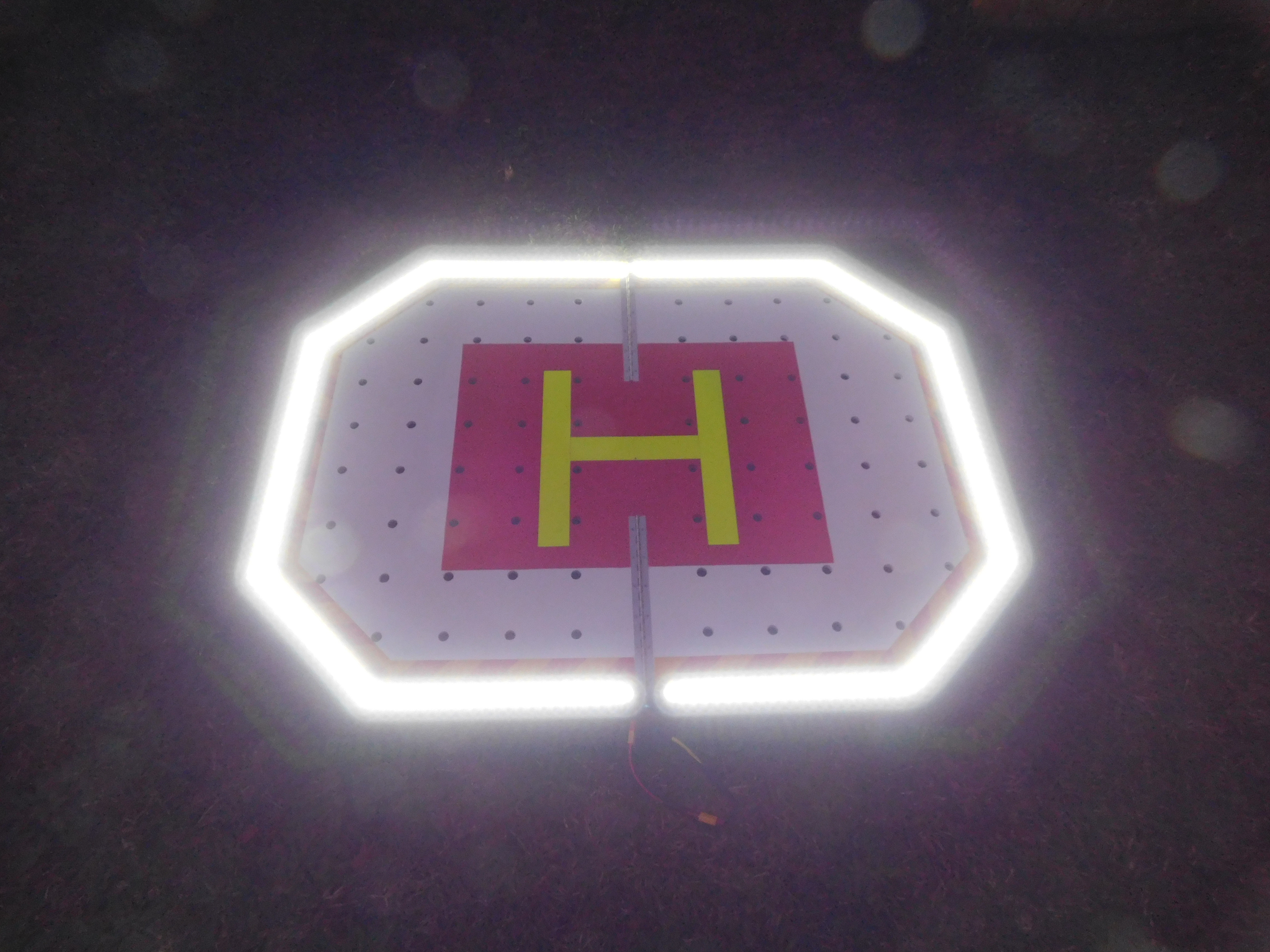

Ok I got my lights on the landing pad functional. I ended up adding two 12" white LED strips to the sides. The infrared illuminator is bright and shows up well on the Phantom 3's camera. As you can see from the pictures, the white LED strips (they appear blue for some reason) overwhelm the infrared and you can barely see it.
However, the infrared LED can be turned on by itself so you can practice landing in total darkness! Or if you're doing covert ops, you can more easily avoid detection. ;)
Right now it is using a 12v AC power supply and extension cord, but I'll eventually get a battery figured out. I'm thinking a portable USB battery and a 5v to 12v up converter.
I'm very happy with the result and think a landing pad is a great project anyone can do.
Great job!!

Hey Low_Budget thats great it works for you and you can perfect your night landings.
Have you thought of a power converter run from your car battery that way you can run a lead
to the helipad and operate any ware. (convert car battery from 12 v dc to mains power and
back to 12 v from your adapter a thought).
Cheers, Satellite View

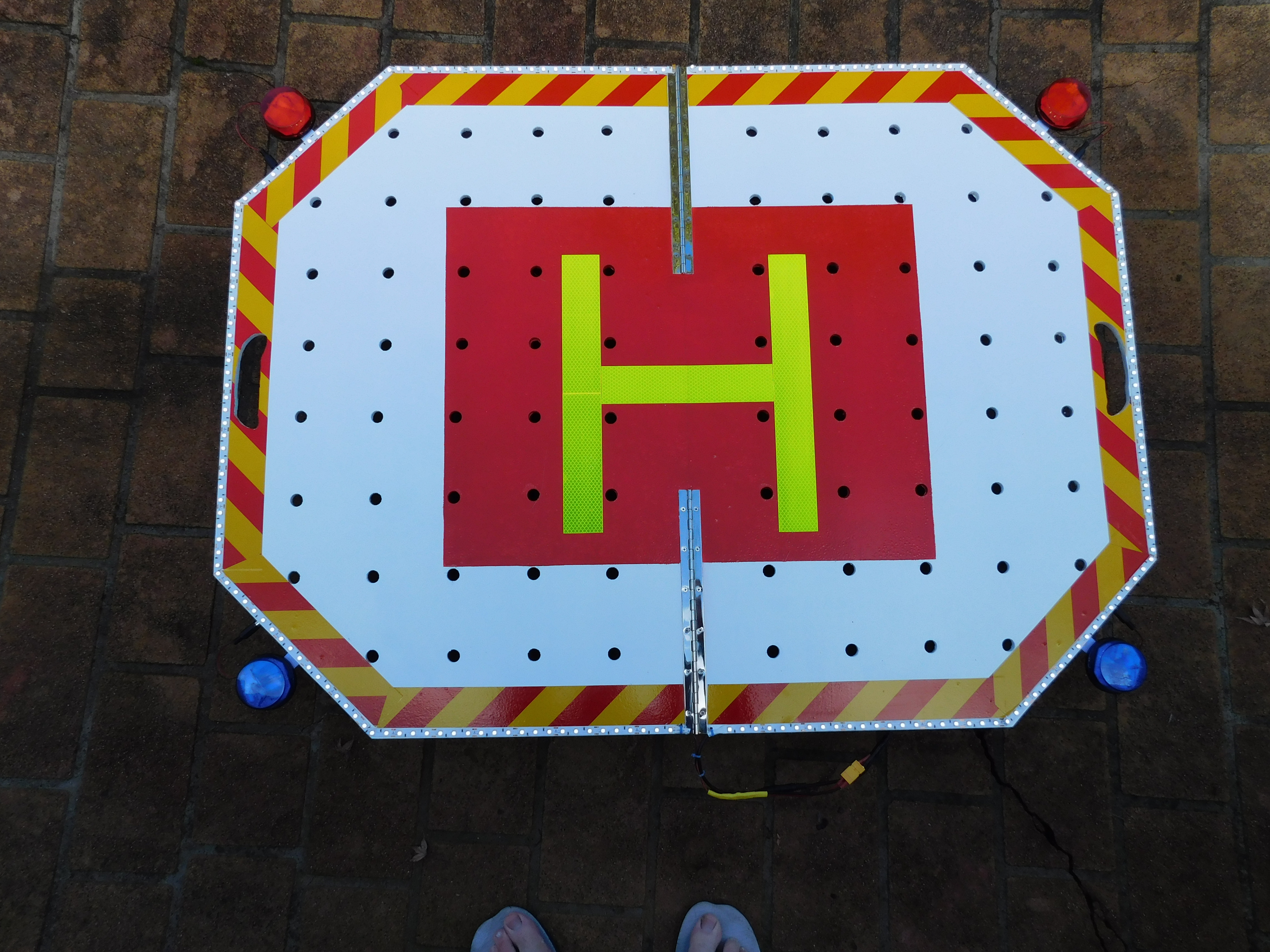

Hi All, I have also made a Helipad designed for night landing practice, it has some unique features as follows,
1) it has LED's all round and can be controlled with a dimmer
2) it has Blue and Red strobe lights on each corner
3) importantly it is raised off the ground about 5 inches and has holes in the platform which allows the down wash
from the props to flow through and away underneath giving an incredibly smooth landing every time.
4) the power for this is 2 x 11.1v lipo batteries one for the LED's and one for the strobes and are held with Velcro
underneath and provide about 5 hours of power.
5) the helipad folds up for easy transport and the square 5 inch legs slide off.
6) it is about 1.2 meters square so a good size for any aircraft including helicopters.
Photos attached.
regards, all John
View attachment 39267 View attachment 39268
Very nice.
