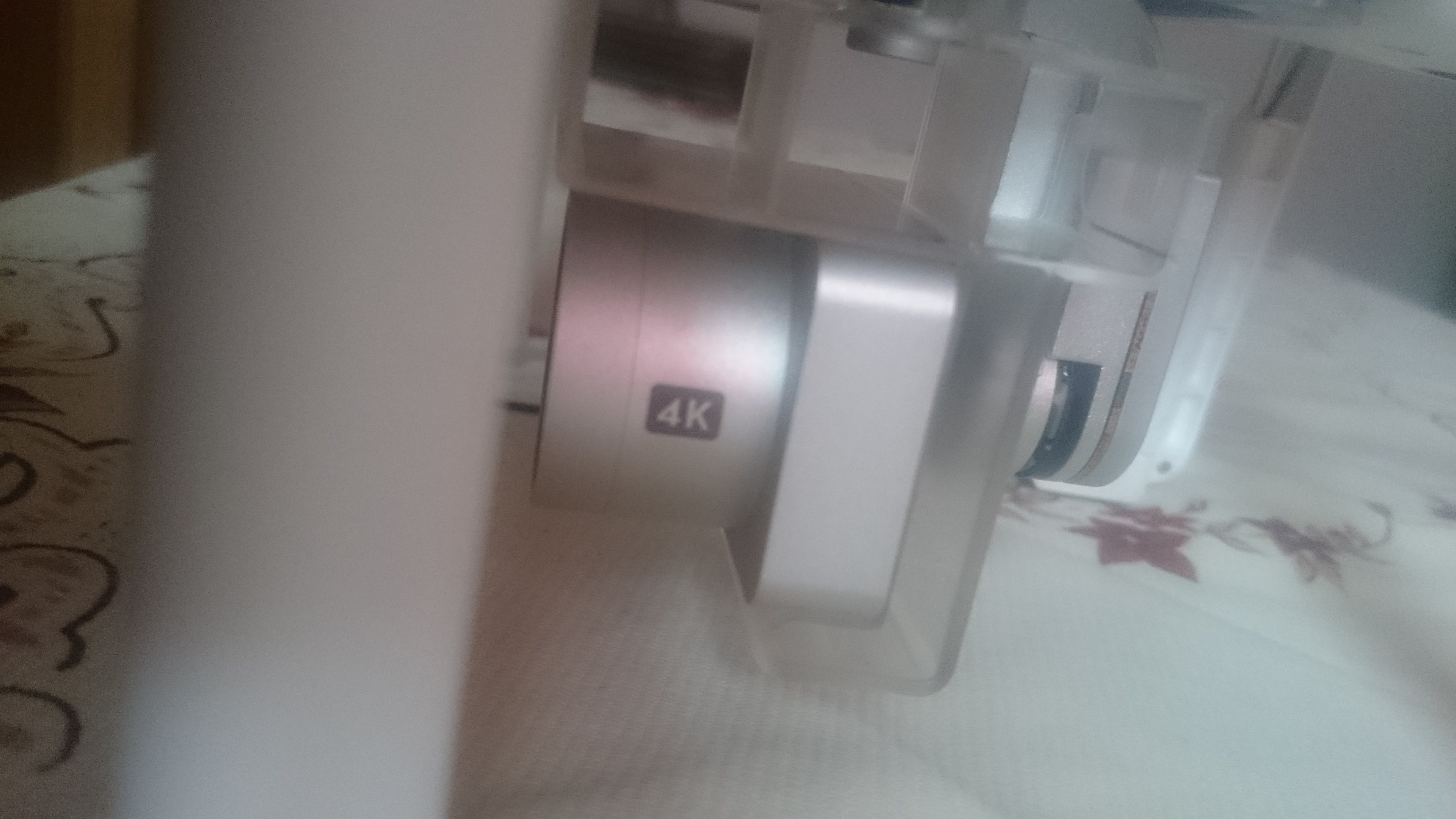

So, i buy Phantom 3 Pro 4K but in options there not resolution of 4K, means i cant record video in 4k there only resolution of 720p, 1080p, 2,7k
can somebady tell me what is the problem.. but my camera is 4K, i can take picture to show u..

when i open dji go, app show me that my drone is professional, after 3 sec this change and write advanced ..

why app show me that my drone is advanced?? i have pro , and i have 4k camera..
