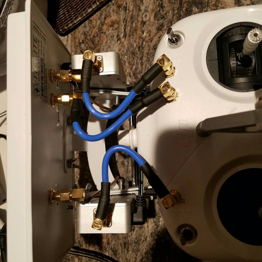

    I actually ended up buying the DBS as well as the three Sunhans Silver amps. Love the setup! The range is phenomenal and I am quite pleased with the results. Have been running this setup since July. I can easily to 1-2 mile out and my record was four miles away with safe return at about 20% battery. I really just turned around because of the battery and wind that day, I could have gone further with this setup. This flight was also in suburbia with quite a few wifi and power lines around.

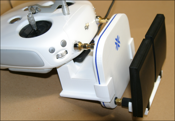

    There is a mod to build a voltmeter to plug into charging port of blue batteries. I have parts ordered now will post a pik when done. I took out top bolt and nuts of Maxx antenna bracket and drilled out holes to use a bolt and wing nut to hold amps. Clean and sturdy but I only run 1 2.4 and 1 5.8. Battery 3m velcro to back of tx. Thanks you guys for ideas. 1488785466421.jpg

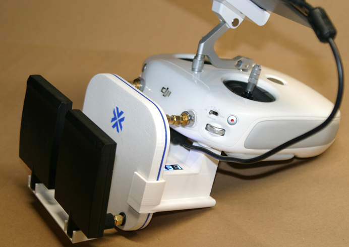

    Mine are in the same location. I just went with velcro and one fat rubber band as a back up to apply a constant pressure.
