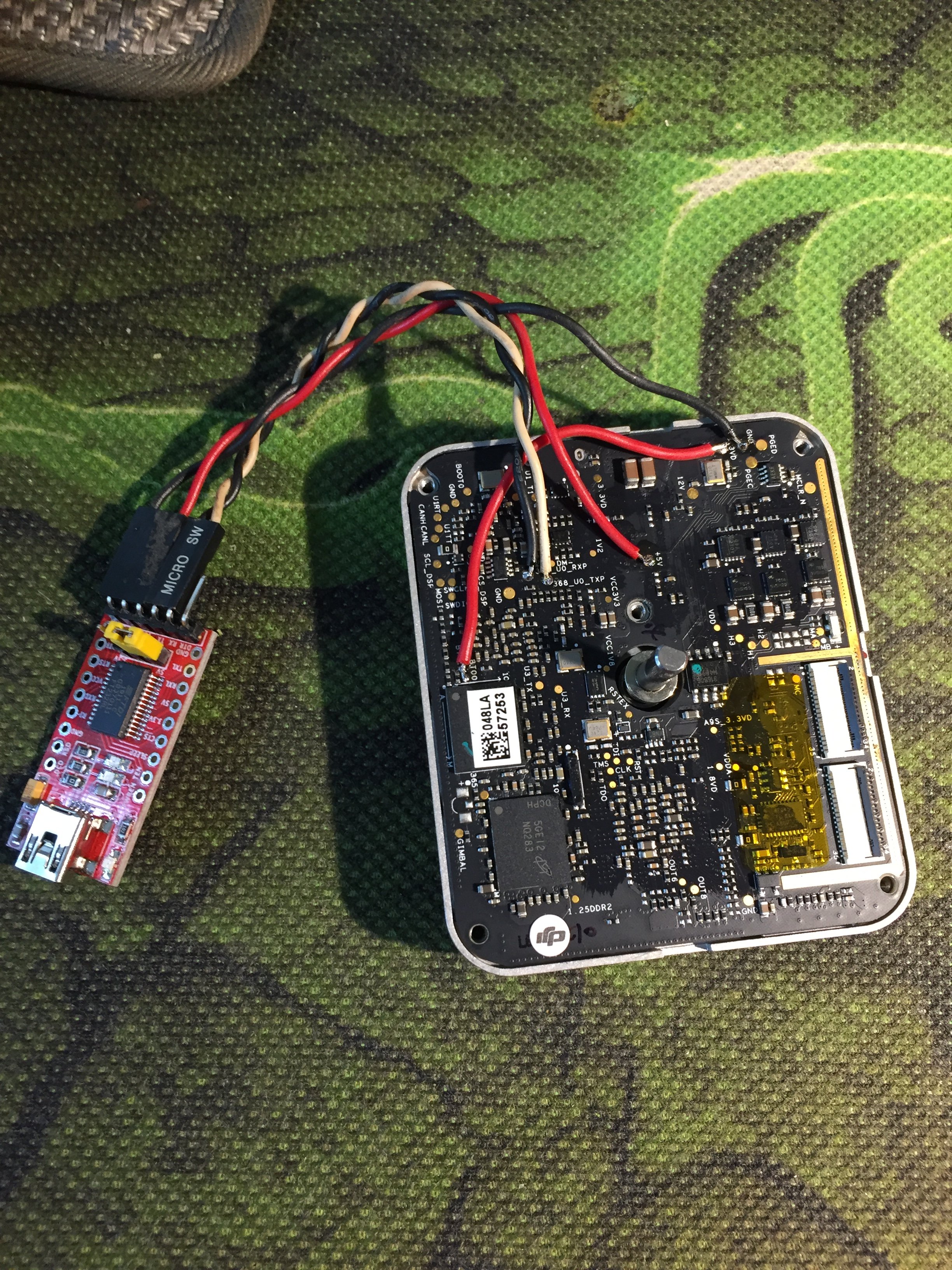

Thanks for your sharing, I was about to flash My P3P cam and this is so simple! Succes! It work! I've tried so many things and nand flash was the solution for me! Thanks a lot! Ps. Drivers was not working on my Win 10 for the ttl232 but I install it manualy and it work good.
