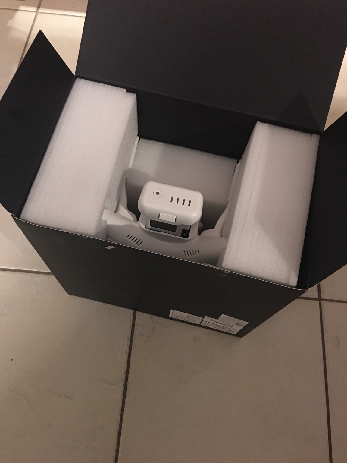

From the time I received that email - it took 3 days and a phone call before I actually received the coupon code (which has to be used within 30 days and can only be used towards the same unit that was lost). After you submit your order, expect 2-day free shipping from China and arrival in a plain brown box containing the aircraft, a battery and 1 set of propellers!
