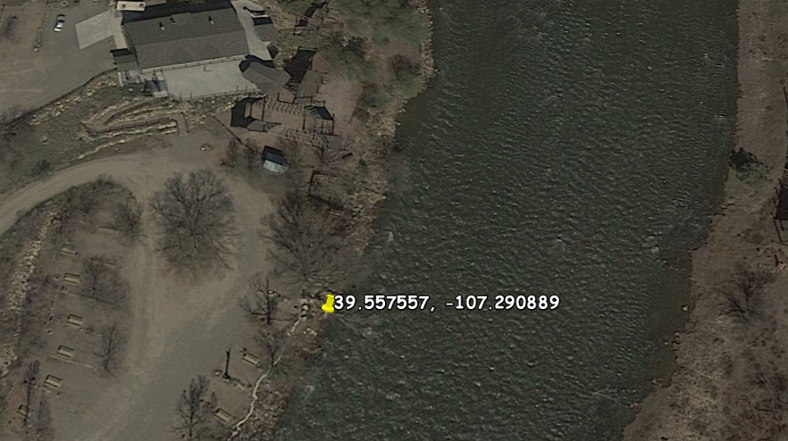

By the way.... This is where you should find your aircraft.
39.557941, -107.29127
I say it that manner because near the end of your data it says the "Motor Obstructed" which tells me the prop was likely up against something causing this to display in the flight log.
It was... Against a tree prior to going down.

Wish finding it was an option, the current in the river is so strong and the water is so high. I'm sure it's long gone but I think I will go back in a week or two and see if I could see the coveted white quad body. **** it!
