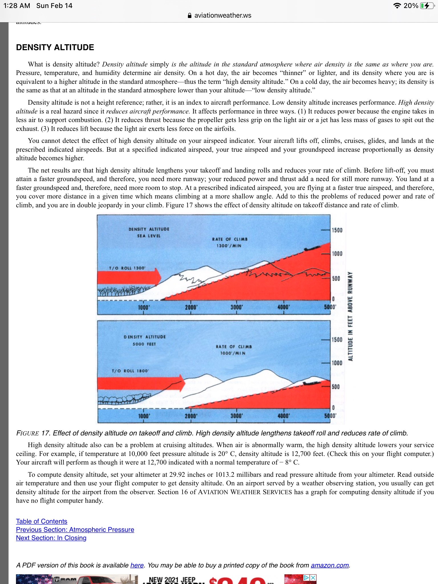

I presume your summer/winter change in elevation is due to air pressure variation? I'm not familiar with Litchi, but it would be beneficial if there was an option to calibrate elevation from a given launch spot. i.e. use relative elevations rather than 'absolute' elevations - which aren't, in fact, absolute. Even after a twenty minute flight I've seen my drone touching down when it is apparently still four metres in the air - according to the on-board barometer.
And no one mentions the FAA 400 foot altitude rule. As a FAA sec. 107 pilot I find 120 meters good for me.
And yes altitude has a big factor in air density. At AGL the density is high. As u go higher it gets less. Density. So the higher you go the less air density there is. AS you reach 60,000 ft in class A air space there is no density. And you can't fly.
