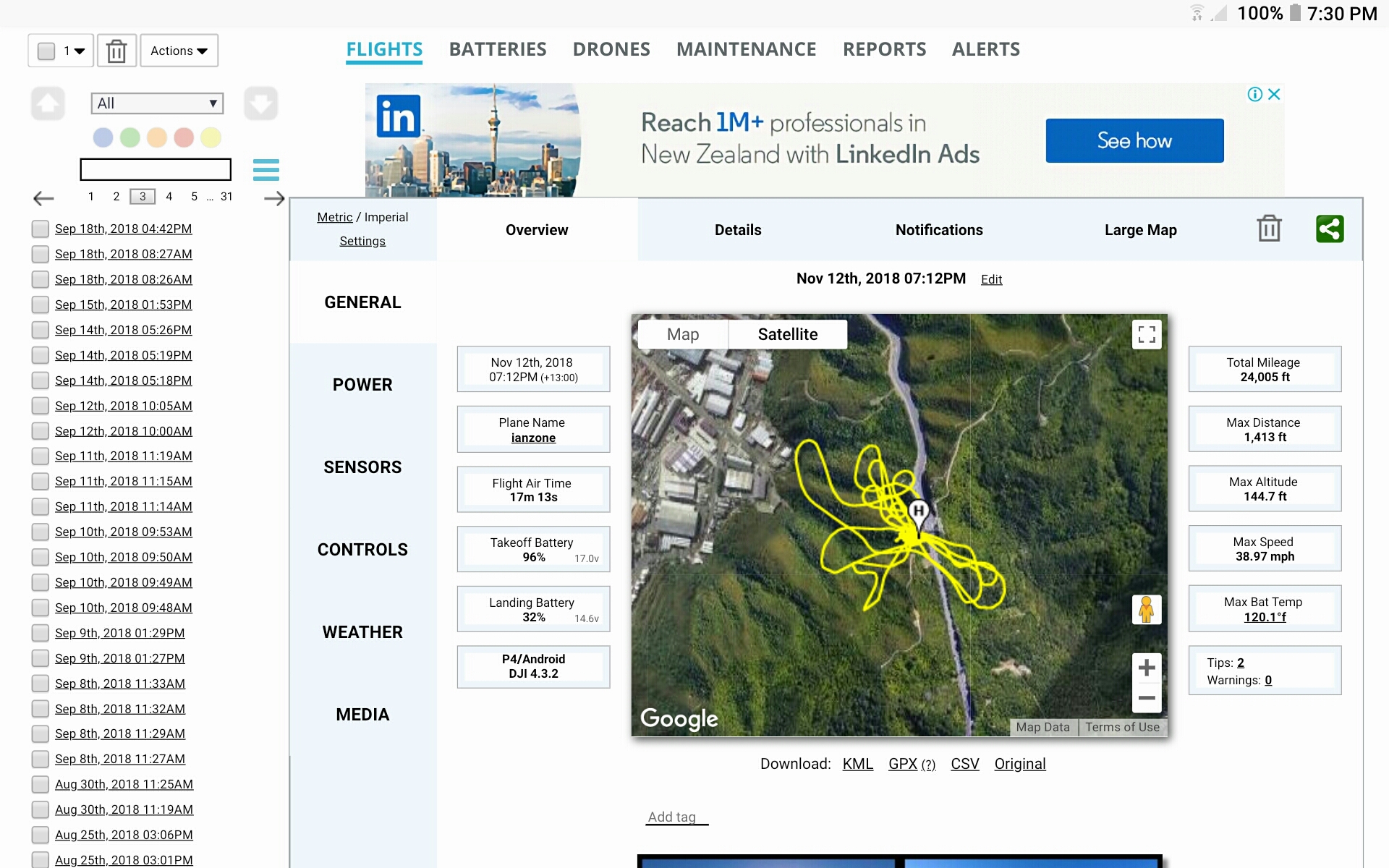

Hi I not use litchi a lot but is this what you mean,,,just Google search airdata if autosync is on in litchi app,might need to log in to this is not used before....djigo4 has it in their editor but sorry not 100% sure with litchi lately
