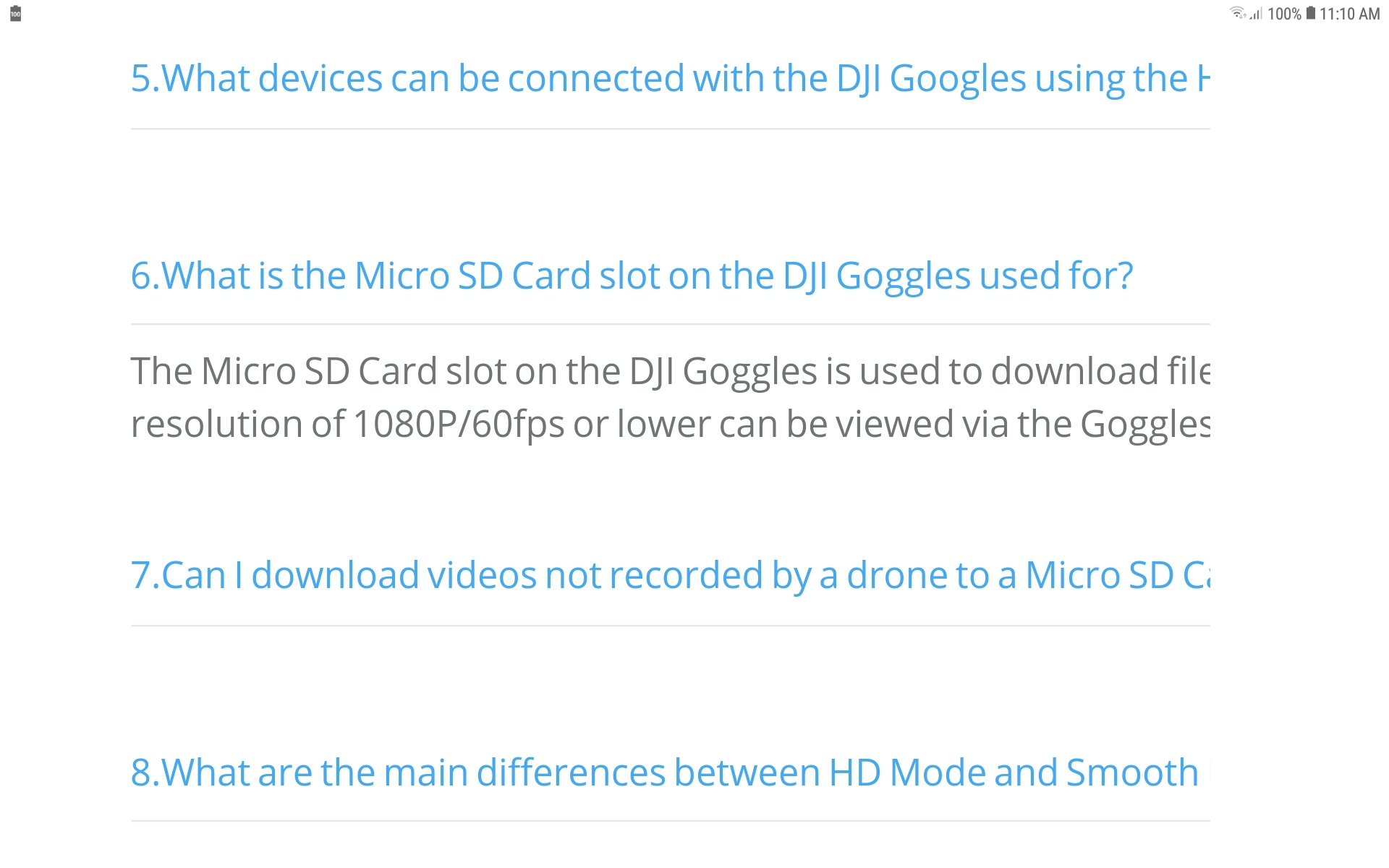

Tryed recording 1080,

And if it still doesn’t see a video at 1080p, try placing it in the DJI_VIDEO folder or USER_MEDIA folder.
Those six “files” are actually “folders” where files of those types are to be stored.
