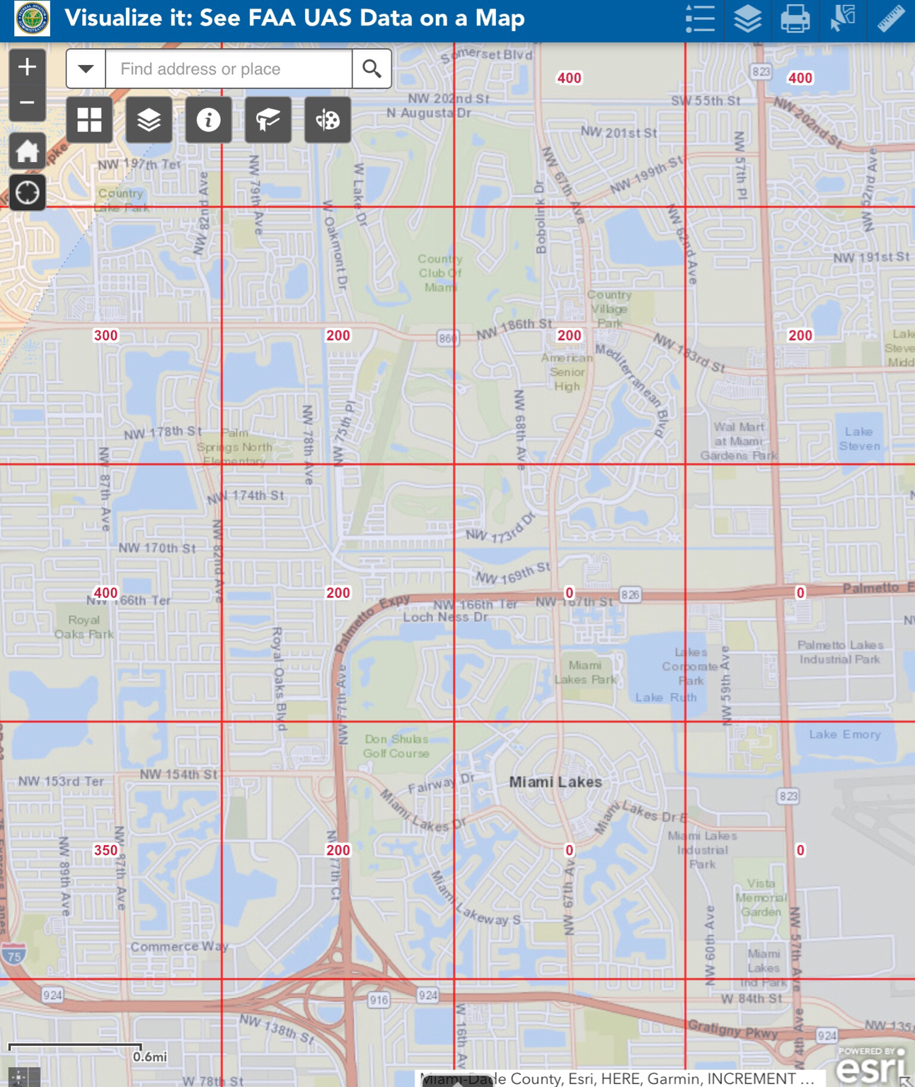

My advice is to first visit this website to determine if you’ll be granted authorization at your intended flight altitude.
ArcGIS Web Application
Once you input your location you’ll get a map showing altitude restriction at your location

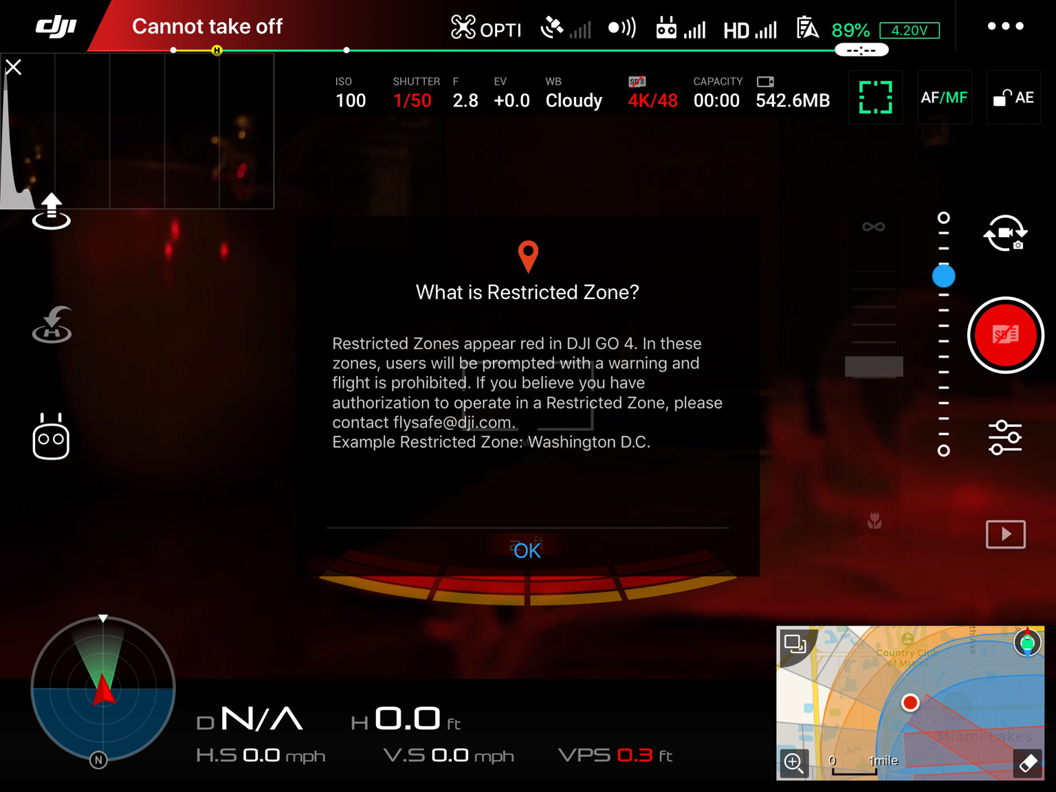

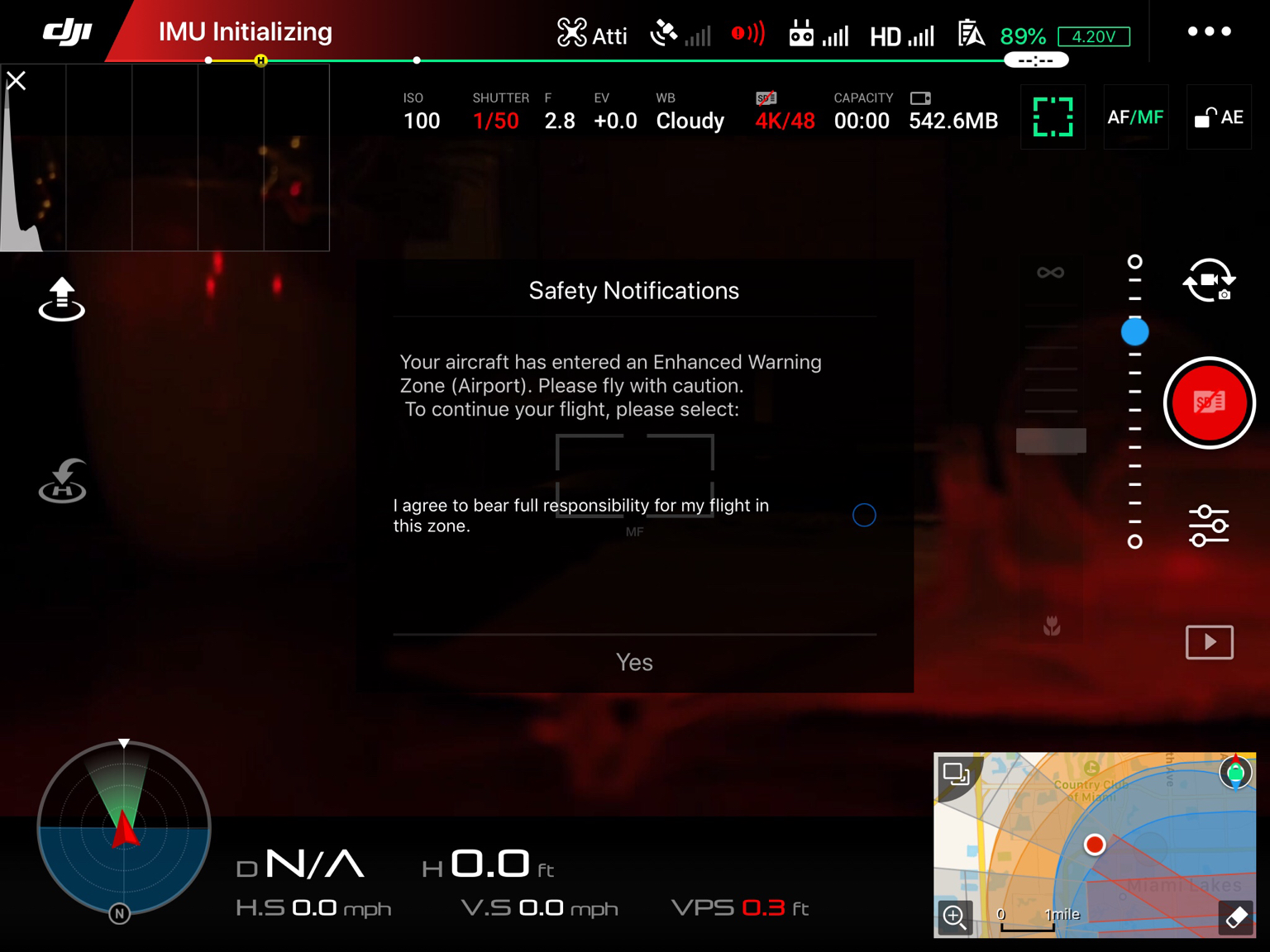

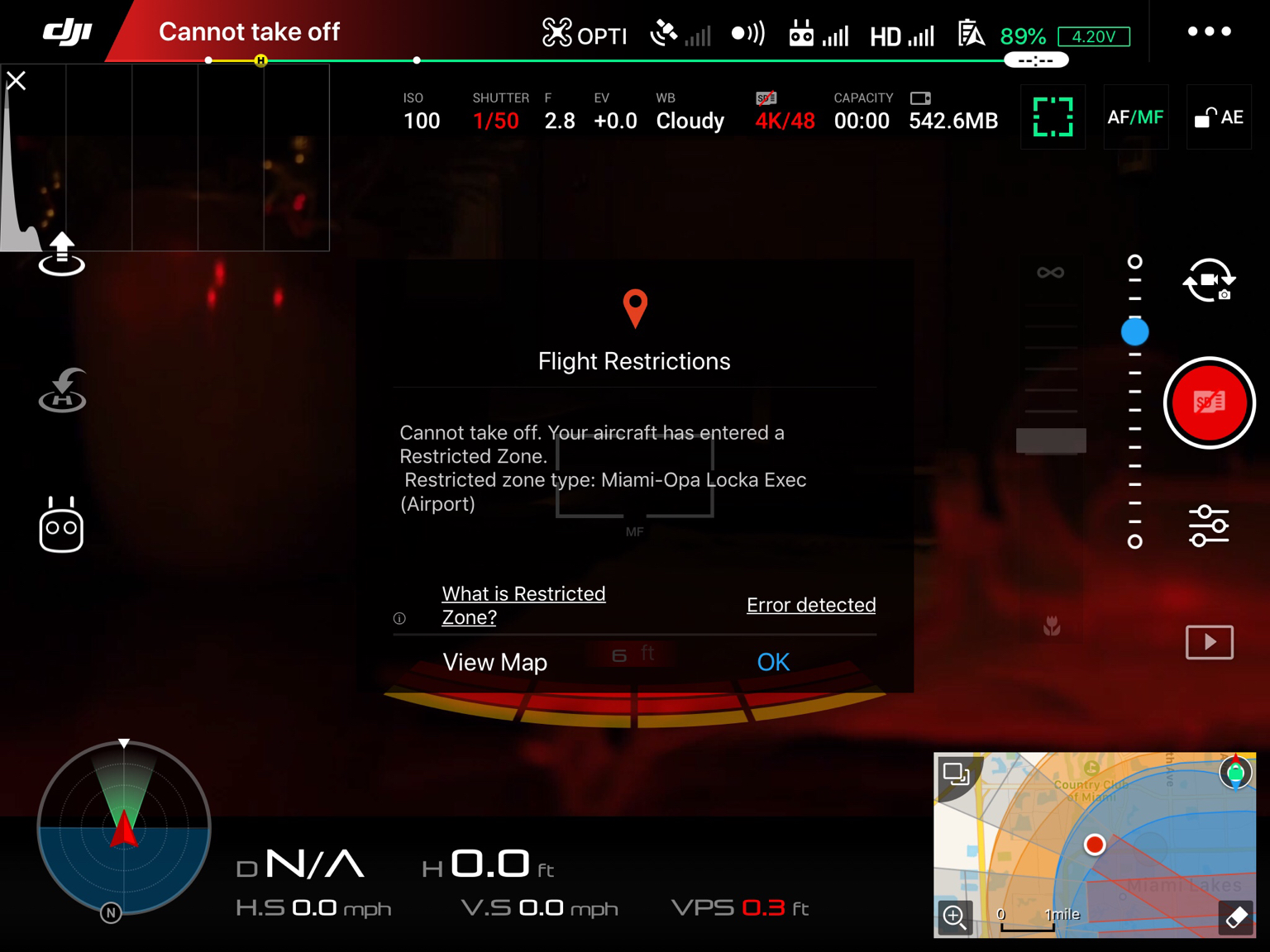

Here are some screen shots when I turn my bird on from home.
This is the way to unlock the geofence at your particular location.

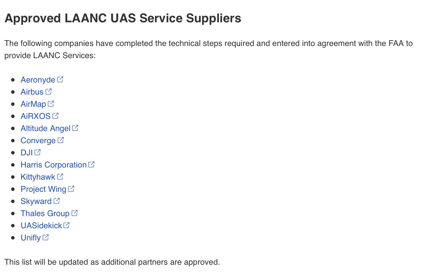

I don’t know for a fact, but, fly the mission with the app that granted the LAANC approval.
That is the app that will be unlocking the geo fence. DJI is an approved supplier of LANNC.

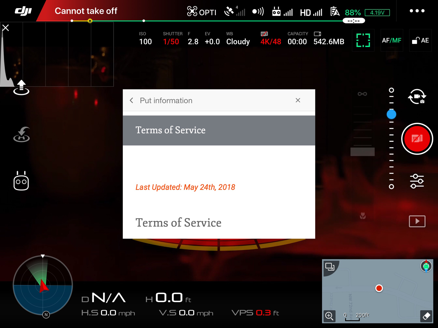

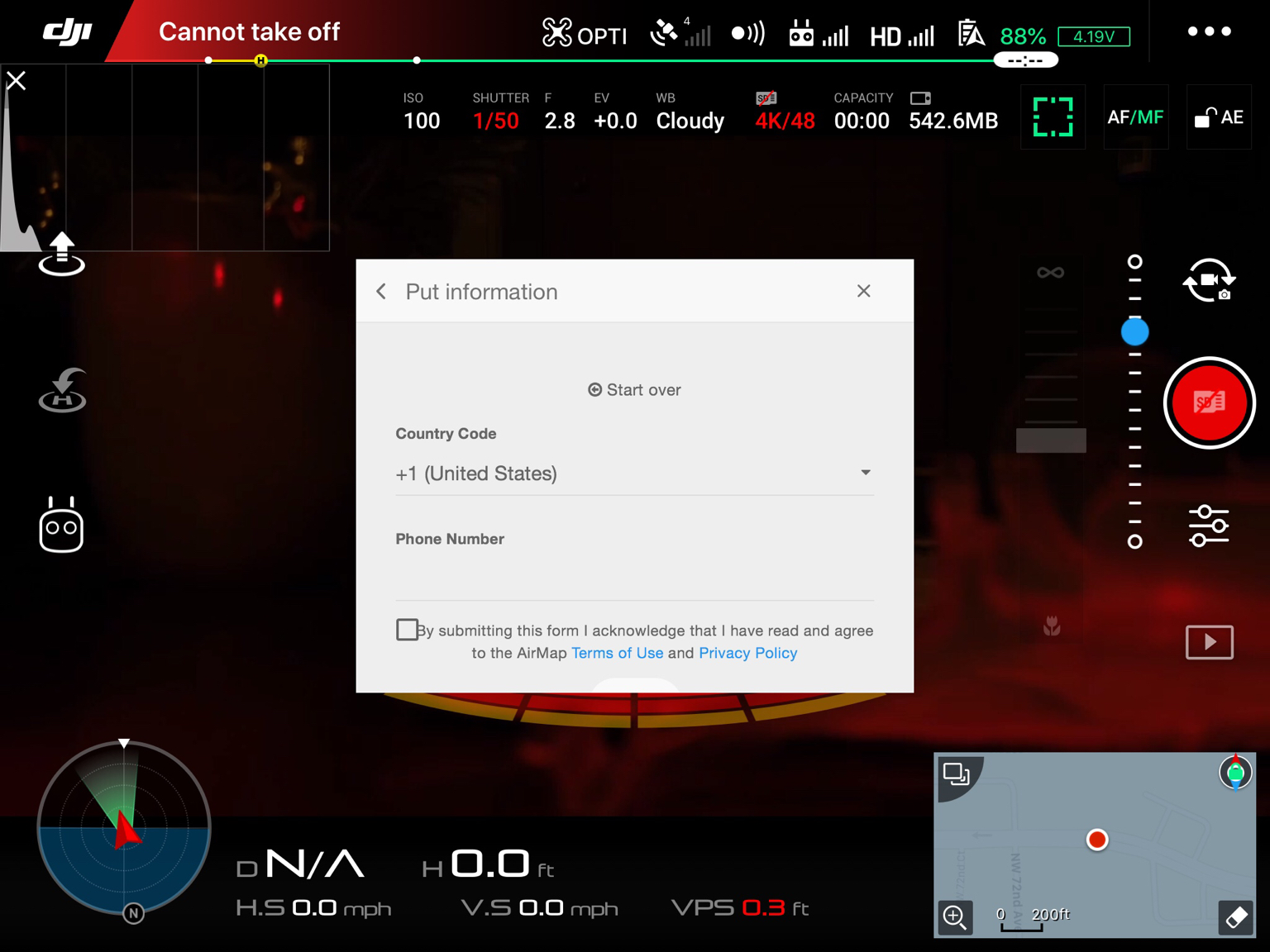

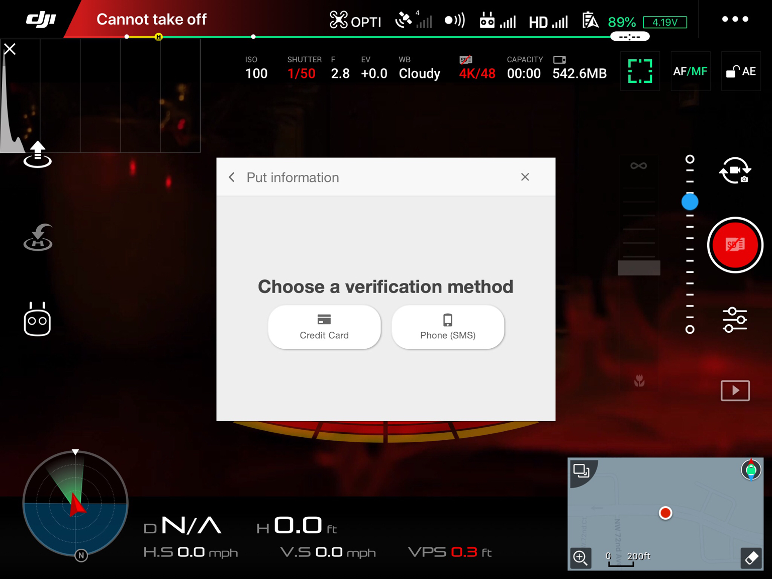

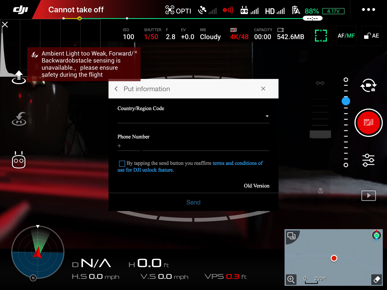

I did like if I was going to fly in class Delta airspace in which I am (keep in mind this will only pop up if you’re in class B,C,D, or E airspace). I put the information requested
Agreed to terms of service

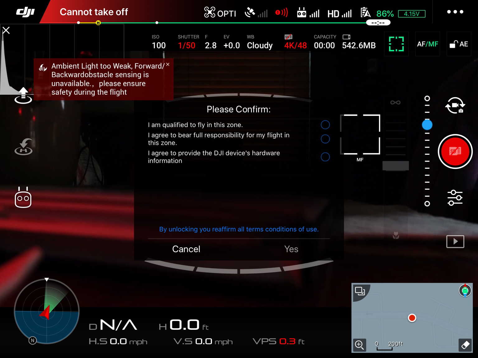

DJI sent pin via text, I entered it then this popped up.
I hit cancel as I was not going to fly.
