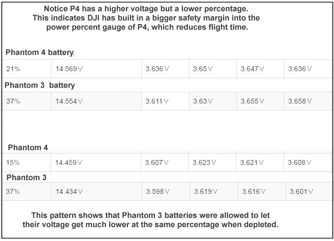

As suggested, use msingers flight log reader to upload your .txt files and compare your P3 percentage/voltage numbers to your P4 numbers. I think you'll see a pattern like this below. This evidence highly suggests the algorithm for the battery gauge has been padded for safety. Had it not been padded we'd likely be getting very close to 28min flight times, given the 20% battery capacity increase.
This would imply that running the P4 battery down to 0% is still leaving 17-20% in the tank, relative to the P3! Too bad the 10% Autoland prevents exploiting this knowledge to use that last 10% or even more for useful flight time. This also might imply that using external batteries with the internal P4 will also be similarly crippled and throttled, because you can't use the last 17-20% of them either! Not good! :( #DJI:GiveUsBackOur20%!!!! :mad:
I'm curious if they change the battery algorithm in a future firmware update?
They sure need to, if this is the reason for the huge differences in battery life with a higher mAh battery. Better yet, make the 0% value a user selectable setting in the app (just like the critically low battery and low battery warning sliders), where you can then choose anywhere from the original 0% of the P3, to the new P4 imposed value of 20% above that, as your personal 0% remaining battery value!:) They also need to give us back the option of setting the critically low battery setting to below 10%, as the Autoland at that setting is far more dangerous than running the battery down to 0% while getting the aircraft back to the homepoint, when over water!:rolleyes:
