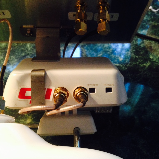

JIMO...DBS panel . The way you mod the extender is the same for both . The only thing is where you put the holes in your extender as I put mine to far apart the first time and just moved it over and put a sticker over the hole . mod.jpg That clamp ya see is what holds the panel on your extender .I had 1 hole to far to the left .As far as distance it really depends where you are and how much noise you have .
It's only $100.00 . and FPVLR's are more . The panel looks good on the TX and ya don't have to be as careful with it .
Am not knocking Tony's at all as that's what I started with but I try everything just to be doing it .
There's a long thread in P2V+ Mods on DBS antennas and ya need to look at it :)
