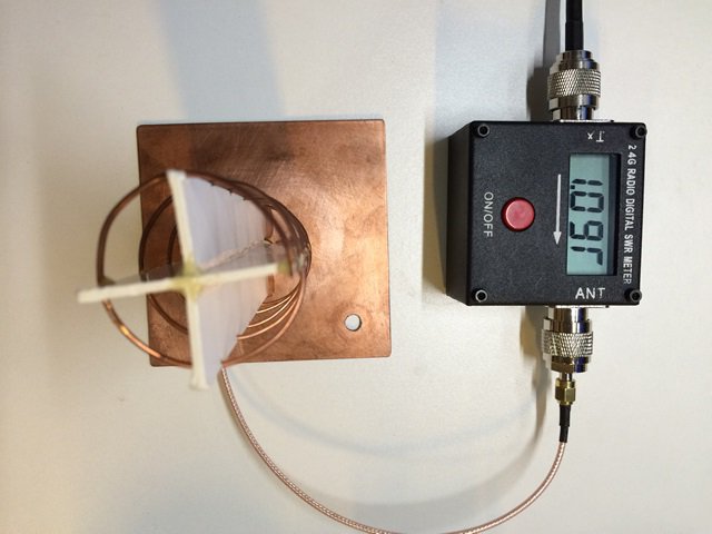

No problem at all. Regarding SWR, I used a low end 2.4G SWR meter to measure my homebrew LHCP helical last year. SWR is not a very crucial factor for antenna performance. There is no notable difference between 1.1:1 and 1.5:1, as long as it's not too bad something like 3:1 to 4:1. I tuned my homebrew helical SWR to 1.09 (the best I got 1.05) was just for fun.
