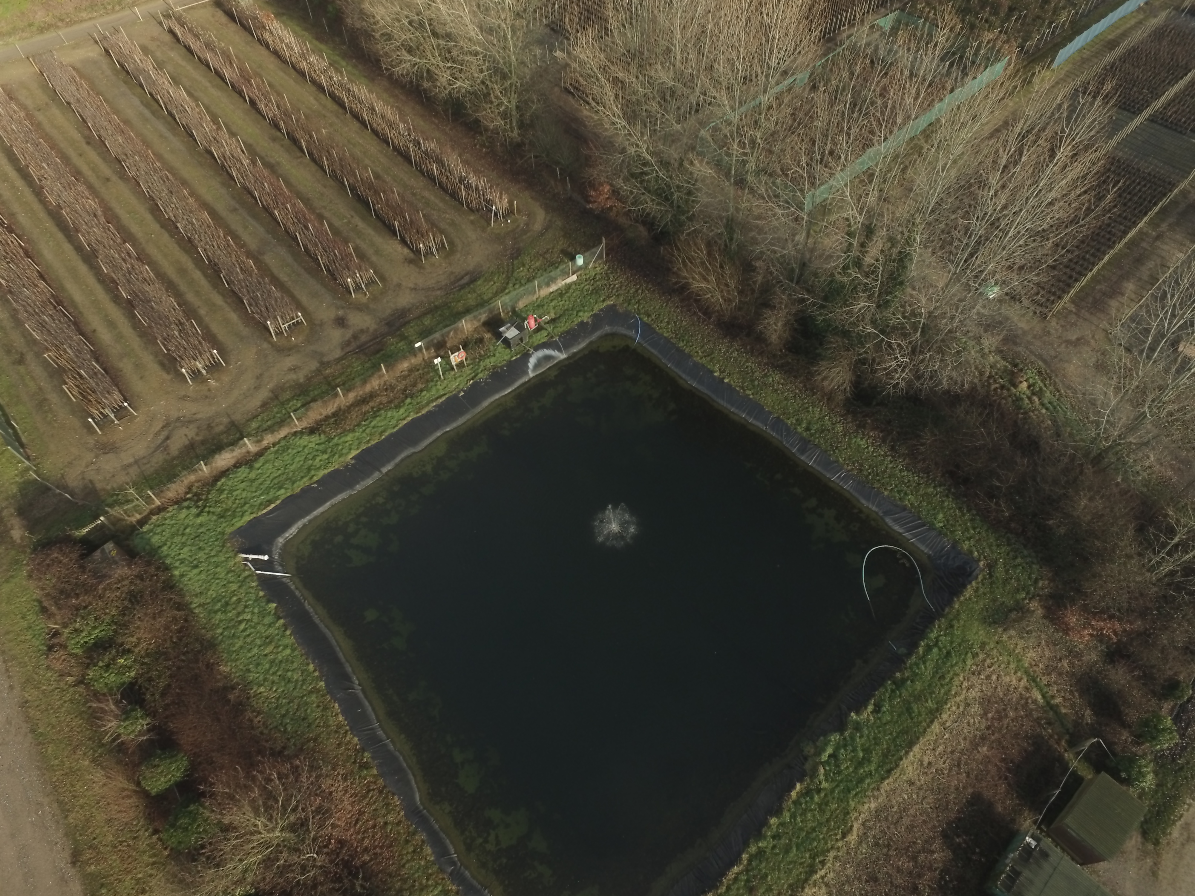

Hey, I was wondering if someone could please take a look at a couple of my photos which I've been worrying look a little soft/ out of focus. These were taken on a beautiful and sunny day, virtually no wind with an ND8 filter.
It's not the first time I've thought these were soft. I've played with the settings as much as I can but can't help but compare them to the level of detail I've seen on other people's photos. The photo with my wife was taken at 900th of a second so was expecting very crisp. The bridge and high aerial pictures were 224th of a sec. All 100 ISO. The people are blurred and the tree on the left seems to lack detail.
I'm not expecting DSLR quality either by the way, but am very conscious I am approaching the end of my warranty and would like to sort any issues now of there are any.
I can't seem to upload any higher res photos, any ideas?
Thanks for the help

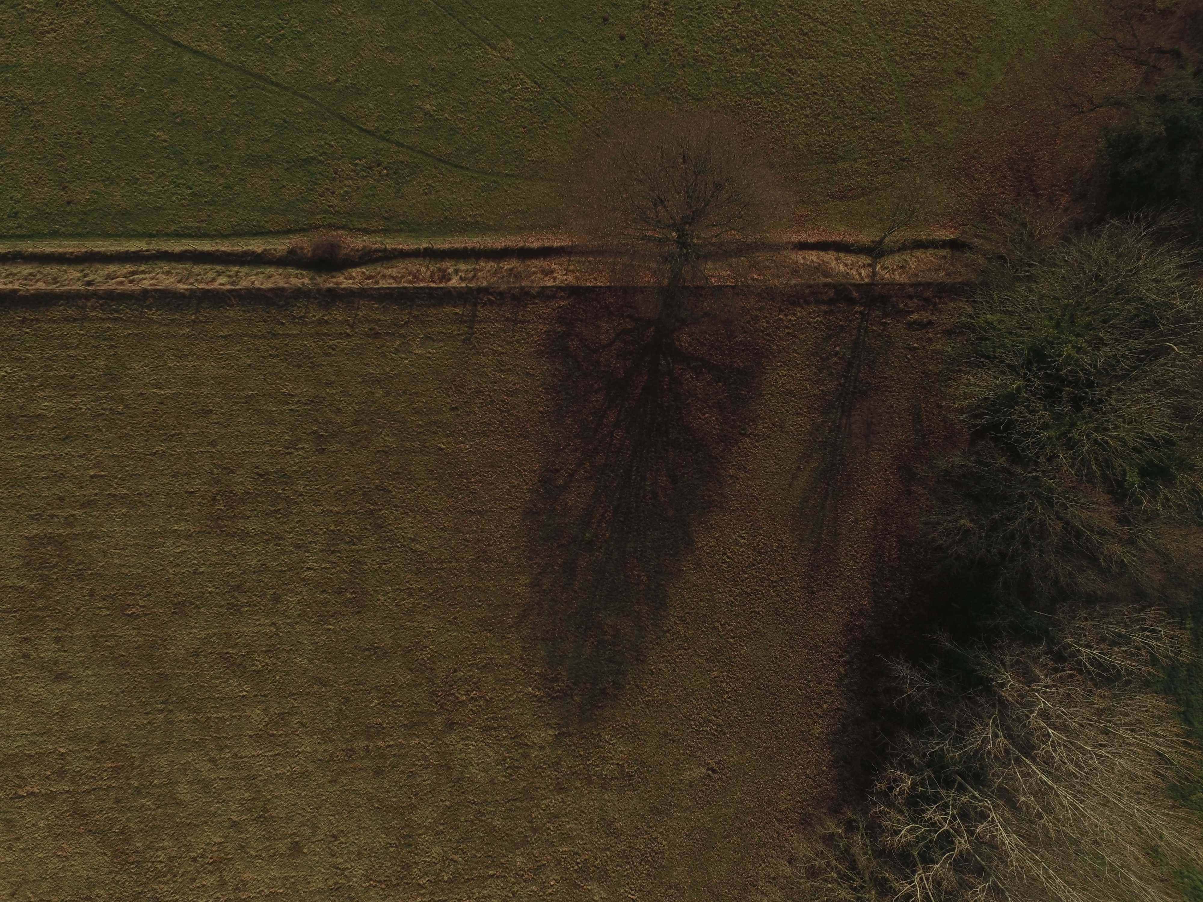

I've uploaded a couple more from today - I'm still not convinced theres not an issue. Taking my lack of photography skills out of the equation, I still think these should be clearer personally.
The ISO and shutter speed are under the title of each picture when clicked on.
I have taken off the film from the front of the lens. I was shooting these without an ND filter.
Had the P3A since July but packed it away until Christmas after giving it a few runs. I wasn't sure of the quality then either.
One thing I did notice today was when hovering there was a vibration through the camera. I imagine the gimbal sorts much of this but I wonder if that's why I'm getting a blur? I have removed the foam thing. And they are straight off the SD card.
Appreciate everyone's help so far, thanks.

I don't think you have a focus issue, the images are about as sharp as I'd expect.
The images do look a little flat but that is easily fixed in post process (much better if you use RAW rather than JPG).
I've done a very quick adjustment of levels to a couple of your images.
