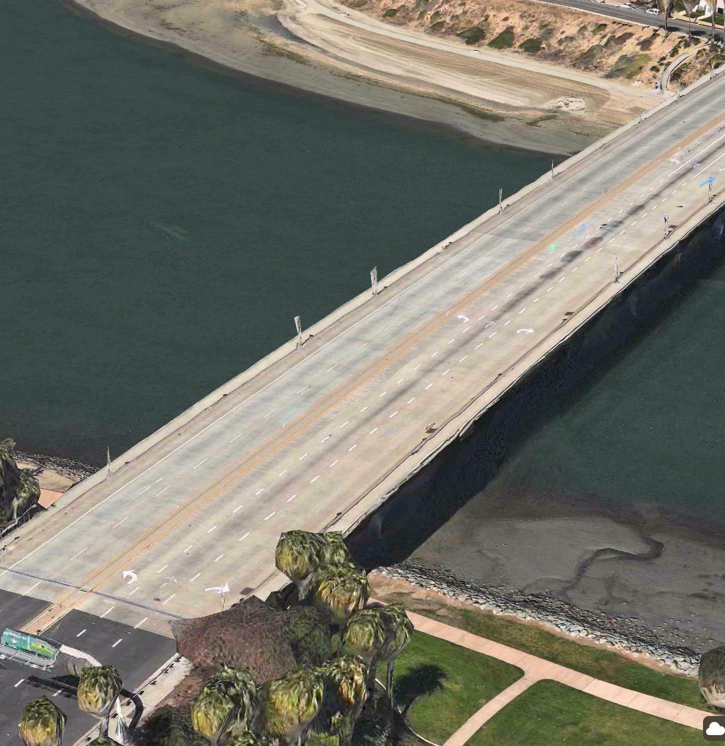

I'm amazed that you didn't lose RC signal going under that one at 2 miles out! Wow!5 lane bridges, like this, are a little more challenging from 2 miles away!
The hardest part was the auto exposure change in the video. It opened up under the bridge, and then was grossly over-exposed when it came out the far side!
I did, but not for a full 3 seconds, until I was on the far side, out from under it. At 35 mph, 51 feet per second, you can cover a lot of ground in a very short period of time! As Adm. David Farragut said, "D*mn the torpedoes, full speed ahead!"I
