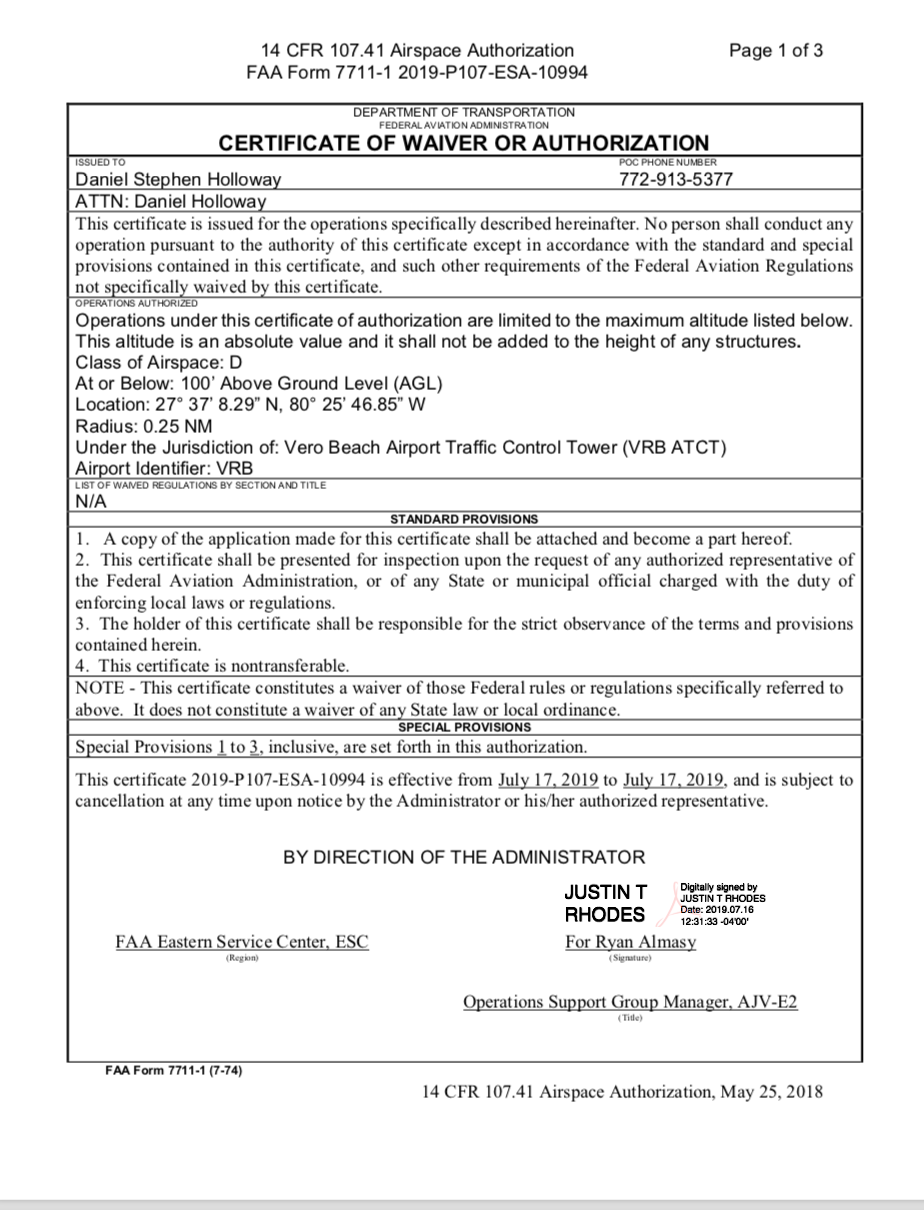

I got permission near an airport here in Vero Beach by applying for a certificate of waiver. I don't remember if I went thru Airmap or Kittyhawk - I think it was one of those. I received the waiver in one day - I needed to tell what I was doing, when and how high I would fly, the coordinates, and for what purpose. Here is the contact info they emailed me -
They also sent a map verifying the area I was permitted to use. Hope this helps - [email protected]
Hi, Thanks! They got back to me on like the 2nd or 3rd business day with authorization! Just in time cause the Realtor was about to go with someone else. :) lol. Now I know the process better for next time.
