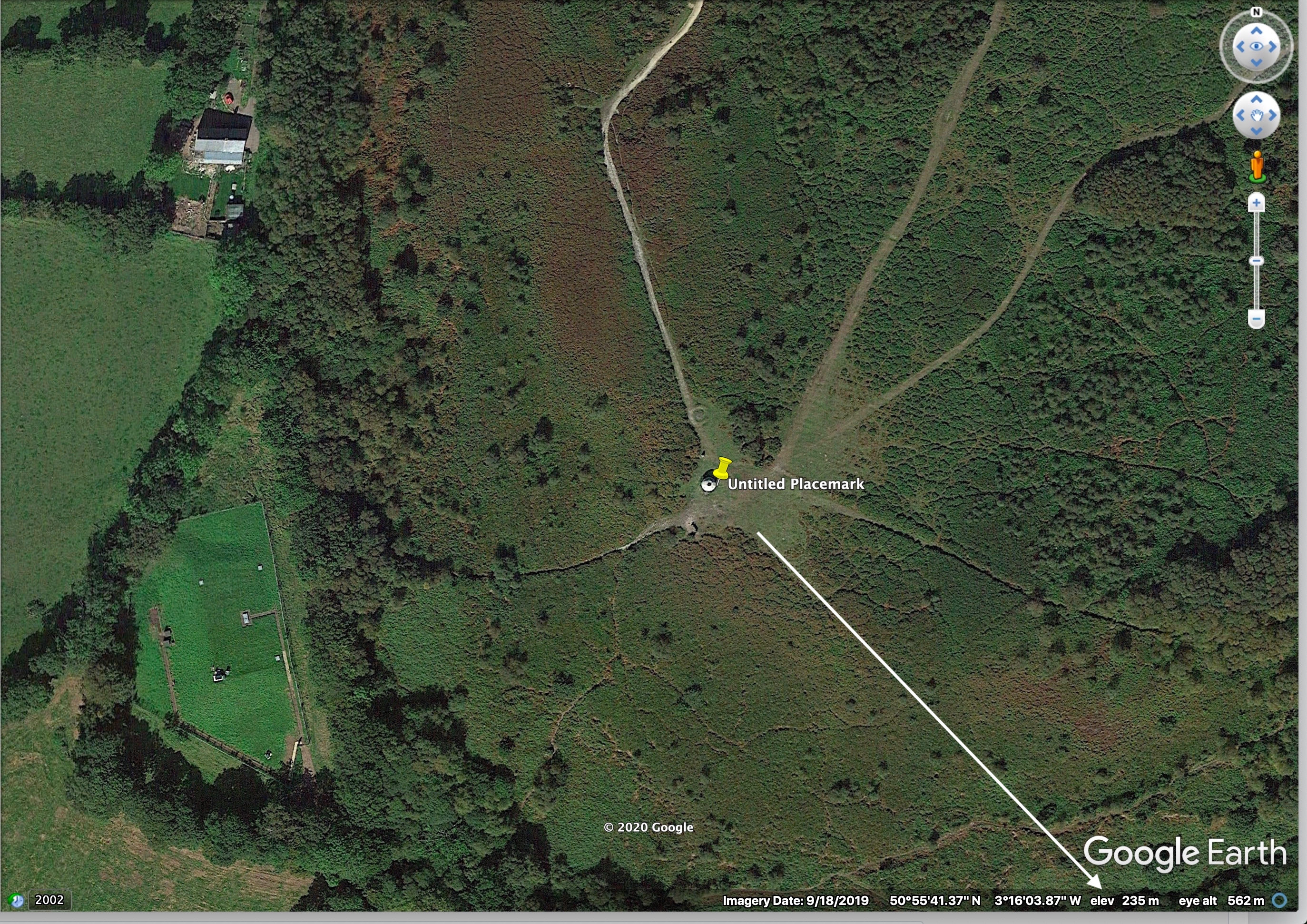

Is there a map site where you can click and get the elevation at that point? It would help in preplanning Litchi missions using the Hub program for an area you are not familiar with.
In Google Earth, if you hover your mouse over a position, at the bottom it gives you the coordinates and the elevation of that point!

I'm interested to know if GE gave you the right elevation .Do you know the correct elevation for the beacon The best I could find off a topo map was 248m above sea level.

According to OS it is 243.2 mt. (I presume above sea level) but GE says 235 mt. - 8 meter difference - 26feet!!!
