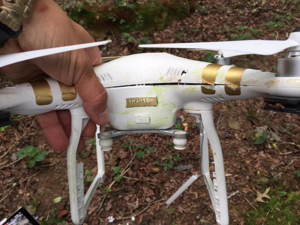

I had the same exact thing happen twice yesterday. The first time the bird made a violent dive to the left. I was able to correct it and fly back towards home. Then it did it again and I couldn't recover. Totally destroyed. I was recording but I have been unable to retrieve it.

I didn't know what else to call it. It may very well not be a flyaway however, since it did things on it's own without input from me on the controller I considered that a flyaway for the purposes of this discussion. Should you think of another descriptor word I would be happy to use that (LOL).
I personally don't care what we call it just so long as I can figure it out and not have it happen again
But for the grace of God that very well could have been my Phantom (without the grass stains). I am sorry for you and I now understand how it feels and the whirlwind of thoughts that spin through your head as you watch it happening.
That blows. Log a case with DJI. Post your TXT log file if you can.
