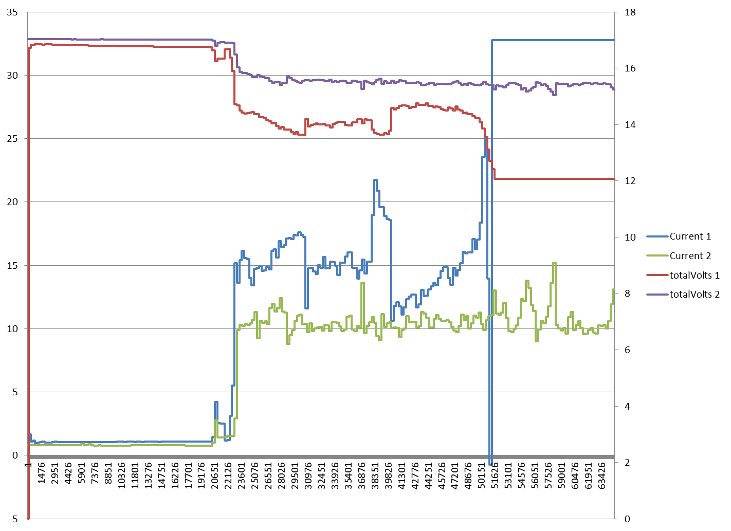

I do not see any signs of flyaway. The input to RC sicks matches more or less the flight path even though you apply some right roll which doesn't seem to reflect in the flight path.
Im no battery expert but the batteries have an issue. I do not know what the tempature was but I think BudWalker still working on finding the ambient temp ;)
You will see the individual gauges of the Battery's 4 cells indicating their individual voltage. The fifth cell called voltage spread is the difference between lowest and highest voltage value.
The voltage spread is also indicated in the middle chart. You will note it goes upto 0.25v. Normally on a good battery, this chart should be flat or close to flat with maximum occasional variance of 0.1v
So some of your cells are toast -
On side note amps and watts look usual numbers. Only at end of flight do they spike down (strange) and then up. That makes me think that nothing stuck in your motor, bad prop or other mechanical issue.
Total voltage goes to 12 volts, battery cuts off and you crash.

I agree it seems to be some kind of battery issue, there is some weird surges in the current draw as well. I started comparing to part of a normal flight and found the initial voltage drop to be higher than what I have come to expect. I started looking at the average motor load and found them higher as well, then I realized with the name you must be flying in Colorado! That higher elevation would definitely increase the load required to fly! (I don't think that is related to the incident) How old was this battery and how many charges? What is the shape of your P3 (motors free and stuff)? Check the chart below, Current 2 and Voltage 2 are from the start of a normal flight, notice the voltage drops and plateaus at 15.5 V while the other one initially drops to 14.4 volts. The voltage per cell never gets below 3.7 on the normal flight while on the suspect flight it gets below 3.5V fairly quickly.
