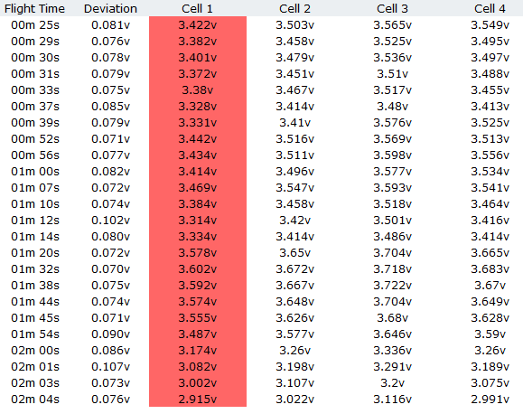

Kevin found the P3 and posted the .DAT.
Dropbox - FLY181.DAT.
I looked some at it and would appear that the battery turned off when the voltage on cell 1 got below 3.1 volts
However, the battery turned back on about 1 second later.

Attached is a .zip that contains FLY181.csv. There is no ambient temp, but the battery temp could be used as a proxy. I suspect that's what you're after anyway. There is all kinds of info that can determine if there was a rapid maneuver; accelerometer, gyro, velocity, control inputs, etc.

Thank you Soooo much for your analysis of the data. First in answer to Ken's question I was not doing any maneuvers, I was flying straight and normal. The ambient temp. was ~+37F and sunny, humidity was low to mid.
Regarding the battery data, I noticed from healthy drones (data below) that Cell 1 was immediately reporting low voltage @ 25 seconds. I am wondering why I didn't get a warning from the DJI SW at that point? Any idea? Especially as it neared a total shutdown scenario.
Also I could use an opinion. It appears that this is in fact a battery failure,.... would you agree? OR Do you think I should go to DJI with this data? I appreciate any advice that you have at this point.

DATA FROM HEALTHY DRONES
Go for it!! I remember when HealthyDrones first came out that somebody presented DJI with the HealthyDrones battery analysis. Based on that DJI agreed and gave him a new battery. Maybe they'll do the same for you and give you a new P3. DJI may or may not look at the .DAT file but that will just make your case for you.
It is a little strange that you started at 100% and cell 1 hit critical after just 2 minutes. Cell 4 wasn't far behind. I've not followed the battery discussions closely, maybe someone else can give some advice. @msinger
