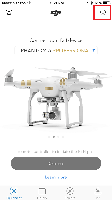

Your Phantom needs to be on (with the motors off) in order to use the flight simulator. It would be a good idea to keep the props off too since you'll probably be doing this indoors. Then, start up the DJI GO app, and click the graduation cap icon at the top, right corner of the DJI GO app.
I dont have any graduation cap icon on my screen.
