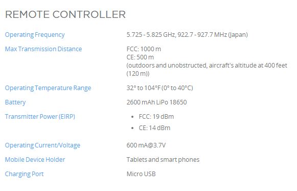

I was just quoting the published specs from DJI for a P3S RC.

Very strange
Not so strange really. As far as I know, there has always been a difference between CE and FCC.
Your two P3Ps for instance are listed as 5 km for FCC countries and 3.5km for CE countries.

The 300A and 300B RCs both have the same power output for the control signal. It's only the 300C version of the RC that has reduced power. If you don't do any very long range flights, you probably wouldn't notice a difference with any of the versions in that regard.
The 300A RC has the DaVinci processor and USB 2.0. B and C don't have the internal video processor, but do have USB 3.0.
