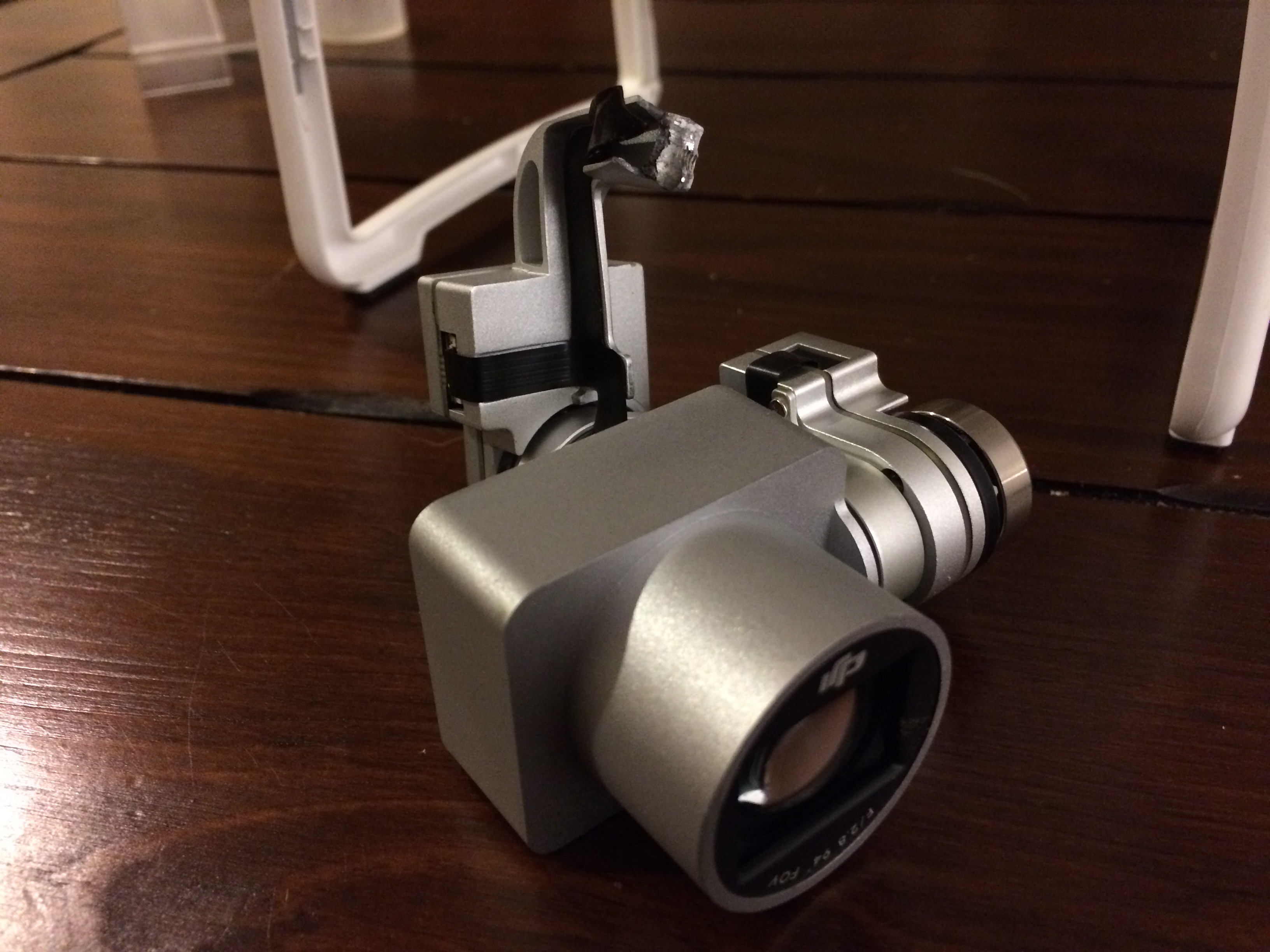

I got panicked, ran into the woods and located the drone on the ground. A bit of dirt and scratches, one prop is broken, and the thing that upsets me the most is that the gimbal is completely broken.

I had my first crash with my P3A about a week ago. Pilot error and clipped a tree and broke the gimbal arm and ribbon cable. I did a few internet searches and ended up buying a gimbal arm replacement kit that included a ribbon cable as well for around $41. Watched a few YouTube videos and went at it. Took awhile and I know I could do it much faster a second time but I got it all back together and working. Good luck with whatever route you take.
Go on YouTube and search for gimbal repair. P3S you can get all the info you want
Thanks. What exactly is a ribbon cable? Is it the black cable that goes along the gimbal arm, that one that is broken in the picture above?
u need double sided ribbon frm ebay dont get single or else u wil waste money.
