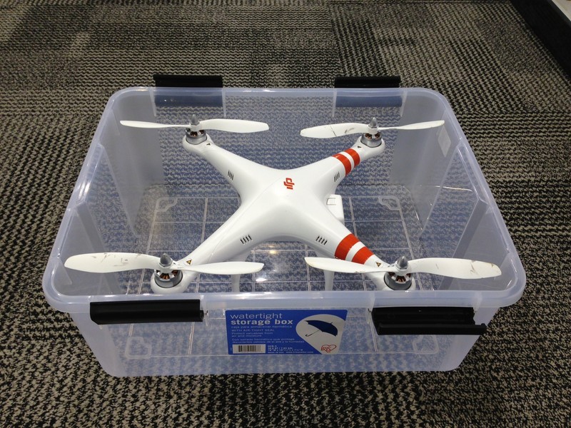

    So I've been looking all over and finally found some great waterproof totes at The Container Store. (Disclaimer, I don't work there, I don't have any interest in them...) They have two sizes that will work.

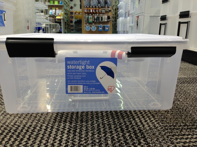

    The first is a 30.6qt case. (19 3/4" x 15 3/4" x 8") It fits the Phantom perfectly, but leaves no room for expansion, and I feared, no room to go up in prop size. You can grab one for $14.99.
    [​IMG]

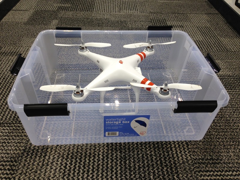

    As you can see, if fits the Phantom exactly:

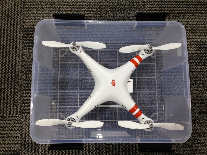

    [​IMG]
    [​IMG]

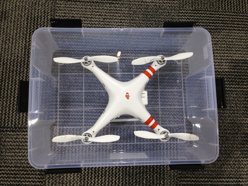

    I decided on the 41.2qt case instead, (23 1/2" x 17 3/4" x 8") to give me some breathing room to put other things in the case and accomodate larger props safely. You can grab one for $18.99.
    In this picture, no part of the Phantom is touching the lid. If I picked up the box exactly as you see here, the Phantom slides around.

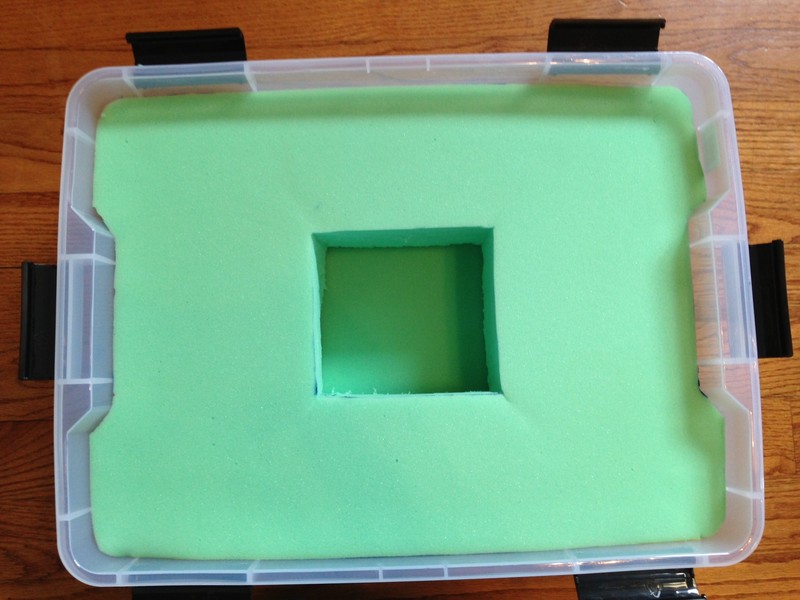

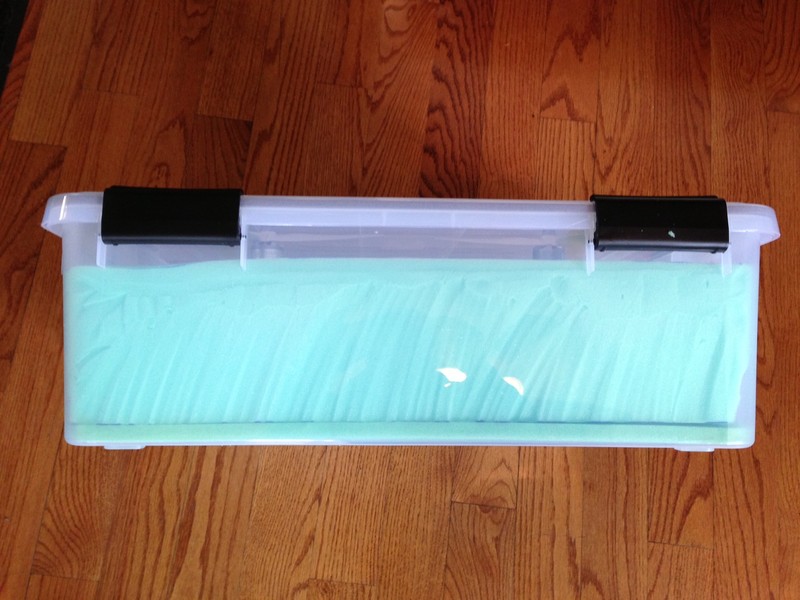

    Next, I came home, measured and cut the foam with a serrated cake knife. It's easy to do, just take your time and measure twice, cut once. The 5" piece is a little tricky in that the box tapers, so you need to shave an angle off the side next to the bottom so it all fits snug.
    Lastly, I found that the Phantom landing gear are exactly the size of a standard paper napkin. Boom, instant template.

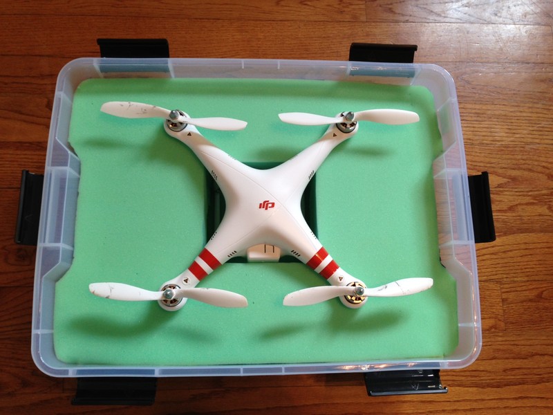

    I cut a hole in the 5" foam and here are the results.
    [​IMG]

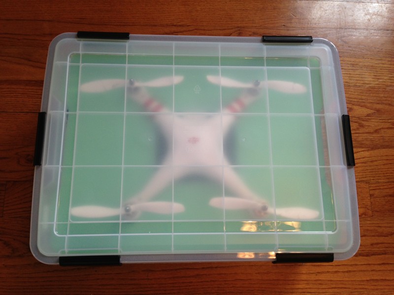

    All buttoned up with the lid:

    Taper marks from my knife...

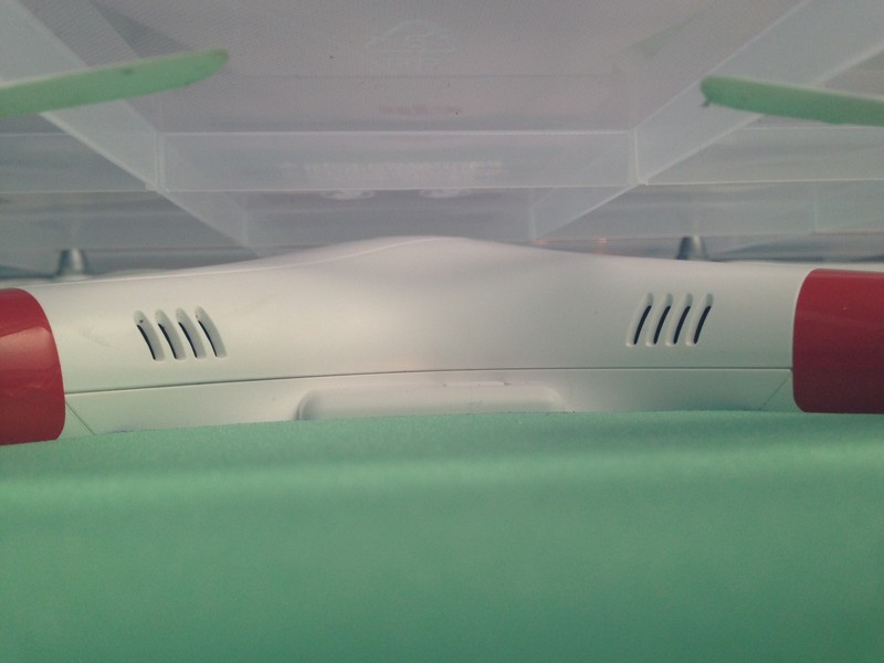

    Now that the Phantom is sitting on the 1/2" piece of HD foam, the Bullet Nuts on holding the props on touch the lid, but not the props themselves. No other part of the copter touches the lid at this point other than the 4 prop nuts. I had the 1" strip running down the center, but I think it might be just a tad to thick and is putting pressure on the lid. I'll keep working with that and post a follow set of pics.
