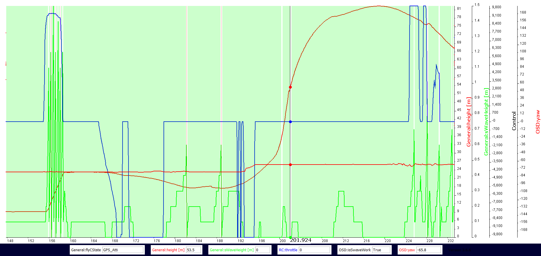

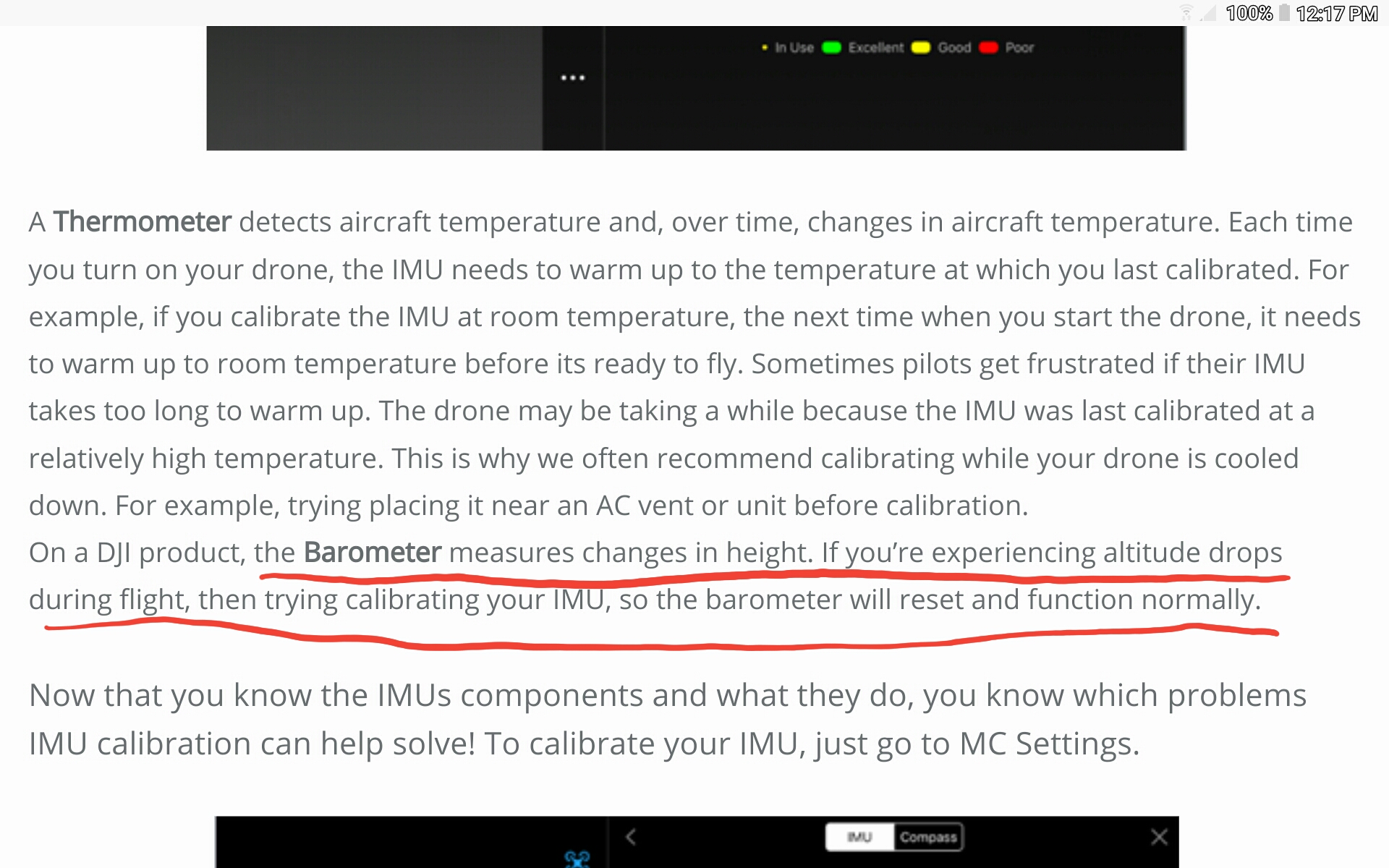

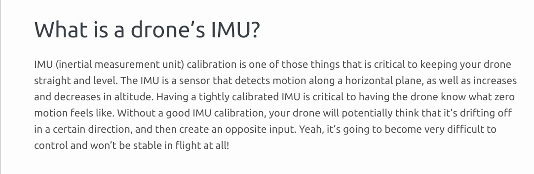

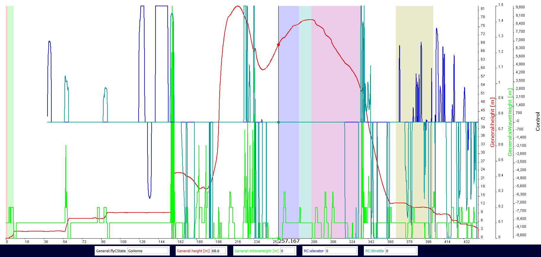

Can anyone help me solve why my P4 Adv with built in controller (GL300E) is flying erratically and performing actions without any input from the controller (e.g. ascending to max. height with both sticks untouched; descending 10-15 ft when it should be hovering; drifting when it should be hovering (in no wind); with good GPS signal during all of the above. I have reinstalled the aircraft firmware while on DJI support with no improvement, and am about to reinstall the Controller firmware once I can track down a micro CD reader, but would appreciate any other input from veterans...
