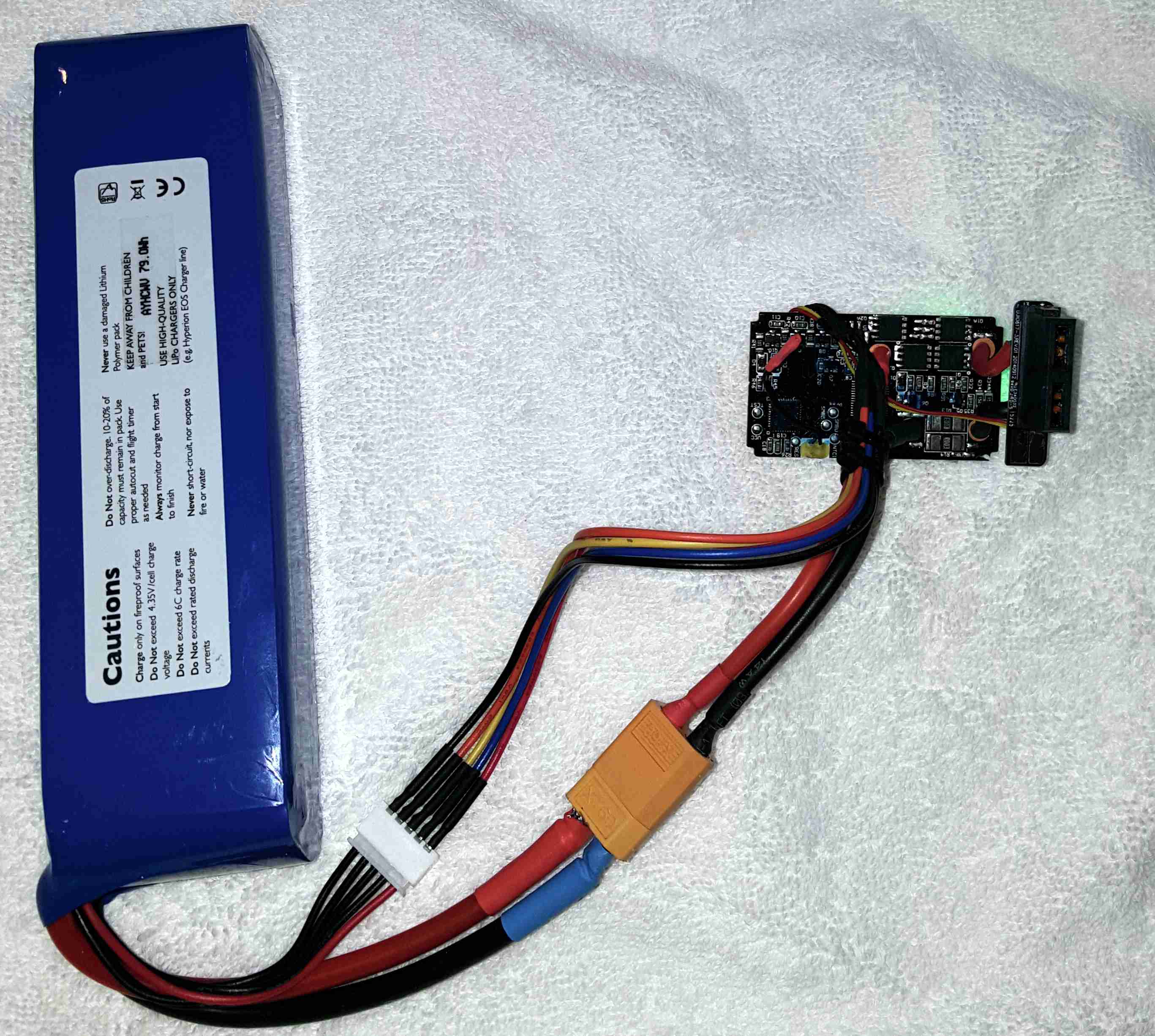

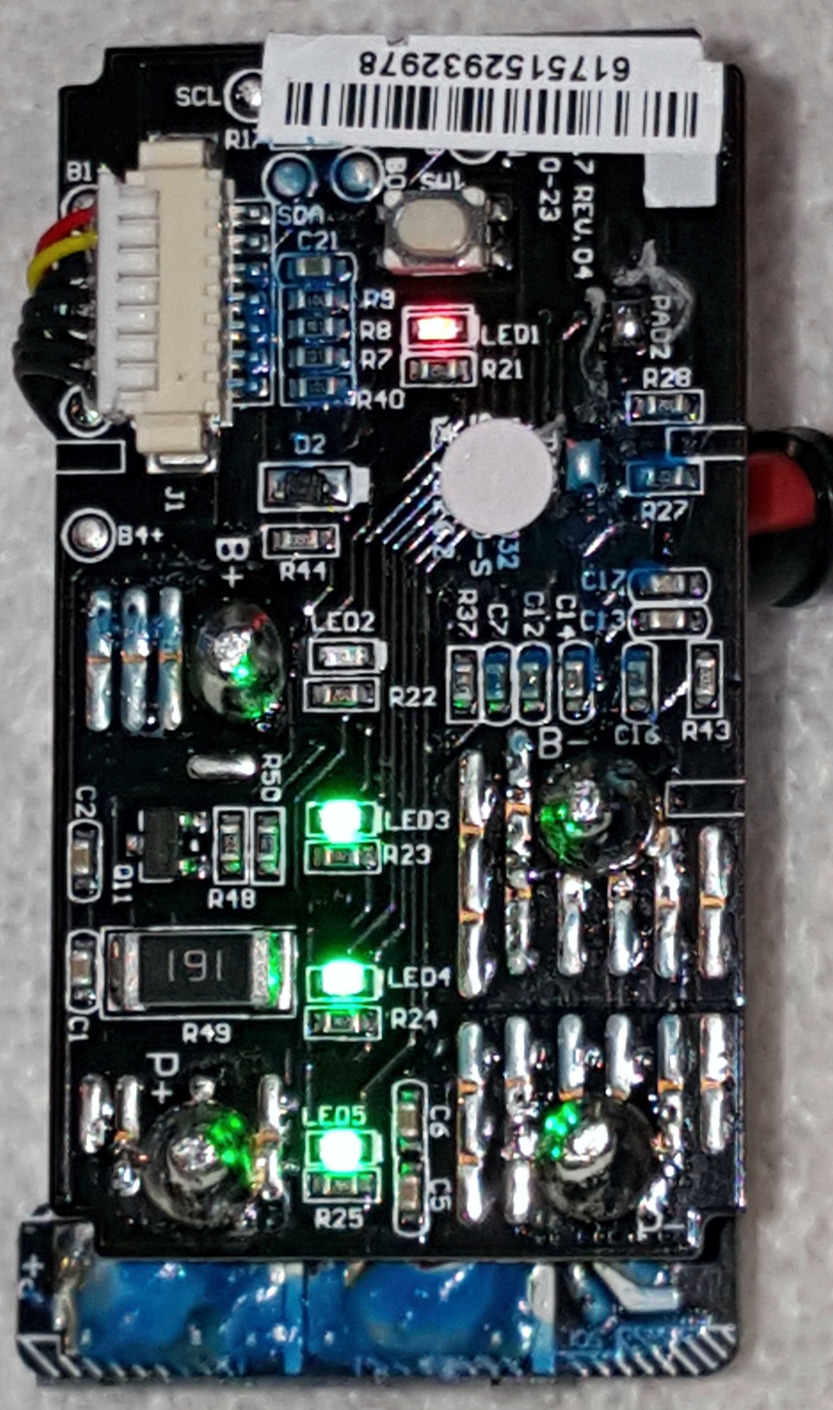

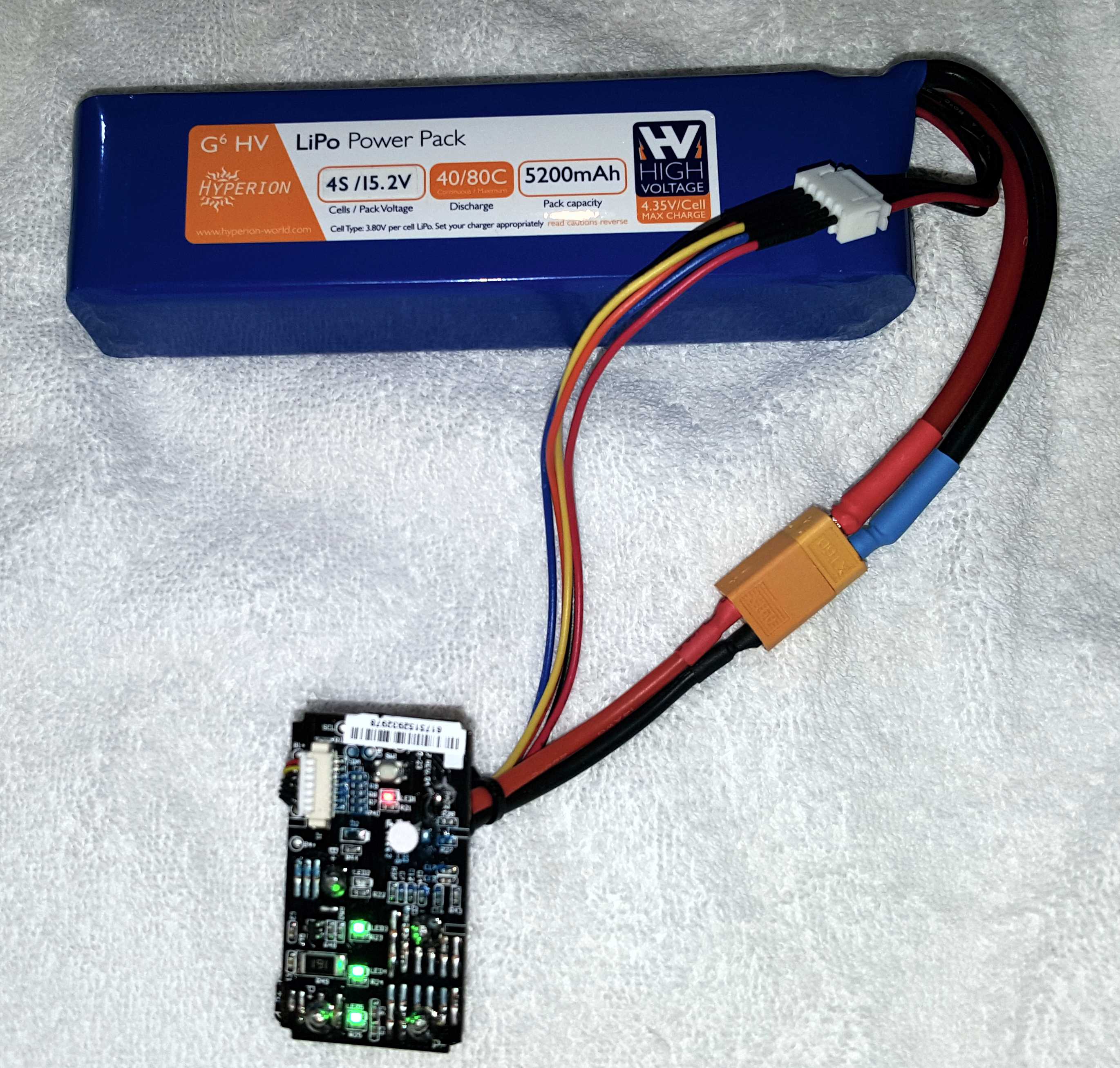

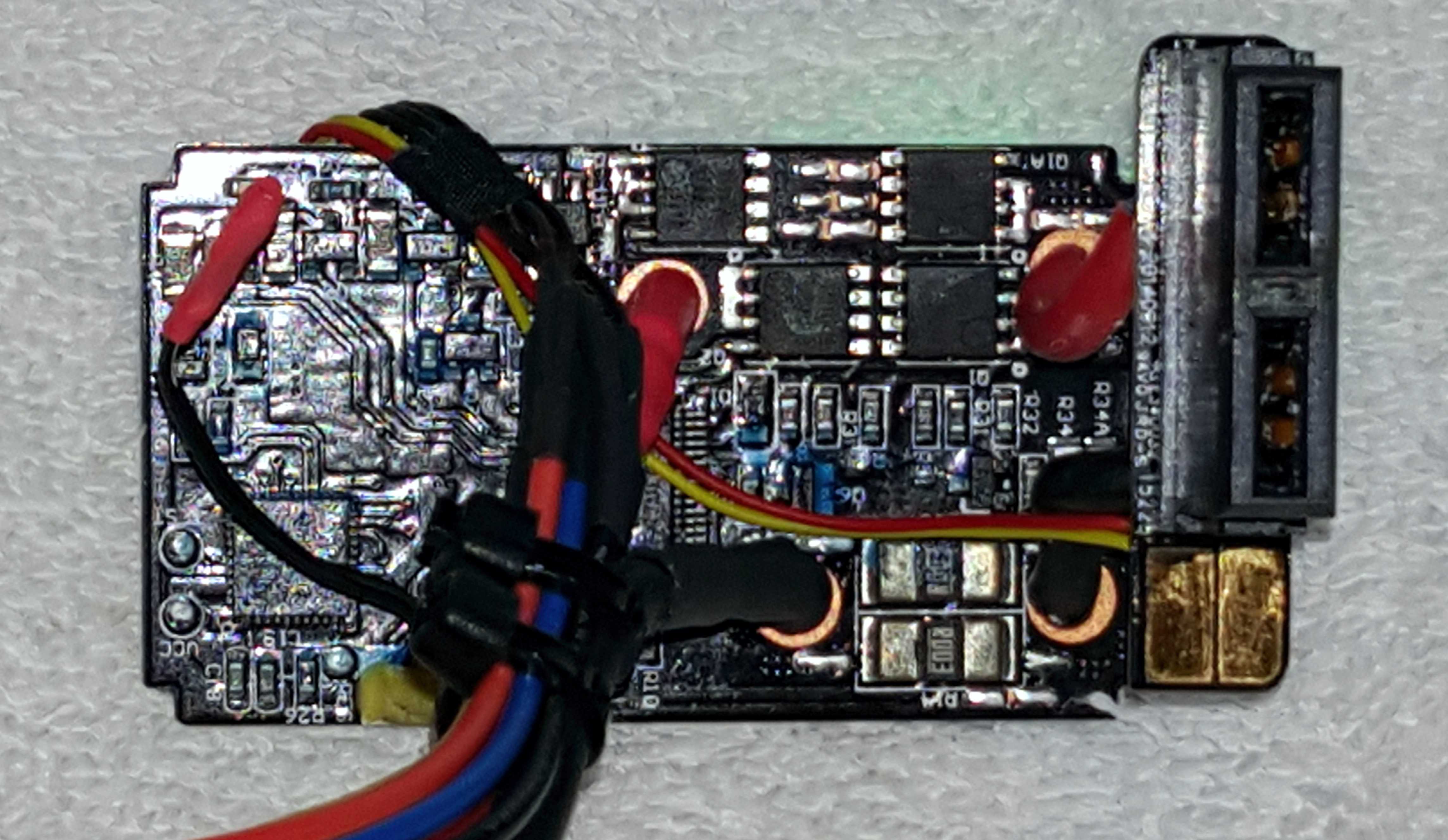

Yesterday was lousy.. (not the news, btw...) I put my test P3, DJI, smart battery together without the embedded battery. If you remember, I was working toward separating the smart battery technology from the battery to allow more flexibility in extended flight configurations. I went to test the setup and found that it would not remain on. It would start OK and looked healthy otherwise, but I could not get the **** thing to stay on.
I didn't want to report anything cause there were too many variables including pilot error. So I did check all of my connections and found no problems. The other possibility I felt highly likely was that the board from my experimental battery was subject to too much abuse from myself, and I, to rule out this possibility, pulled another battery, known to work. And to my amazement, that was it.
So, would you believe this concept actually works? I have just done a few basic tests to satisfy myself that the battery is doing what it is supposed to be doing. I will try to do something a little more convincing for those more skeptical such as put a bird through a flight , or something. As I can digest what I have right now, compared to the master/slave concept we have been using, this would be superior since there is less to go wrong, and there are more available battery configurations. Configurations like: one big battery, 2 bigger side board batteries, etc...
Of course, this is raw, maybe thee is a gotcha... Here are some pics.. The configuration I am working towards for my next extended flight vessel was described by Canada the other day. My little twist is that it will have two side board 4s's w/everything in parallel. Battery & cells. If the bird lost an entire battery, it would probably still be ably to get home. This is the type of redundancy that makes sense for aircraft.
View attachment 44850 View attachment 44851 View attachment 44852 View attachment 44853
And hey, the controller had no hesitation accepting another battery to control. This was my original concern. I was afraid there would be big pauses, etc. Nothing so far....

Nice work. I'll be standing by for more info. One question: any issues keeping the DJI connector in place? Specifically the pads that are connected to the yellow and red wires. That's the data link for battery info. I'd imagine that could separate from the connection under flight/vibration.

Yes, my first prototype left the battery cage empty and used it for the wires only. It looked almost like a normal smart battery, but with a power and balance connection on each side, but was real light.

This mod can be really good for those that like to think out-of-the-box. I know you asked for the weight of that Hyperion HV. It is 502 g. That battery will fit down the middle of the P3, but it is too long.
However, with this mod you don't have to close the cap on the button end - you can simply plug it in and make sure it is secure. Depending on how you configure your copter, you may opt to swing the board wide open and leave the opening clear on that end. The other side, above the camera may be possible to make an opening. I'm not sure yet. If so, that may be the hot setup for extended flight....
Hmm .. DJI's battery is roughly 13.3mah/g.... Your setup will give us 10.3mah/g (prob a little less because I didn't take the wiring / smart cap into consideration. I know that's not a lot, but I wonder if there is a battery that has a higher mah/g ratio than DJI at a reasonable cost ??
