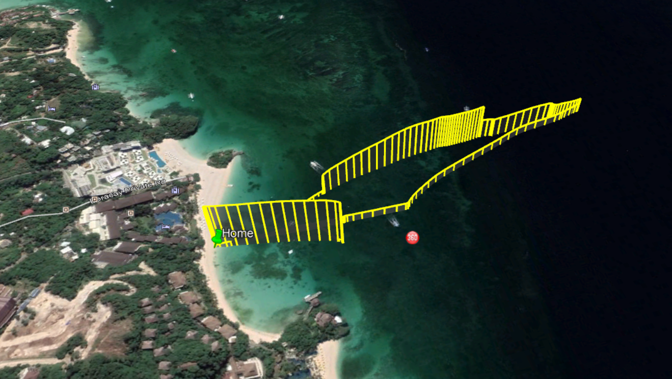

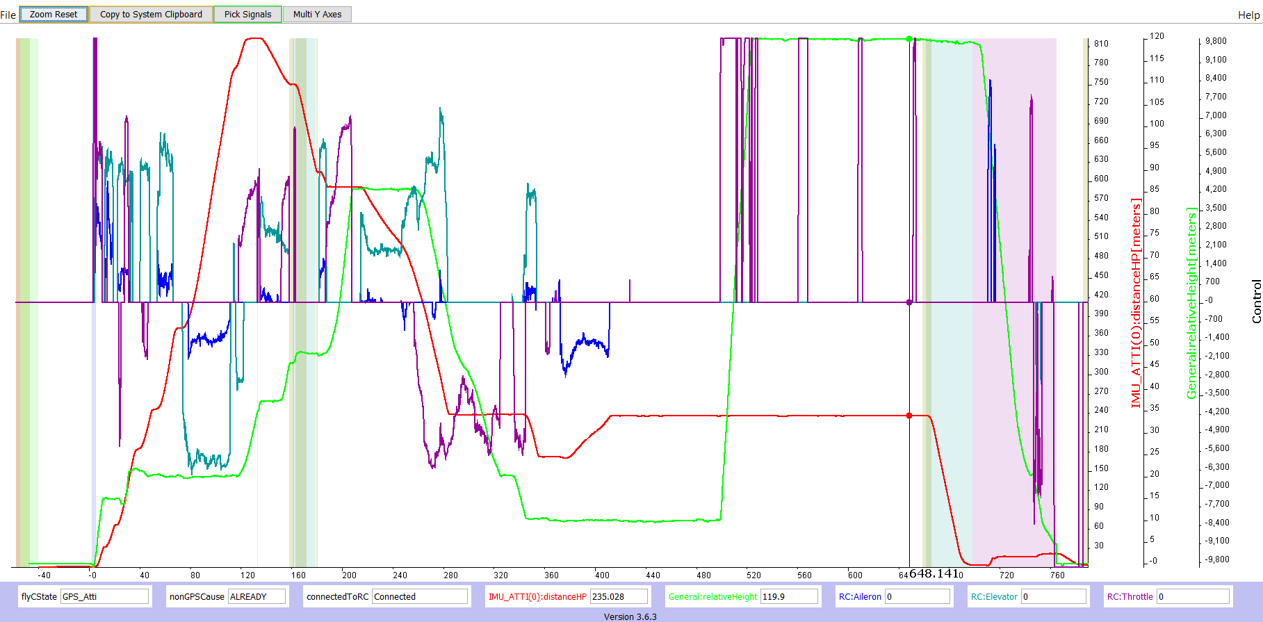

Not really sure what you are looking for here. But, FLY069 and FLY070 are not actual flights. FLY068 is a flight. A full relatively normal flight. There are a few disconnects which are not really unusual. RTH was initiated in the first one and cancelled by you. The second RTH occurred @235m out and 119m in altitude. For the most part the aircraft was connected to the RC for the majority of the flight. Did you check the RC when you lost visual from the app?

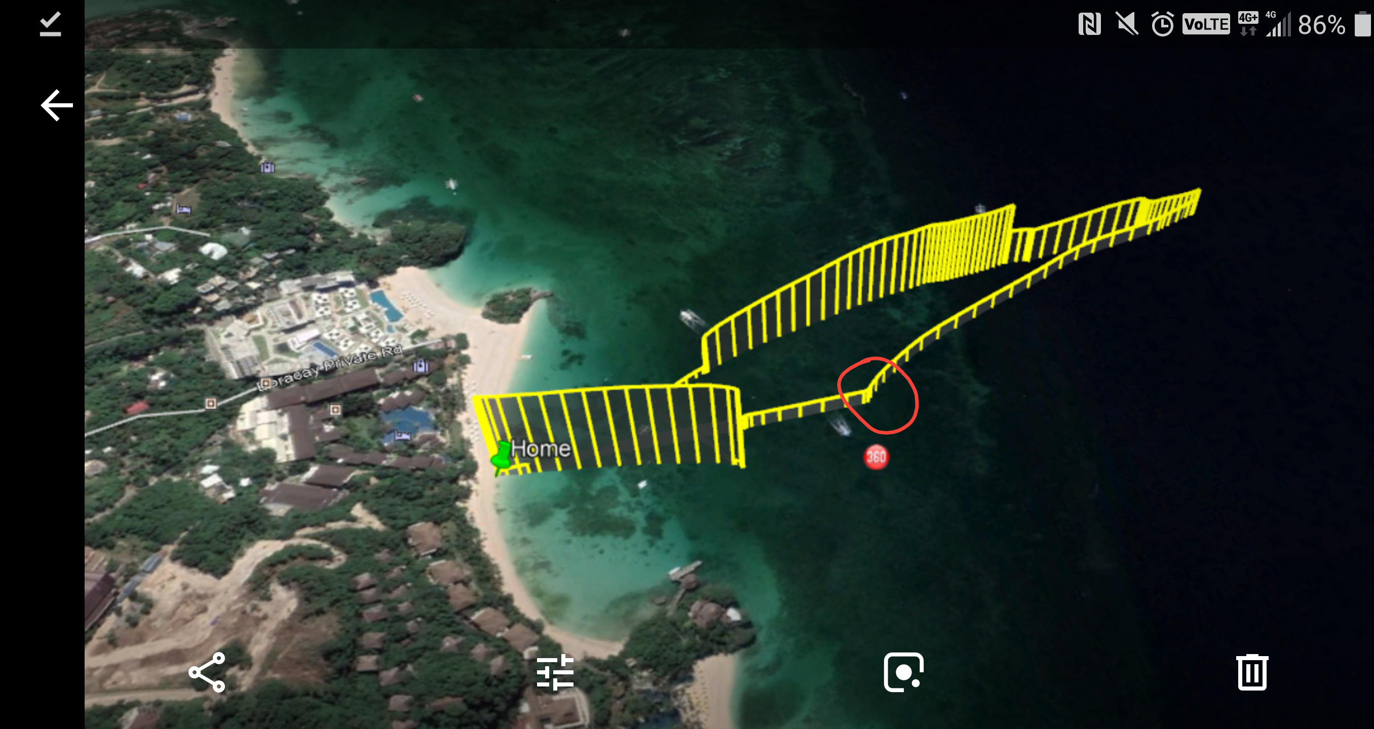

@flyguy_ Just to make sure we are on the same page. This is the FLY068 flight profile.
Reactions: Blade4 and Cavepig7
The red circle is where it disconnected and also lost wifi connection. Reset app didn't work. Turned wifi on and off to reconnect and didn't work. It seems off your chart to my moving the RC higher as I couldn't see it did work so there was still functionality just not ability to reconnect. When I switched off the RC it must have initiated an auto return to home. May be a case of just coincidence and needing to update RC firmware ?
