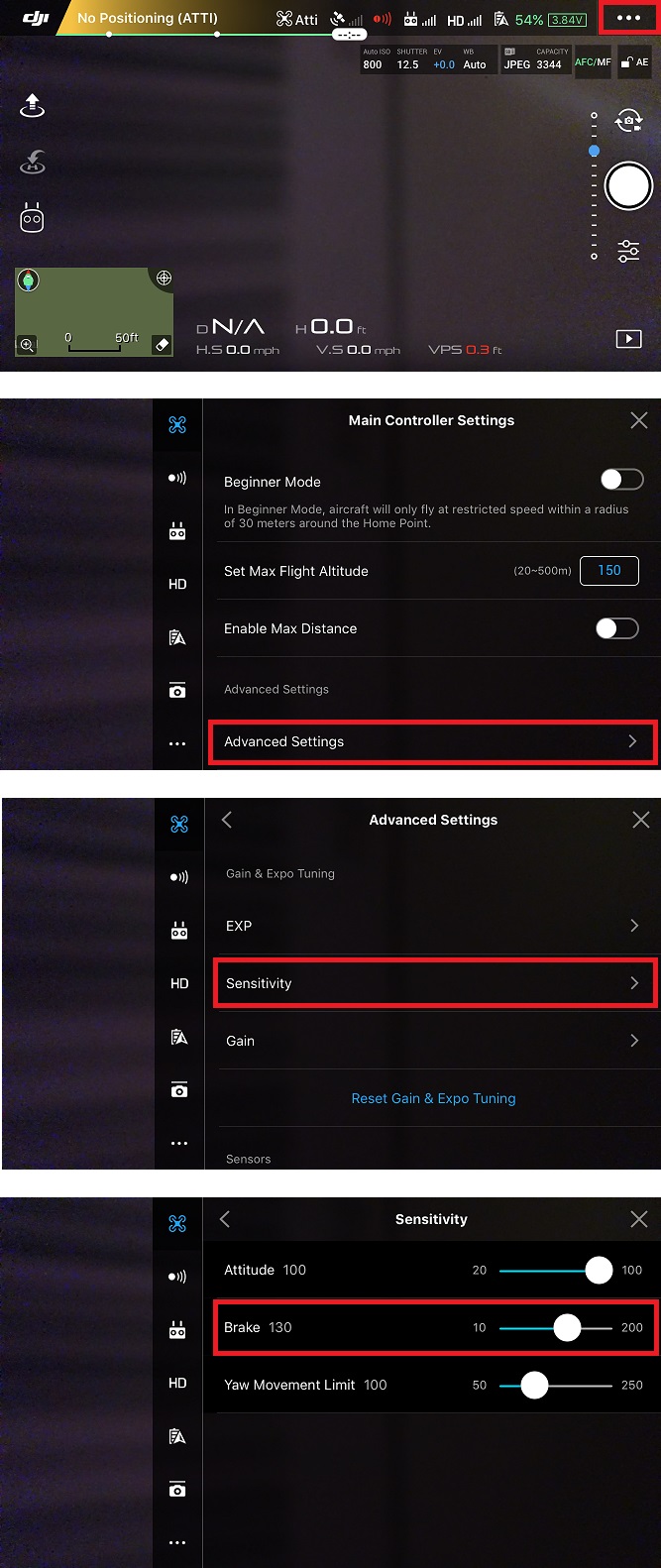

How much does it drift? Does it center around a point?
Did you try adjusting the brake setting in DJI GO?
Never heard of drifting 10-15'. Is this the breaking distance or movement around the final stop?
I can be heading in any direction, forward, reverse etc and when I return the right stick to the middle the Phantom drifts before stopping
1. Check that you have a normal setting for Exp
2. Increase the breaking
Reactions: Scott P4P
Quick update, it's now fixed.
I dialed in some similar exp, gain etc settings which I use on my Mavic and it did feel better. However, it was still drifting when descending.
I spoke to DJI and they asked me to do a IMU calibration and try again. Well, that fixed it.. the Phantom does drift at all
Quick update: The problem returned so I contacted support. DJI decided that the drone was faulty and the retailer gave me a replacement.
