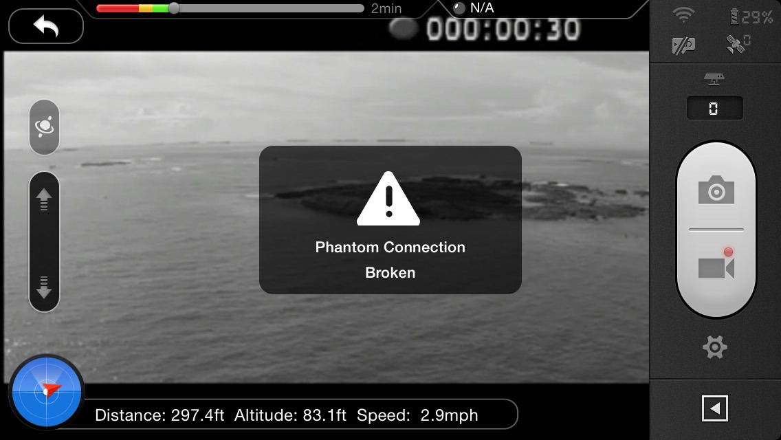

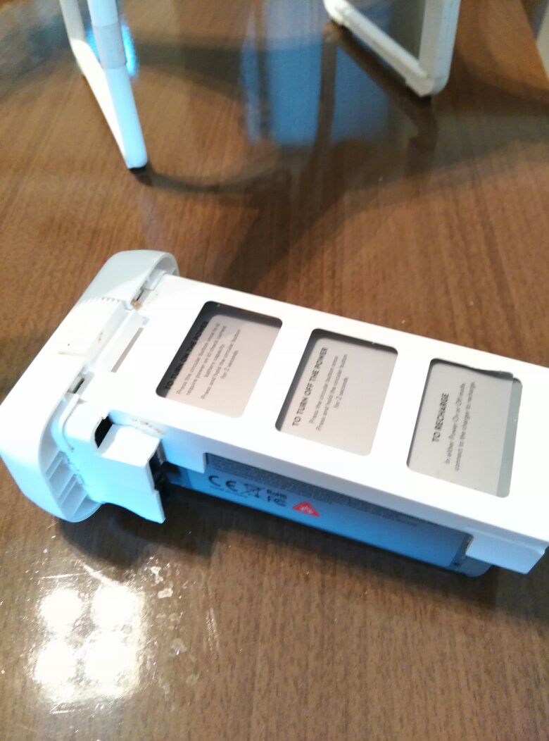

I am aeromodeller for many years. I bought my Phantom Vision + on Amazon. When we arrived, made several flights and it was working properly.
The problem happened about 15 days after purchase:

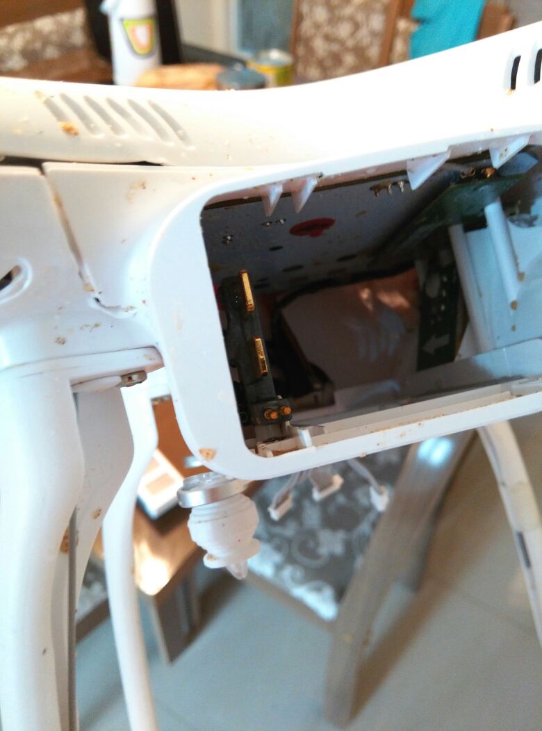

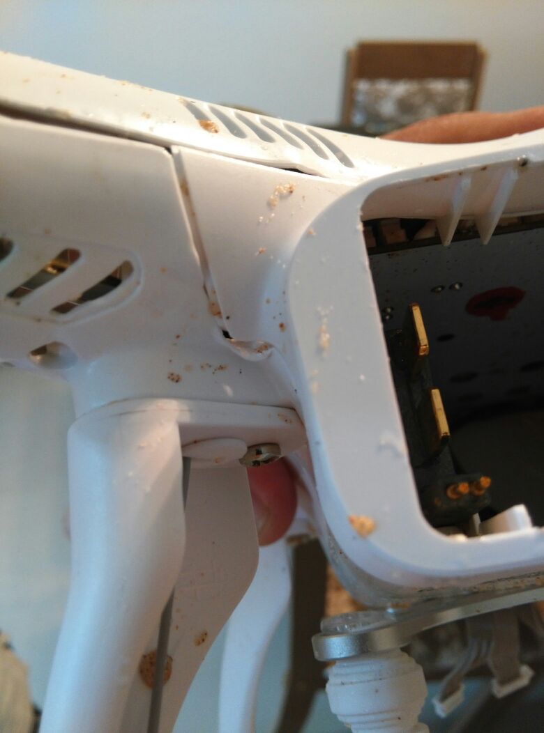

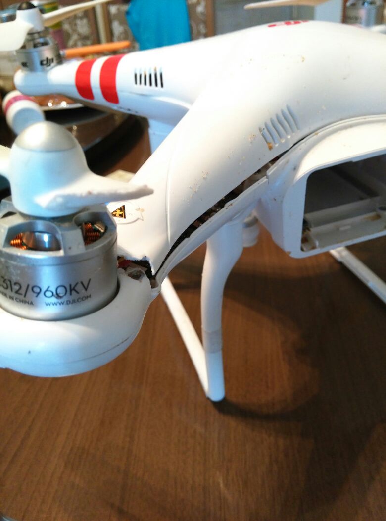

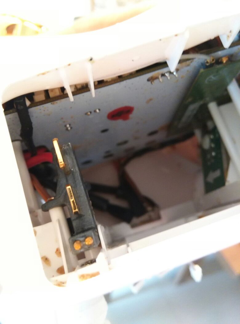

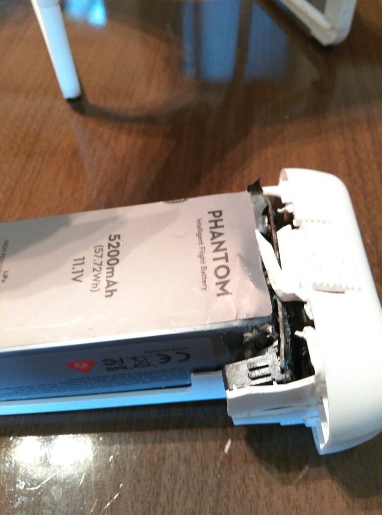

I did some pictures and was recording the video When suddenly the propellers of the Phantom stopped spinning and he fell on the beach! The feeling I had is the if the battery had Been disconnected! I managed to get it back, but he sank into the salt water. The battery, camera and gimbal Also are broken.
ABOVE, THE SCREEN OF MY PHONE AT THE MOMENT OF THE FALL - THE OTHERS PICTURES I MAKE BEFORE THE PHANTOM FALL. THE SD CARD DONT DAMAGED!
View attachment 16789 View attachment 16790 View attachment 16791 View attachment 16792 View attachment 16793 View attachment 16794 View attachment 16795
I made the complaint with the DJI and they told me that they would "share my injury" with me and give me 30% discount on the purchase of new Vision +! This is absurd!
I chose the DJI by the "reliability" of the products ... I have many witnesses to what happened ... I answered a questionnaire GIANT they sent me, but after selling them is horrible!

I found other battery cases rebooting during the flight ...

What happened to me was like this video ... the battery disconnected in flight ... only this, the guy was wearing a GoPro, then the camera remained recording during the fall ...
The battery reboot.
The battery didn't fail as the lights are visible in the video after the malfunction. It looks like it tried to 'right' itself once or twice on the way down.
