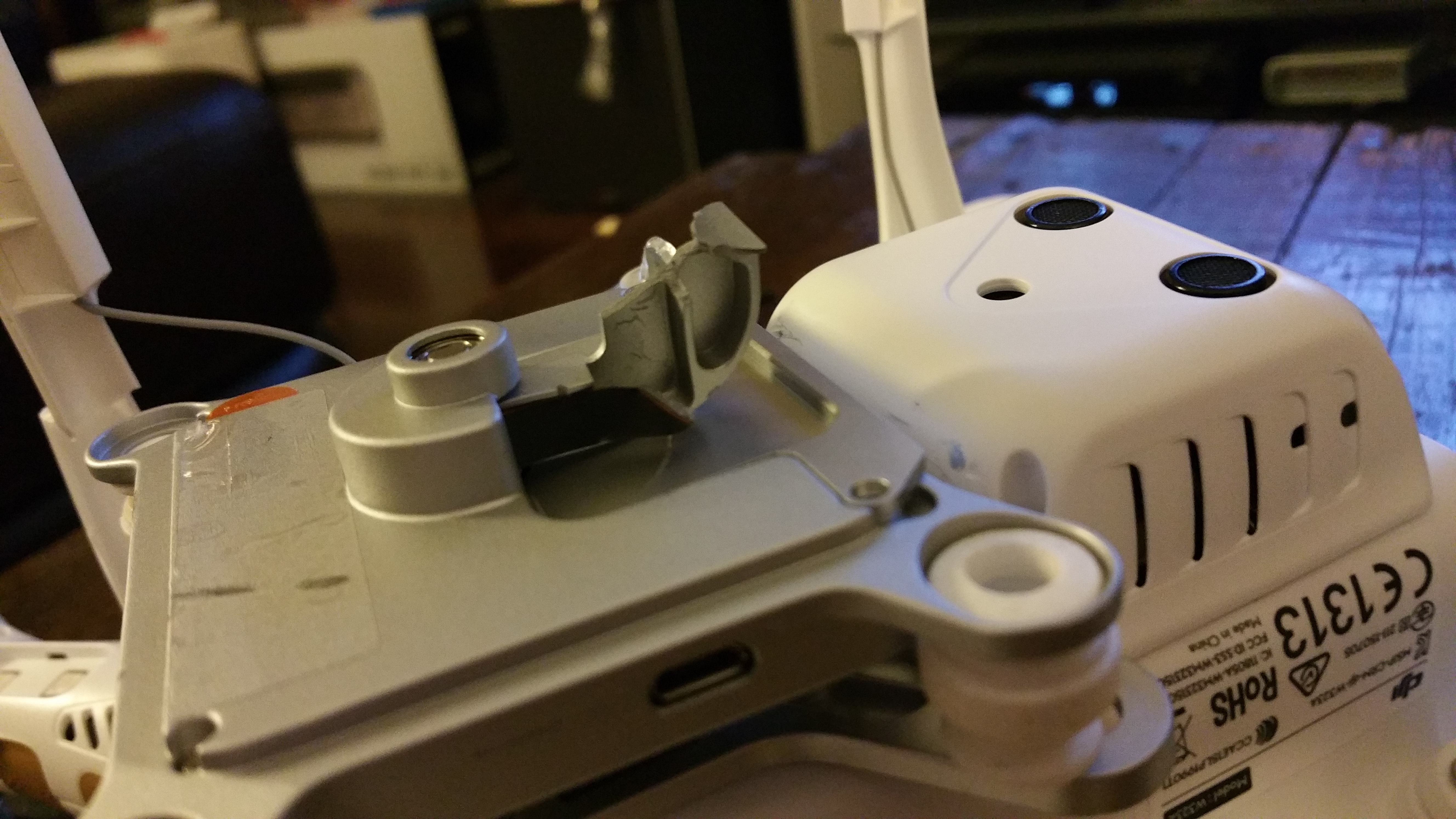

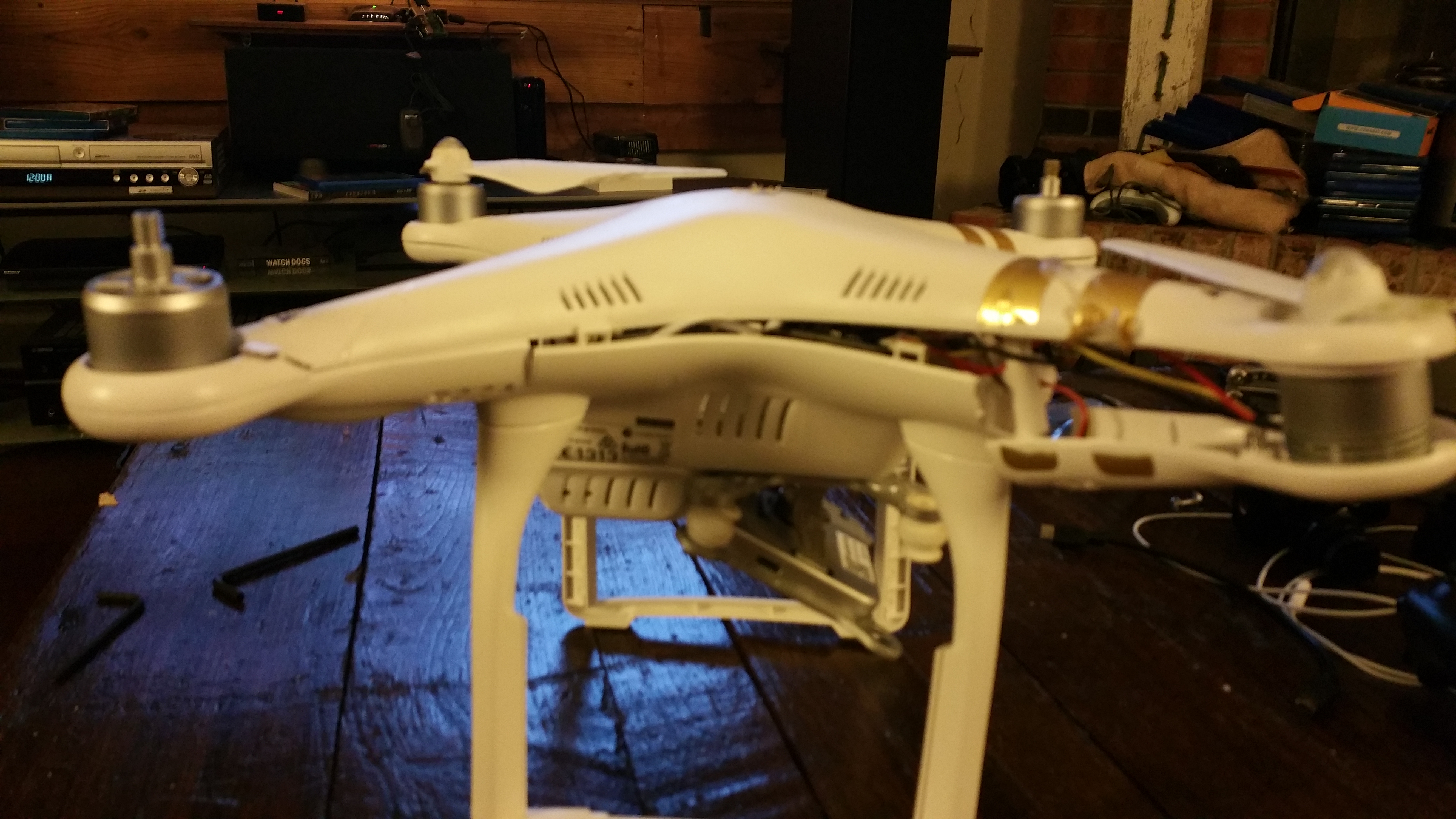

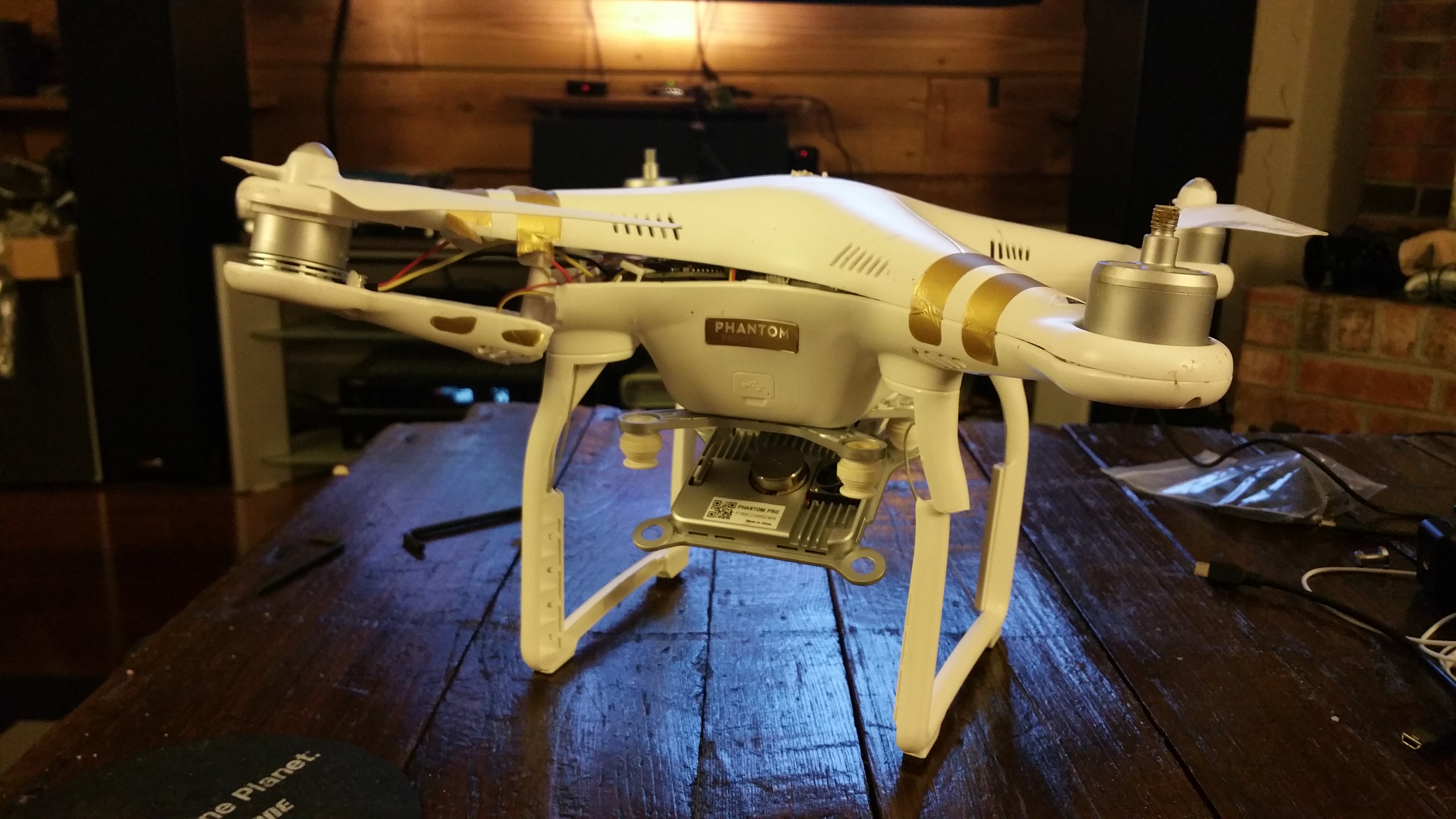

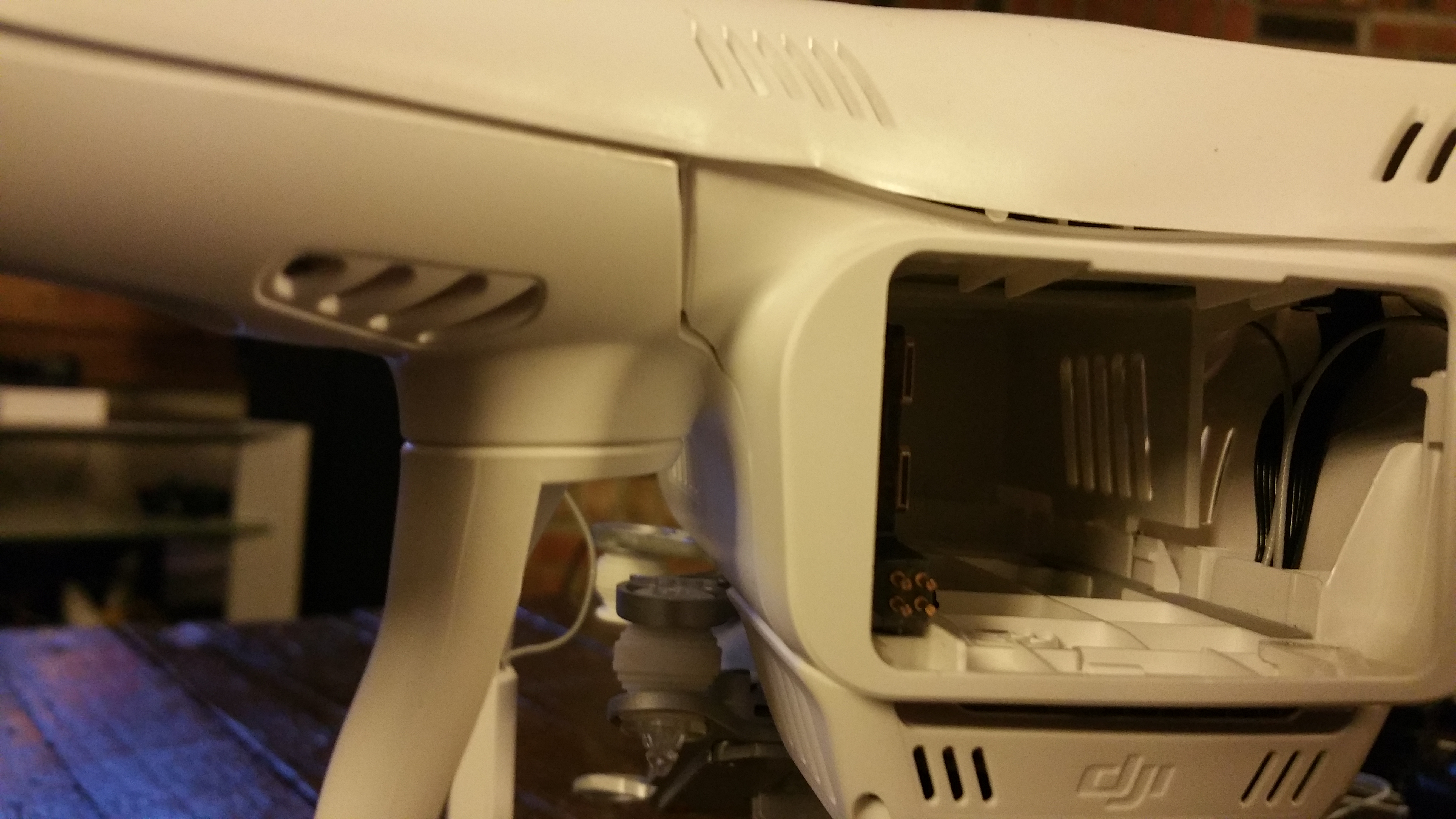

The drone is completely busted. Two arms are broken, one side of the landing gear is broken. The drone has split at the seam and a PCB card is popping out with some cables. The body has crease damage. AND the camera/gimbal completely snapped off. The base with the memory card was still barely attached, but the the camera rig snapped off just below that. I was unable to locate the camera or gimbal.
