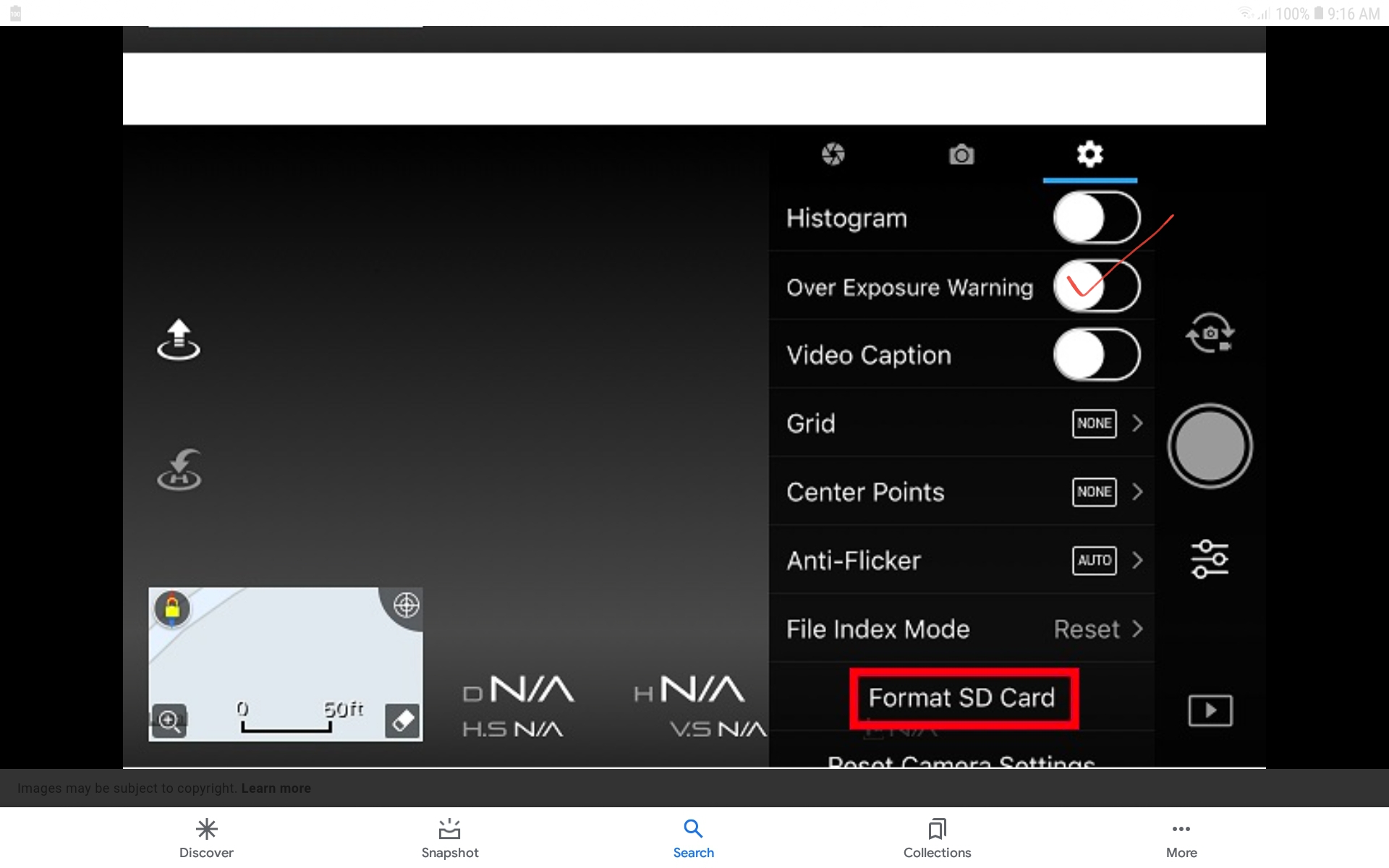

Have look in cam settings to make sure over exposure setting off,,,also try just hold drone while recording and go through different cam settings to see if comes good
Yup I tried exactly this and if I could have sent the recording, you would see where I was hovering for some moments going through different settings but nothing worked. I do not think it is the video settings and the firmware is 1.11.30 which is the latest.

Um to me that's some sort of over exposure since you got zebra lines,,is your over exposure switch off,
As said, definitely some over exposure there but also the constant movement top to bottom is a bit strange.
What settings have you got when you click on the three little bars to the right of "Anti Flicker"? I just found that the EV on my P3A was set to -1.7, making my videos very dark!!
