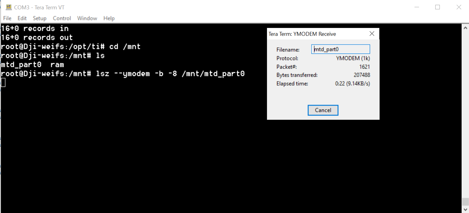

For the transfer - do 'lsz --help', look at the options. Try some.
You did tried to ctrl+c the tranfser and retry, right?

it will take a while...
@quaddamage, taking into consideration that my board starts once in a few times, do you think it will be necessary to dump it more than once?
ok, just to clarify.
the way I got to the prompter was using Ctrl+C - not killing the encode and server processes.
I am just finished with first part, so I will be 30 minutes of a loss.

Note that you don't need to reboot after each part. Just use 'rm' (carefully!) to remove the mtd_part0, and go with next one.
I mean, unless the board is dangerously hot or something.
