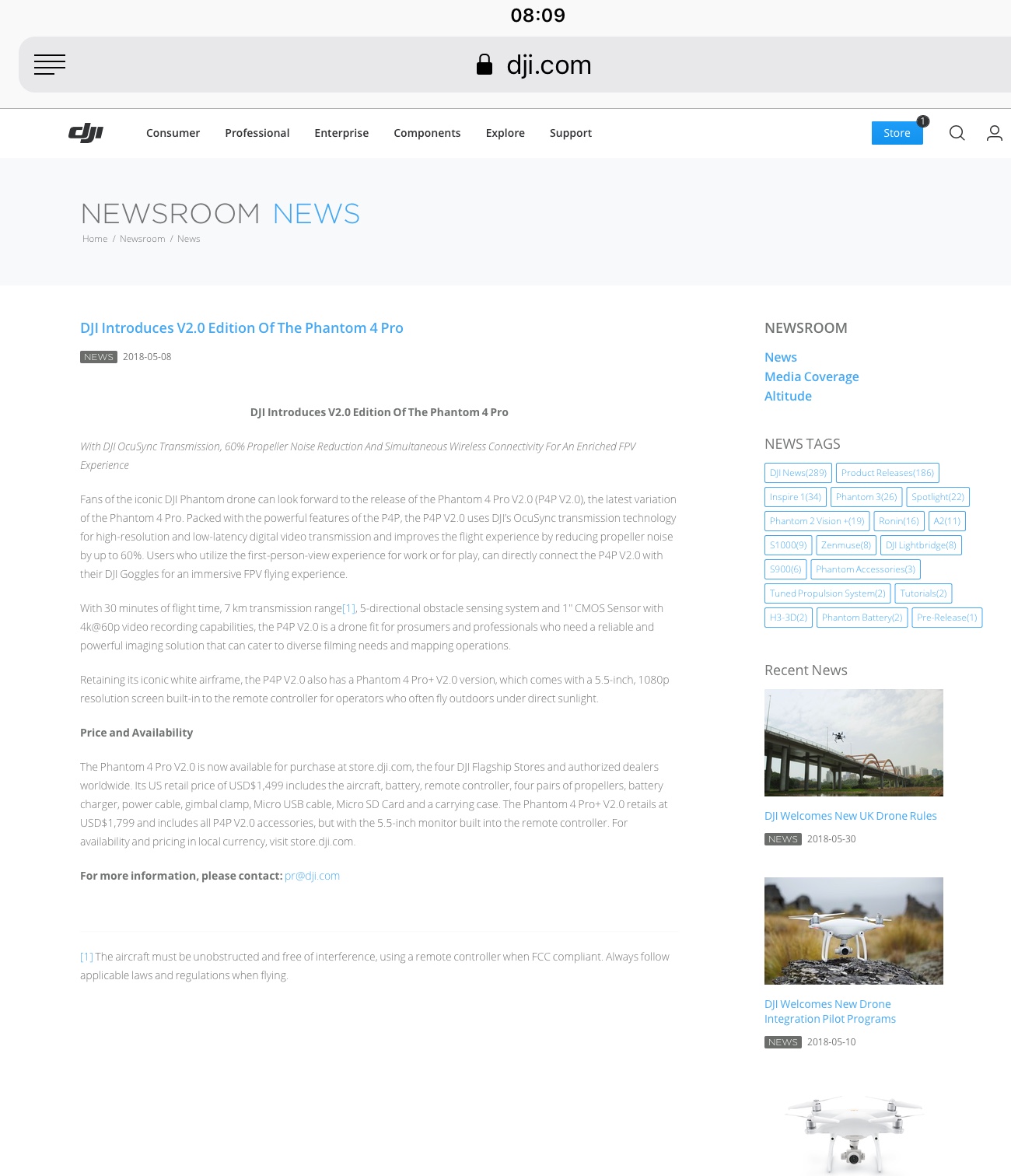

Yes that’s me and I based my purchase on the attched DJI news release ....very annoyed

The DJI press release said DJI Goggles not just the RE , this is called lying to your customers with false and misleading statements! Not good huh ?
I don't think anyone is disagreeing with you here. Certainly a contributing factor in my decision to purchase the V2 on release was for this marketing statement.
