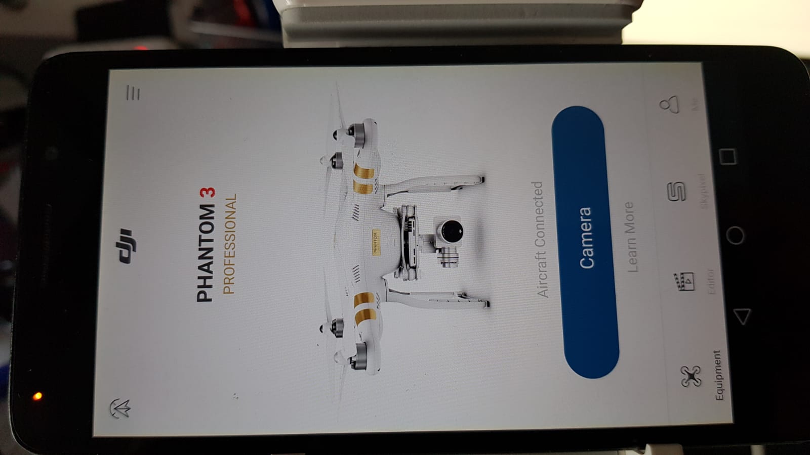

Hola a todos.
Tenia el P3A guardado y ahora que lo sacado la aplicación DJI Go me lo detecta como PRO y aunque puedo entrar en la aplicación la cámara no se ve.
UNAlguien sabe qué pasa? Está actualizado.

For the app I have used Samsung S8 and another phone, Honor 6. With the last I dindn´t have problems.
But now DJI Go only say that I have P3P.

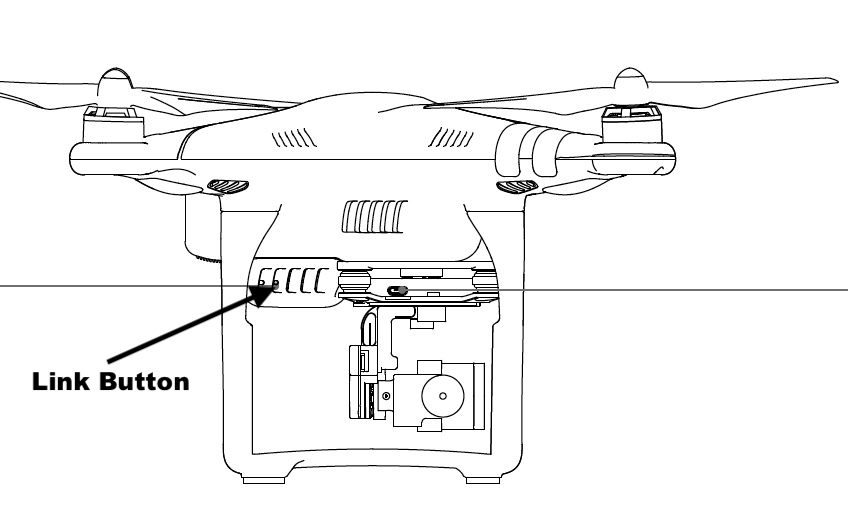

Do a "RESET" of the RC and then RE LINK the AC to the RC.
R/C RESET:
Turn ON the RC (not the AC)
Press and hold the C1 & C2 buttons and the camera shutter button - keep them pressed
Turn OFF the RC and then turn it back ON and then let go of the C1, C2 and SHUTTER bottons.
RELINK the RC/AC
Turn ON the AC and the RC
Press the LINK BUTTON - it will blink RED
Press C!, C2 and the video record button - the RC will BEEP.
LET GO all the buttons and PRESS the R/H wheel the RC - (Camera Settings) - the first light on the RC will turn BLUE and the RC will beep DDD
The RC will stop beeping and the Link Light on the AC will turn GHREEN if the link was successful.

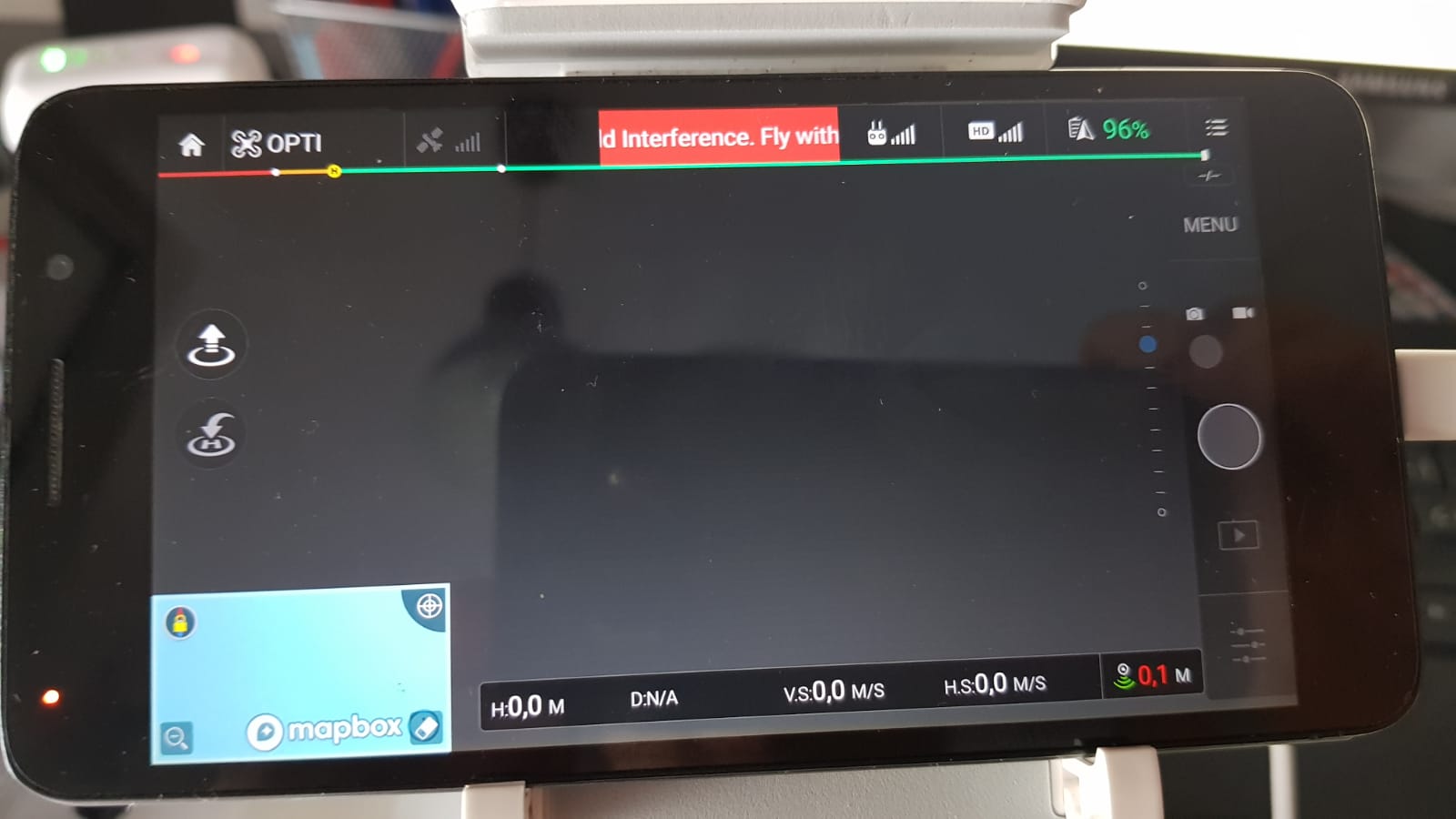

When you are in the app and it is showing that it is a P3P, below that it should have a tab that says connect. Is that tab blue in color or grey?
Jun 1, 2020
8
43
When I put on the AC and the RC and I connect the phone, the tab is blue. I´ve take pictures.

Well, my advice to you would be to reinstall firmware for P3A. The DJI GO app is seeing your drone as a P3P.
Try turning on just the remote controller only, and see if you can change it to P3A, then turn on the aircraft.
