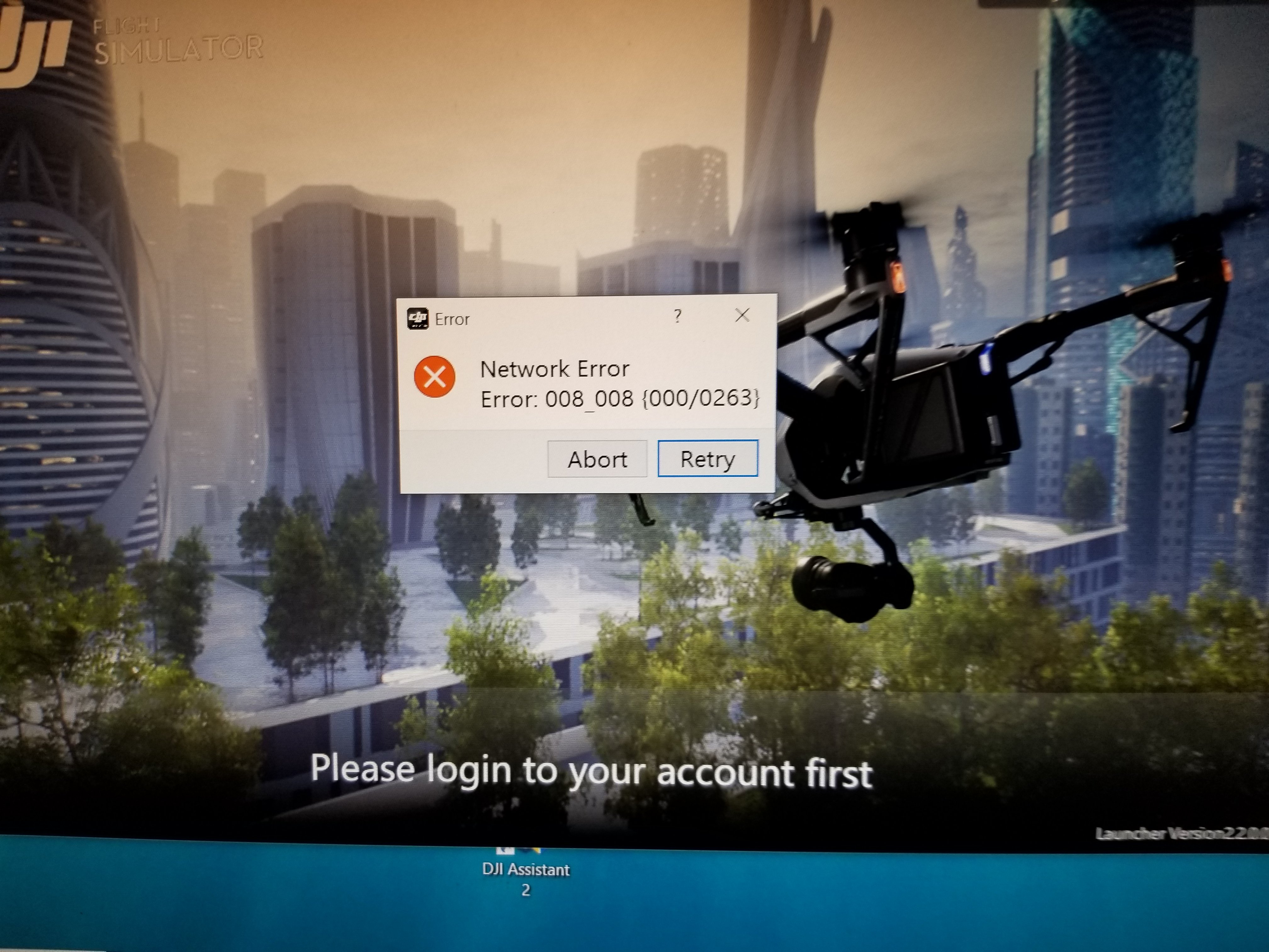

New Guy I need some Stick Time that isn't to dangerous, (Had a couple of close calls)
I cannot get to the DJI GO app Flight simulator. I have the most recent downloaded version and followed an old YT video But I can not find the help option they speak of.
I have the system connected and ready to fly (NO PROPS) as instructed.
I also have tried the Trial version of the DJI Website Flight Simulator But I continuously get a Network Error in the Pic below.
I have uninstalled rebooted and reinstalled and have upgraded Netframework (Microsoft) and repeated the Process.
I also tried Different ISPs, WIFIs and Direct Connection.
I was hoping someone might have had a similar experience.
I was hoping someone might have had a similar experience.View attachment 116549

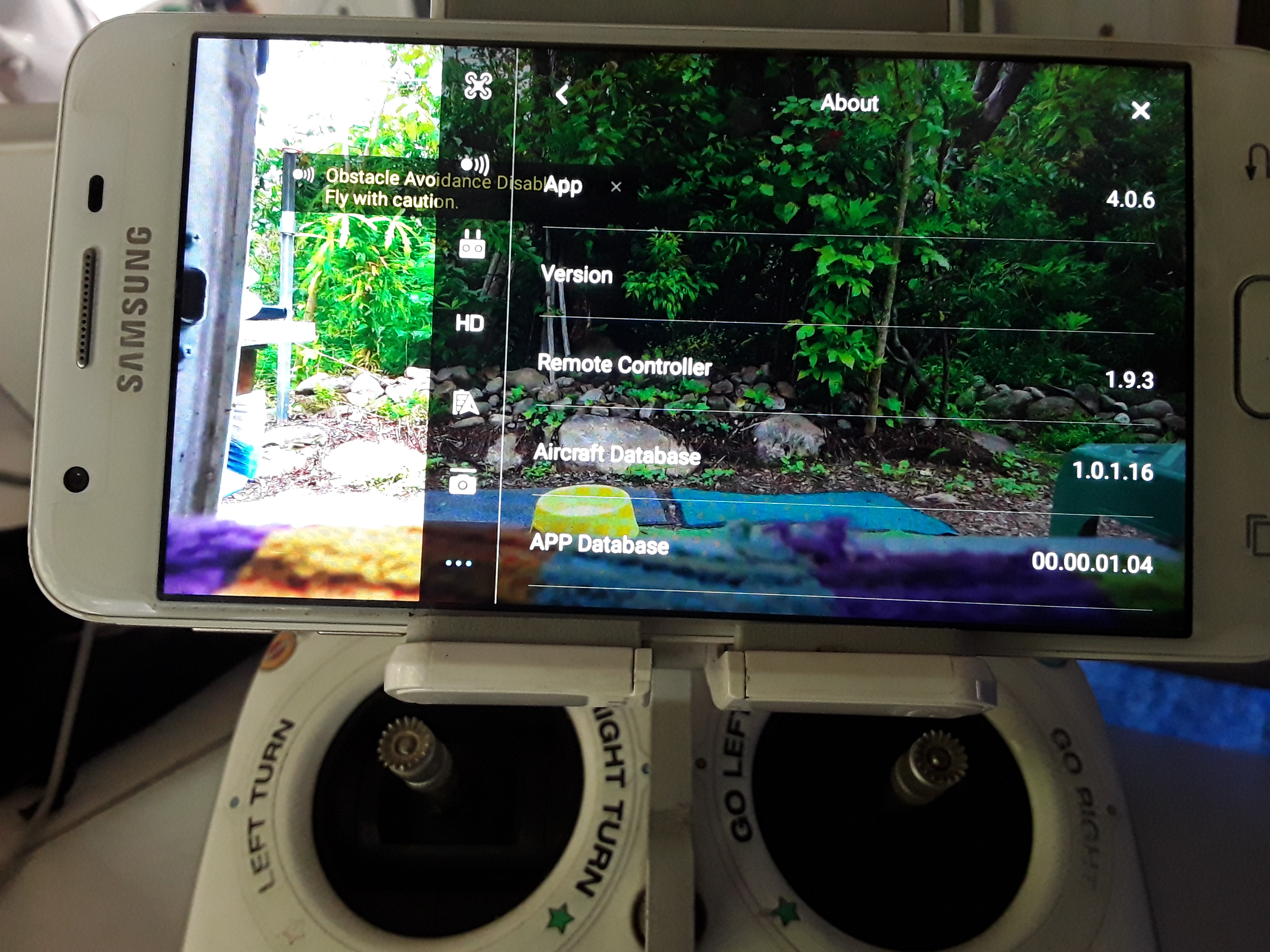

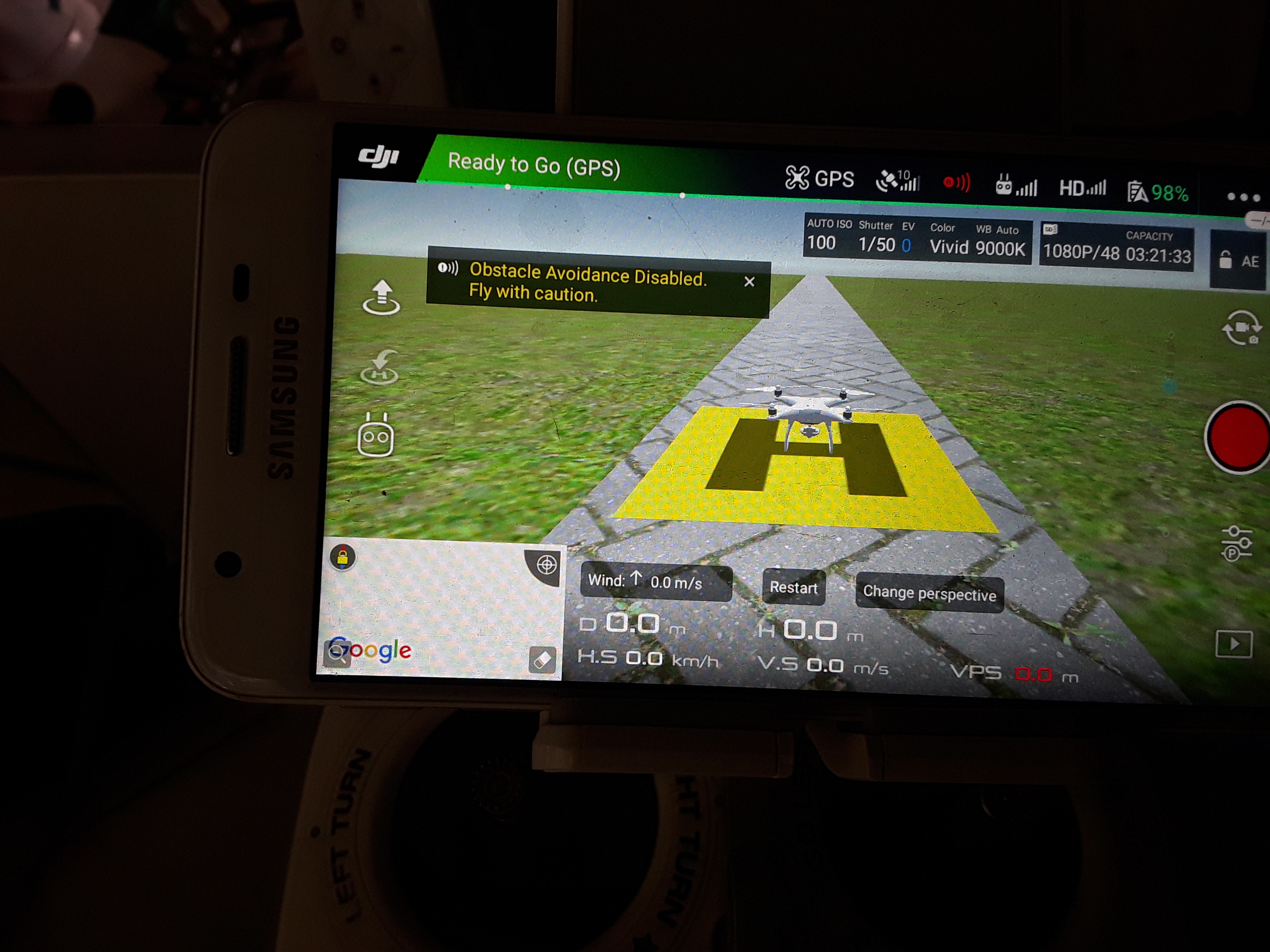

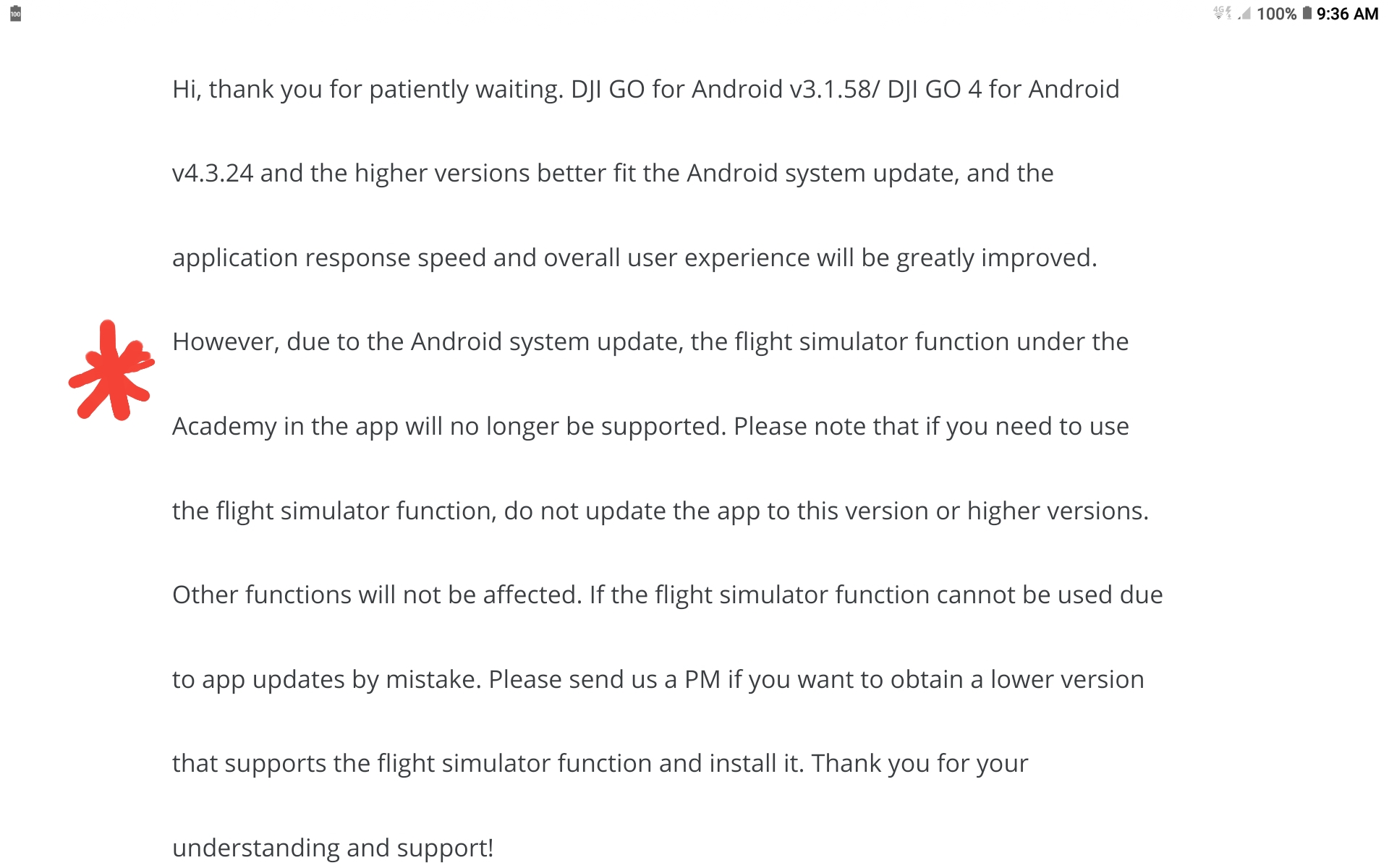

This might answer ,,its no longer available for most phantoms unless on old firmware
Me test with old version and sim works so updating you will lose it,,its good I looked cause I thought I had lost it but old device with no update it works good
............this is my p4s .........
