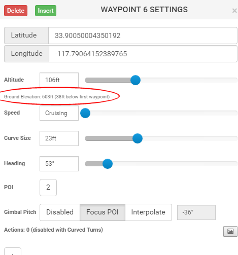

    John, Admittedly I don't use Mission Hub much (except to import AGL-calculated routes from Google Earth). In the little I've used MH, I've never seen any elevation information included or the relationships of waypoint elevations to the first waypoint you set. I've only seen the distances between waypoints displayed. Waypoint ASL or calculated AGL information based on home point would be a priceless feature. I could then avoid using Google Earth for this purpose. Can you please tell me how I get to these features in MH? Thanks.
  13. John Locke
    Jun 26, 2015
    4,405
    1,787
    Yorba Linda, CA
    In the MISSION HUB, when you setup your route you will see this data, as shown below. When you click and drag each waypoint around you will these numbers change, assuming the ground isn't perfectly flat. It's very cool, one of the best features of Litchi.

    I never even noticed that info before. Thanks for the great tip! That IS very cool.
