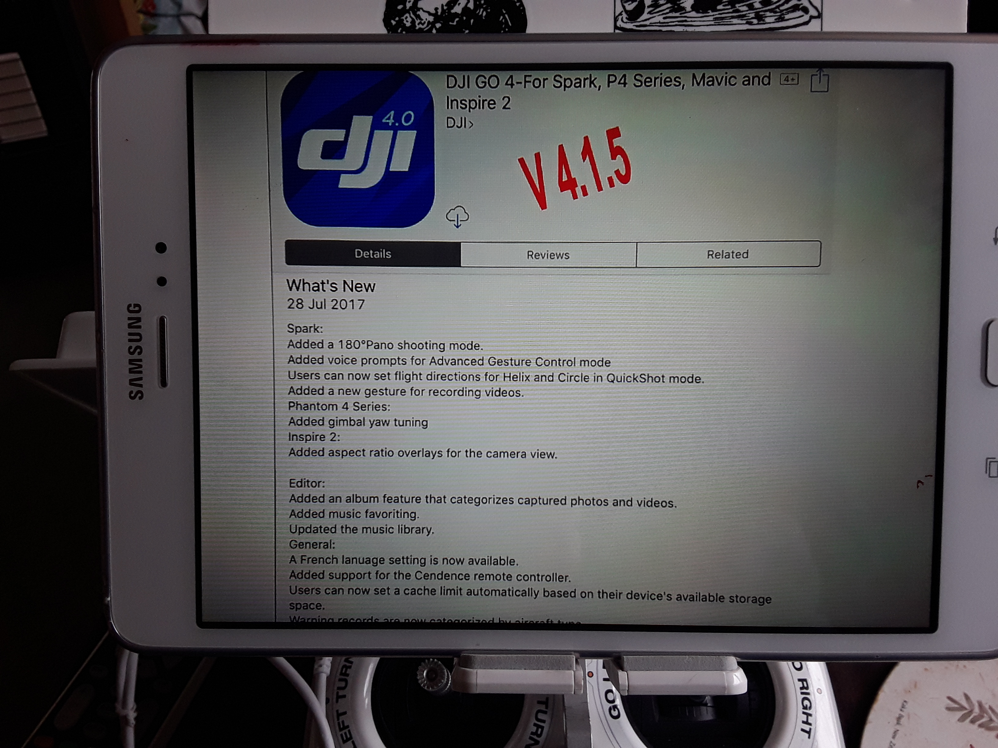

I decided to update to the latest version thinking I would get 4.1.4 but instead I got Version 4.1.5.
The first thing I noticed was that The RTH altitude range offered is only 20-50 Metres.
As most of us will need higher than that in the course of our flying, what's going on?
Anyone else noticed this? Is there something I have overlooked?
I wish now I had stayed with my original version but it doesn't seem to be an option.
Any suggestions?

Thank you. Your post made me think that maybe I should plug in and connect the aircraft and RC and look again.
As soon as that was done the RTH altitude limitation changed back to where it was with the original DJI GO 4, i.e. 20-500 Metres.
In fact, even if the AC was switched off the old figures remained. However, if the RC is switched off the RTH limitation returned to 50M.
It's all very odd but at least it appears OK once the RC is plugged in.
Sorry if I've confused anyone but I hope the above will save others wondering WTH when they switch over first time to 4.1.5

Think you've nailed the issue, your AC/RC needs to be turned on for previous settings to be viewed and saved, although it pays to check your critical settings in case the app has defaulted to essentially beginner mode.
I burned a battery this afternoon and everything is fine, although a message popped up notifying me that my RTH path will cross into a NFZ, weird since I live in the wilderness...
