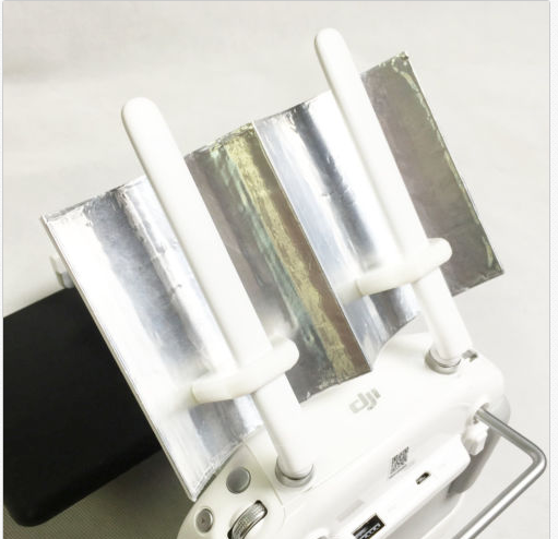

Everyone has their preference. I have daves design, but can see how someone may prefer the Hong Kong sellers design given the added adjustability in angle while in flight. Not sure I need or want this...
I agree I do prefer the fact you can tilt the antennas up and down with the other guys design. You may not always hold your remote the same way and that added flexibility would be a nice addition.

I seriously doubt you could tell the difference between copper and aluminum. Getting a more perfect parabula and better placement of the antenna at the focus of the parabula would make more difference than anything else we could do. Radio waves are so big compared to optical waves the density of copper over aluminum is irrelevant as far as reflection. Look at what radio telescopes use (steel mesh), or commercial boosters (a steel grid).
Want to know how good your booster is? Point a laser straight at it and see where the dot ends up. If it lights up the antenna then you are in business. If it goes anyplace else you may as well have a flat plate behind the antenna as the curve is not focusing it properly. Without proper focus it would be like using a pair of binoculars way out of focus. You would be better not using them at all.

I modified the original boosters to extend the full length of the antennas like Daves, and the other commercial ones. I made the parabolic surface out of a plastic jug and then used the parabolic outlines to push the circular shape into the needed parabolic shape. I used aluminum tape to cover both the inside and outside of the booster for maximum reflectivity. I made sure the inside surface was as smooth as possible. I then tested the shape of my antenna boosters with a laser to make sure that no matter where the beam hit, it would reflect to the antenna just as a parabola should.
With my original booster, like the one shown from the original poster of this thread, I got 15,100 feet distance from a nearly ideal location where I was about 200 feet above a river valley giving me clean line of sight for 20 miles. This time I got 16,242 feet from a very flat area next to high voltage power lines where I could not have clean line of sight.
The limit of my distance now is safe battery life. 5km out and back is about as much as is possible without really pushing the battery past the low battery warning.
