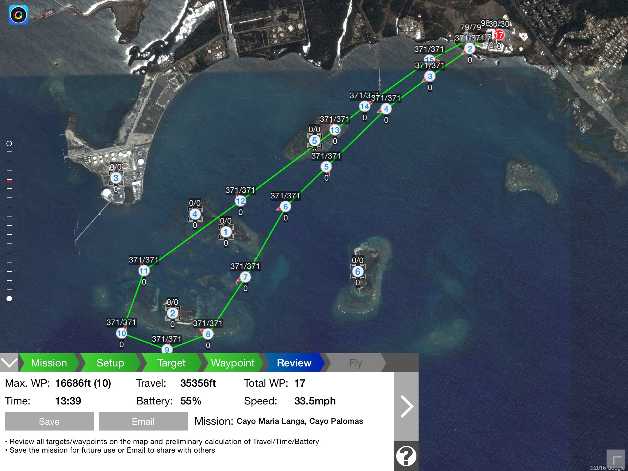

    image.jpg View attachment 62312 image.jpg I get my best "fuel" efficiency using FPV Camara at around 33mph.
    I can make mission models beforehand at different speeds and the App tells me the approximate "fuel" consumptions

    I regularly run missions of 37,000-38,000' @ 30 mph and return with 30% battery remaining. Wind speed & direction can have a significant impact on the battery. My flights are usually in winds of 8 mph or less. Yesterday I ran a mission in 11 mph winds & returned with 25%. If you are heading directly into the wind on the long leg out or in expect less efficiency, especially over open water with unobstructed & potentially gusty winds.
    I think the sweet spot for efficiency in in the 24-28 mph range. I do not recommend running your mission at the max of 33.6 mph. This will likely result in terrible efficiency since you'll be running hammer down the entire flight trying to hit that mark. BTW Litchi estimated flight times are usually on the high side. Missions Litchi estimates @ 19 minutes generally complete in 16.
    Also should mention you'll probably have to disable Smart-RTH to complete a 35,000' mission unless you are just flying at a constant altitude. The flight computer is conservative & engages early. If you disable the bird will fly until the battery reaches 10% then auto-land engages. You can override with the sticks if you are in RC range.
