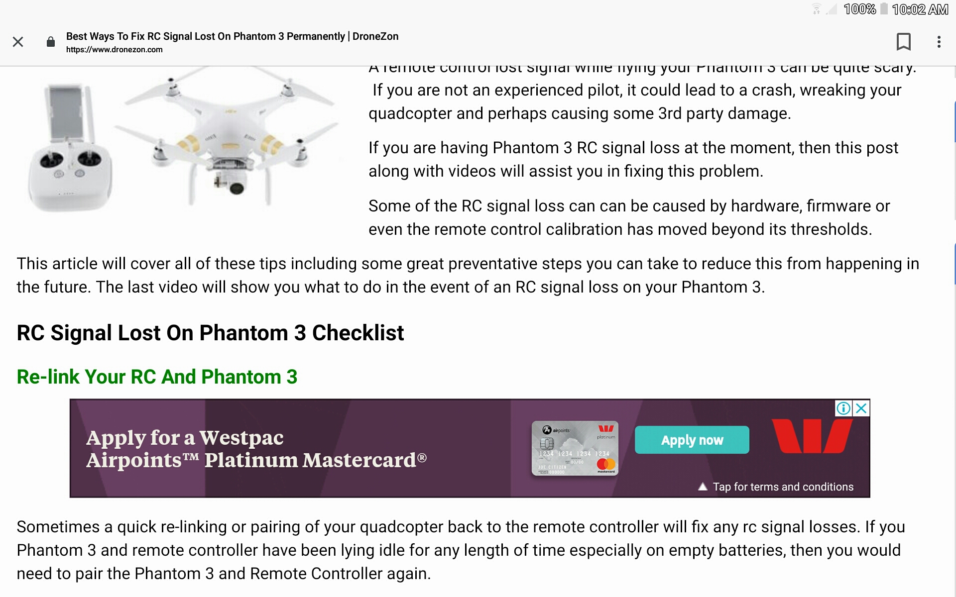

Try this manual link without device,,,bit more discription help,,what colour gimble light ?remote light nice and green ,?then try conect with app if it works so,,disconect and signal loss 2 different issues,,do you have control with remote during this time if so it still conected but transmission signal can be lost giving no picture but still can fly,,is this the case or do rth kick in
Try this manual link without device,,,bit more discription help,,what colour gimble light ?remote light nice and green ,?then try conect with app if it works so,,disconect and signal loss 2 different issues,,do you have control with remote during this time if so it still conected but transmission signal can be lost giving no picture but still can fly,,is this the case or do rth kick inView attachment 110853

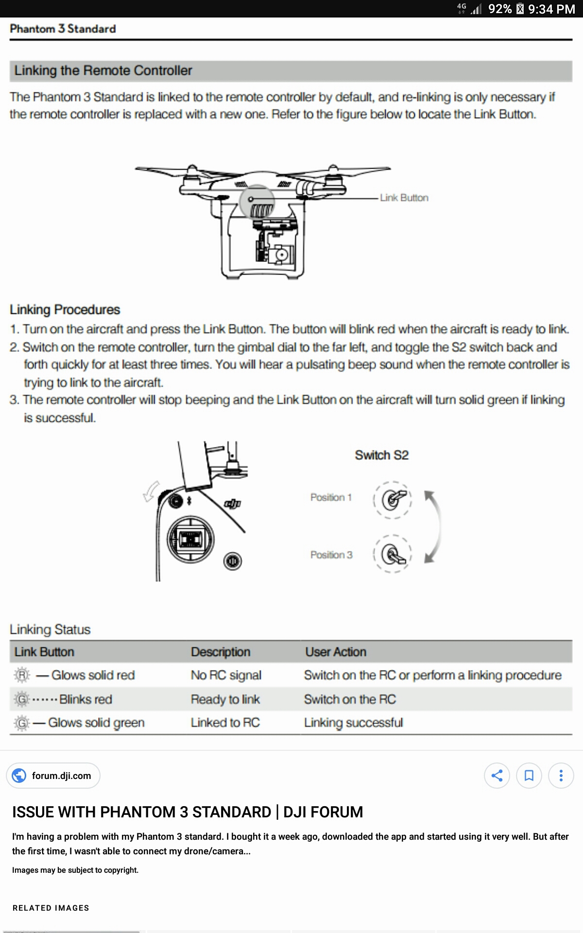

OK here how in case,if you do it in app make sure you change it in wifi settings to or it won't conect....this might give you better conection
And here another pic showing that it is recommended in some occasions ,,,I don't say it cause it sound good
And here another pic showing that it is recommended in some occasions ,,,I don't say it cause it sound goodView attachment 110872
