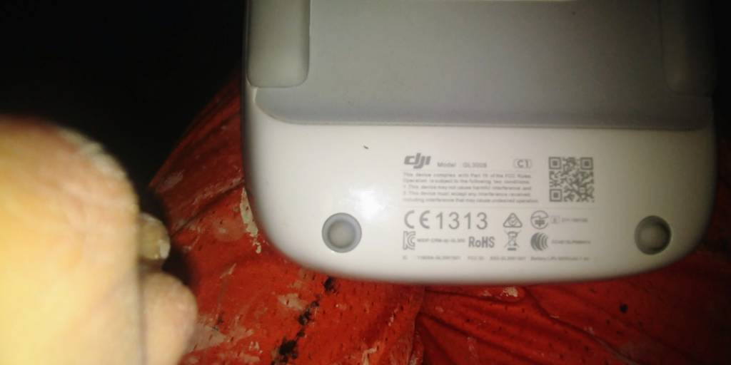

Is there some kind of big difference in the remote controlers, the 5 that I have for my phantoms all have CE 1313 ON THE BACK. Now I'm hearing that these don't have the range as one with I think they said a
CL 1313. The article said that the 1313 was used in Europe, could someone help me understand this, I the had a p3p and p3a since 2015 and a p4p since they came out and somehow mmm never heard of this
It doesn't matter where you buy your drone and controller, you get the same model and it will have the CE mark.
The drone identifies and uses the appropriate mode (FCC or CE) based on where you use the drone.
Having the CE mark just signifies that the controller has CE approval.

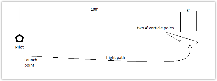

Yes, we have the same guideline in the US too, but it's often ignored. I'd crash my drone way more often flying VLOS all the time. A humans eyesight depth of field becomes progressively ineffective after about 100'.
To see how good you are with VLOS depth of field at 100', try the test below with some 4' sticks in the stuck in the ground, vertical. See if you can fly this route without using FPV. Fly between the sticks using only VLOS. Tip, before you go between the sticks, stop and check FPV to confirm. If you succeed at 100', try 200'. It's a fun exercise, one that makes you realize how valuable and accurate FPV is. Of course this doesn't make it best to use only FPV on all missions, but I use it 90% of the time during my flights, but that's me. I've only crashed once in 5yrs, and that was using VLOS about 150' away.
I know how difficult it is to judge the distance to an object. I have been flying model airplanes for 35 years. We often had a competition to hit a pole made of foam in a distance of 25m. It is very dificult to hit that pole.
